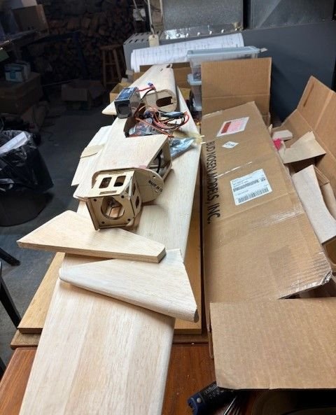

WEDJ 04-05-2024 09:33 AM
Sheeted the stab and 1/2 the rudder
https://cimg1.ibsrv.net/gimg/www.rcu...af40c0d7f3.jpg

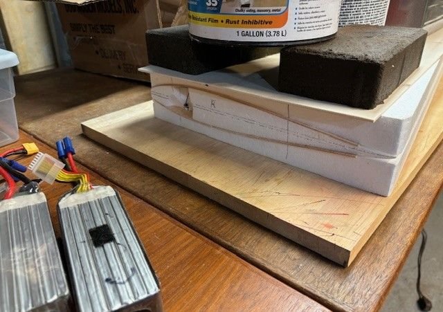

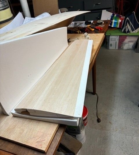

WEDJ 11-23-2024 11:49 AM
So I tried a new method to attach the wing skins. Saw it on YouTube. I used a small roller to apply a very thin coat of Gorilla glue. In the past, I would squeegee some 30- minute epoxy with a spackle blade. I weighed the foam and balsa before gluing, we'll see how much weight it adds.
https://cimg2.ibsrv.net/gimg/www.rcu...686d4e41de.jpg
WEDJ 11-25-2024 11:31 AM
So before gluing, the core and skin weighed 5 ounces. After gluing, 5 1/2 ounces. I'm pleased!
https://cimg4.ibsrv.net/gimg/www.rcu...9683b55980.jpg

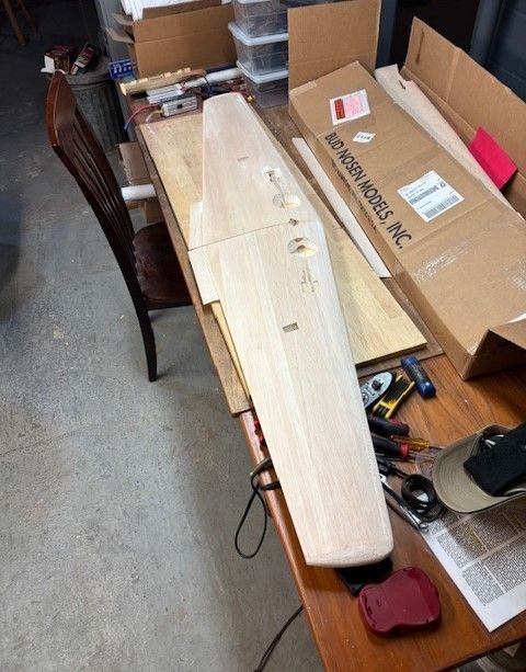

WEDJ 01-11-2025 07:30 AM
Both wings finished. Next step is to join them with f'glass tape.
https://cimg5.ibsrv.net/gimg/www.rcu...71de168fa6.jpg

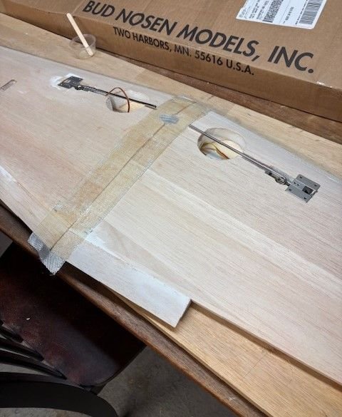

WEDJ 01-12-2025 03:31 AM
Wings joined with 8 oz fiberglass tape 3" wide applied with epoxy, and retracts test fitted.
https://cimg3.ibsrv.net/gimg/www.rcu...1e6fd6138a.jpg

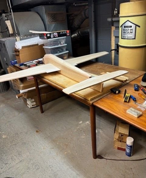

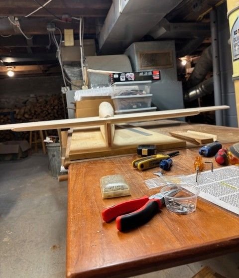

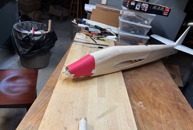

So with the wing attachment finished, it's time to add the horizontal stabilizer
https://cimg8.ibsrv.net/gimg/www.rcu...00e83e2a04.jpg
It has to be carefully aligned with the wing, as well as square to the body. I spent about 1/2 hour to get here:
https://cimg7.ibsrv.net/gimg/www.rcu...fe2d795d94.jpg

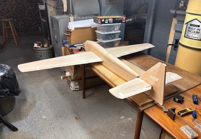

WEDJ 01-19-2025 07:04 AM
So here's all the pieces put together, control surfaces taped on. Looks pretty good, I think. Still have to do the cowling.
https://cimg5.ibsrv.net/gimg/www.rcu...c7002ef0a8.jpg
https://cimg6.ibsrv.net/gimg/www.rcu...d60c8798ca.jpg

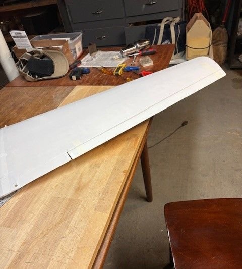

WEDJ 01-28-2025 03:53 AM
Big step forward - starting to cover the wing !
https://cimg9.ibsrv.net/gimg/www.rcu...3d91445986.jpg

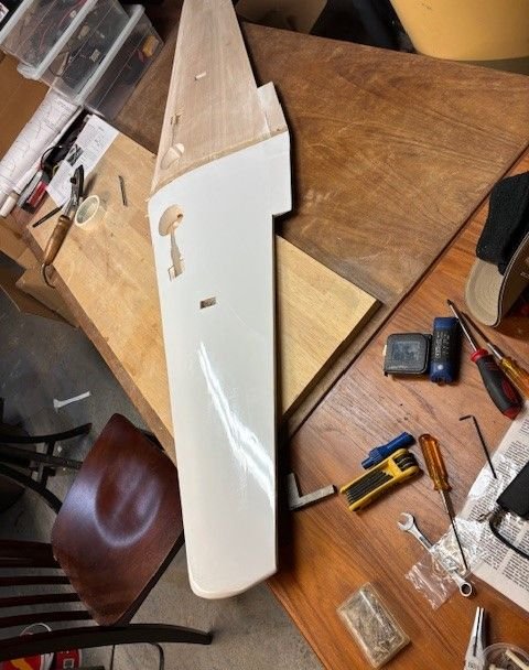

WEDJ 02-14-2025 03:45 AM
Wing now covered, time to install the ailerons. The end is in sight, but still a lot to do.
https://cimg9.ibsrv.net/gimg/www.rcu...a252e0d36f.jpg

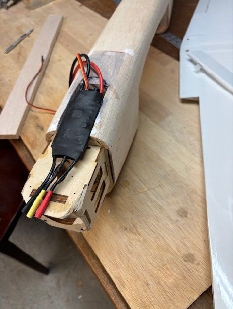

WEDJ 02-16-2025 01:06 PM
To fit the ESC, I had to make a cut out in the bottom of the fuselage.
https://cimg7.ibsrv.net/gimg/www.rcu...215d03c536.jpg
