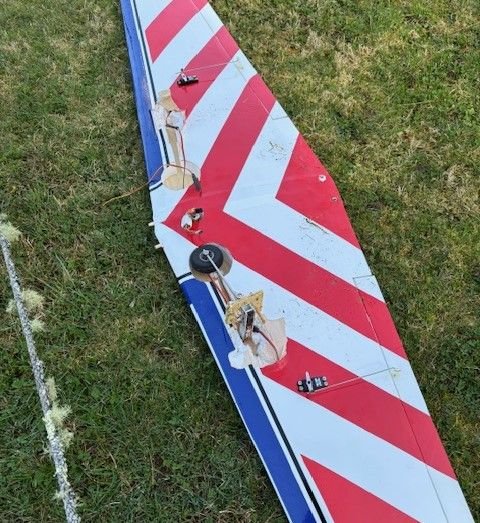

Yesterday was a great flying day. Temp in the 60's, very slight breeze, the runway had been rolled. So we took our maiden flight. Unfortunately, she was climbing, even at 1/2 throttle and full down trim. When I got home, I measured, and somehow managed to put the stab in wrong. There was a 1/2" difference from the LE to the TE. Going back to post #5, I can see that I mis-measured.
The more serious issue, however, is that the LG ripped out on landing. Major surgery to follow.....

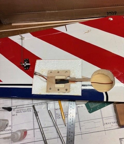

So after a month of licking my emotional wounds, and figuring out how to proceed, I started to re-build the landing gear. Bigger plywood plate, I will put 6 pcs 1/4" dowels thru the plate and all the way through the upper wing skin, then replace the balsa skin I cut out with more 1/16" balsa, but will be using epoxy to attach. Should be plenty strong.

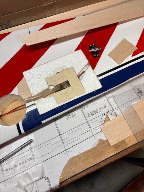

WEDJ 06-07-2025 03:45 AM
So here's 6 holes for 1/4" dowels

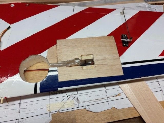

The dowels go all the way through the top skin and will be bonded to it.

WEDJ 06-09-2025 02:59 AM
Bottom sheeting attached with epoxy - plenty strong.

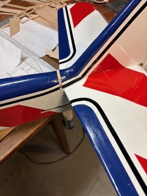

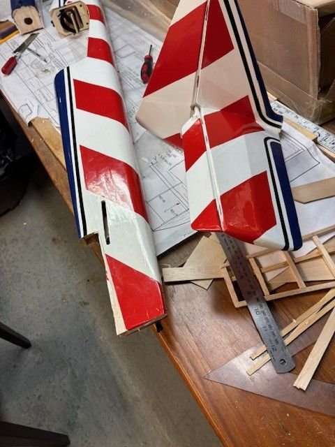

To correct the stab angle of incidence, I had to completely cut of the tail assembly - boy, did that hurt!
https://cimg6.ibsrv.net/gimg/www.rcu...d85b553dcc.jpg
WEDJ 06-09-2025 03:56 AM
The bare wood showing is where I will have to re-do the stab to zero incidence.
WEDJ 06-10-2025 11:14 AM
Tail feathers re-attached. Balsa wedge to fill the gap.
