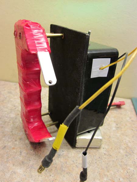

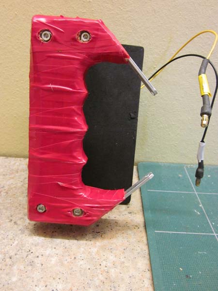

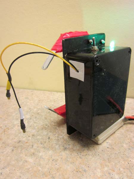

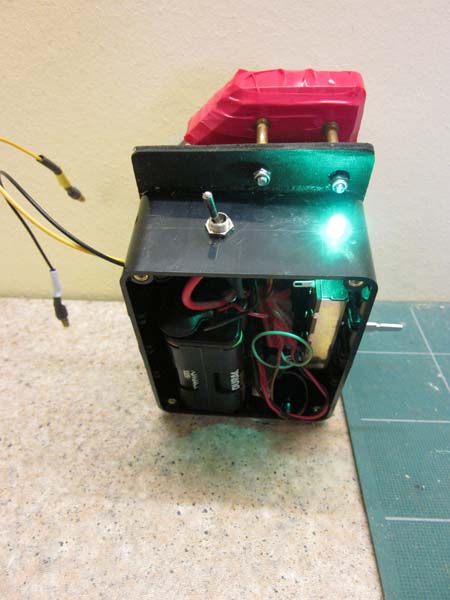

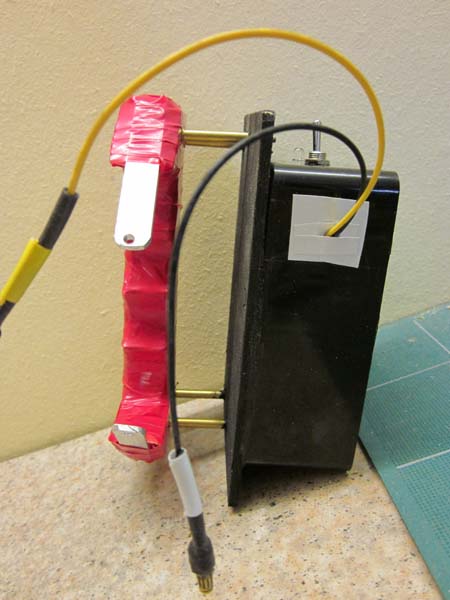

I have a U/Tronics Control system. In fact I just got it. Looks very well made.
I'll hook this bad boy to my CL handle and operate my throttle and rudder with a squeeze of the finger.
I did spend time researching the three line system, but progress did get the best of me.
Thank you U/Tronics!

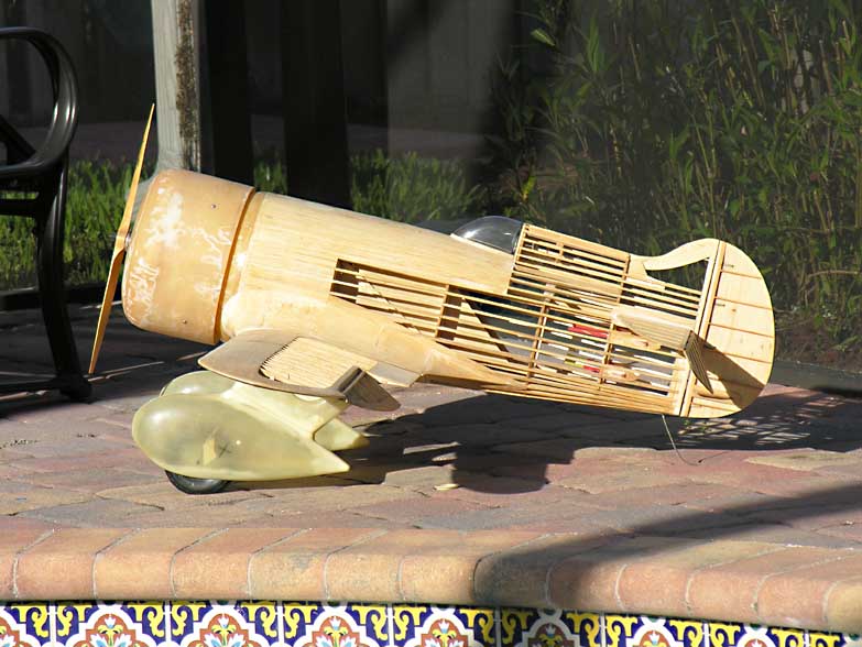

Here's the model you're working.

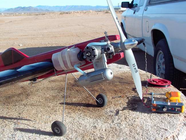

What are you guys using for the control lines??
I have made up lines from 80lb surflon 62ft long for my Shackleton, but I have found that the voltage drop is so large that the ESC's will not work.
I could use 120lb surflon but would be worried about the extra drag
#55
I doubt if the problem is 'voltage drop' as there would not be any current requirement (it would average a couple of milliamps). I suppose if the lines are extremely high resistance (like >100kohm), there would be a loss of voltage, but if they are some type of steel, that should not be the case.
Several people in the US are using the Clancy unit to power electric powered control-line models with the signal sent down the lines, and there should not be much difference between Clancy's U-Tronics and the handle you have, at least as far as it's ability to power the signal down the lines.
First thing to check would be the battery that powers the handle - a weak 'transmitter' battery would of course cause problems at the receiver end.
A common problem with the ESC's is that the throttle signal on some radios is backwards - ie 2 msec pulse width = LOW throttle and 1 msec = HIGH or the servo reversing switch is in the wrong position. This prevents the ESC from ever arming and operating as they all require some period of Low throttle (1.0 msec) in order to arm themselves.
I don't know if the handle you have has the ability to 'servo reverse' built in, but the first thing I would do is make sure that the signal is operating in the correct direction and that the end-points are ~1.0 - 2.0 msec.
If that is OK, then also check for and eliminate any high-resistance connection to the line(s).

You have covered most of the problem areas but two more sometimes raise their heads.
The Handle it's self shorts the control lines together and the second is the model shorts the lines together.
At the Handle a cable as in a Hot Rock handle shorts the lines together. Or the electrical connnector for the lines is mounted on a piece of metal that is electrically connected to the other side of the handle.
At the model the problems can be the wires inside the model are tight together and the Cya glue softened the insulation allowing the wires to short. This mayshow up asan intermittant problem. The bellcrank is metal shorting the lines together. A remedy for thisis to place an Egg Insulator in one of the leadouts inside the wing.
As for the loss of signal through the lines, a typical set of .015 lines will measure about85 ohms each at 60 foot length. Larger size flying lines willhave less resistance. I have a 91 ohm resistor in series with each side of the output and return connections on my test board to simulate this line loss during testing.
I use 3/32 (Minature) ear phone jacks and plugs for my connections. I then make a Test Cable with a phone plug on each end to test the system without unrolling my lines. If it works with the Test Cable then I unroll my lines and connect them up. Now any problems are only associated with the line connections. The Test Cable is also handy when working on engine running problems or engine warm up ortune up. The Test Cable is handy when adjusting the servos in the model for other functions.

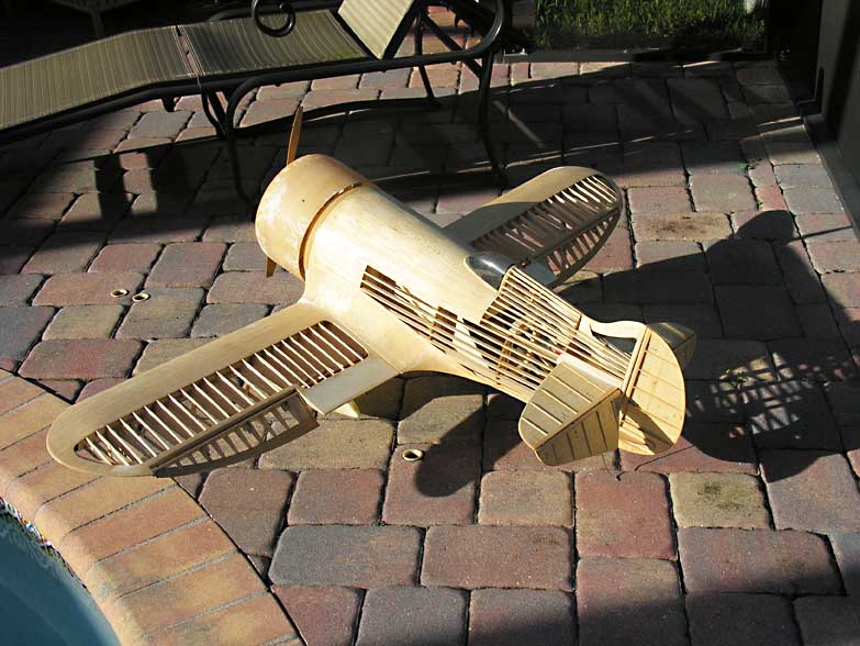

ORIGINAL: flyingagin
JohnBuckner show us your set up. Did you mod the radio? Make it part of your control handle or just hold it seperate? I have been thinking along the lines of modding one so that it is part of the handle. Build a good handle and then gut a radio and add it to the handle. Just looking and thinking so far. Copied down plenty of pics of handles to base my next one on, and then add the rx bits, must do a trigger throttle control like the old JR. Roberts I have.
Flying agine have used and still use a Bill Young handle three channel or functions with pistol grip trigger for throttle. The next ship will in addition to the throttled engine with an HS-85 to operate the throttle will also carry a Hitec Optima Six Rx and either set up still carries a 270 mah four cell battery pack and that will be it for the airplane basic set up. Although I beleve I will install an on board servo for stooge release.
The goal is to be able to fly completely alone and to minmise the trips neccessary back and forth to the handle to just once in my wheelchair.
Now I will be using a an old Hitec Prism 7X with the 2.4 module and it will be on a neck strap hung high at breast height back wards so the the sticks point toward the airplane. Now I have tried this out while flying both my Magician and my Nobler actually using the Bill Young handle for tests and I found it will be very easy to simply reach up and hold the throttle stick or any of the others and I beleve this motion will be easier than using a handle with a trigger throttle.
My plan is to continue with the nobler and the Magician with the Young 'Over the Wire' system but all that are added in the future will be 2.4.
John
This is the Young Handle and system:

The sketch above may be confusing. In the model the two ESC's are connected to the flying lines through a typical RC "Y" Cable. The flying lines are connected to the two outside pins and nothing is connected to the center pin on the "Y" cable center connector. The Yellow wire on the U/Tronics unit must connect to the Signal input pin of each ESC. Likewise the Black wire must connect to the Ground (Return) pin of each ESC. You may have them reversed and that will prevent the ESC's from following the U/Tronics signal.
Have you made a test cable to connect the handle directly to the model? I make the test cable about 3 feet long (1 Meter) and test that everything is functioning with it before unrolling and connecting my flying lines. You should not see any change in the operaton between the Test Cable and the Flying lines.
The Single Channel unit I shipped you had an additional circuit board connected that added End Point adjustment to the control. You might need to adust the 2 K ohm (or 5 K ohm) pot slightly to move the Idle/ Cut off end point.
Clancy

I think I've got it sorted - down to a dodgy solder connection at the stainless steel surflon wire. I've redone the connections and everything appears to be working.

Ido not recommend soldering directly to the stainless steel lines.
My recommended connection is:
1. Cut a piece of 1/4 inch dia. shrink sleeving 3/4 inch long and slide it over the flying line.
2. Using a bright brass or silver colored sleeve make up the flying lines using a crimped or swaged connection.
3. Cut and strip about 1/4 inch a length of insulated stranded wire long enough to not restrict the control movement. See picture attached.
4. Tin the stripped end with solder.
5. Hold the insulated wire along side the flying line and solder it to the crimped or swaged sleeve of step 2.
6. Starting at 1/8 inch on the insulation from the solder connection fold over the insulated wire until it pointsthe opposite direction.
7. Slide the shrink sleeving from step 1 over the crimped orswaged sleeve and solder joint and shrink in place. See picture attached.
This protects and suppports the connection to your flying lines.

Its been a long time in the making but at last my control handle fitted with the Clancy Arnold control systemis ready. All I need now is some very elusive good calm flying weather to get the Shackleton where she belongs - In the Air.
Getting good conections from the stainless steel cables was a bit of a challenge, however advice from this forum proved helpful - Thanks to all.
Hopefully my next entry will be with flying pics.
I now have an unused Fred Cronfelt handle For Sale if anyone wants to make me an offer

I simply crimp the electrical wires to the stainless steel wires and shown in my book (see link above) and have never had a problem with lines since the only thing being transmitted is a signal and ground down the lines. The battery power in the controller has it's own power and has a common ground with the airplane power system. The model and the controller share common ground, the controller sends a signal to the airplane.
I use to have a Bill Young handle, but now fly with a JR radio in DSC mode, or a servo driver for single channel. If 2.4 Ghz passes then I'll pull the down the wire electronic controls, install the tactic 2.4 ghz reciever and switch out to new flying lines.

I have used the method you describe for the other connections but the final cannections to the aircraft and handle are made with standard 3mm bullet connectors.
For future projects I'd be very interested in the 2.4 system, seems so much easier. I'd be grateful for info and advise through this Forum as I am the only flyer in Norther Ireland embracing this means of control.
