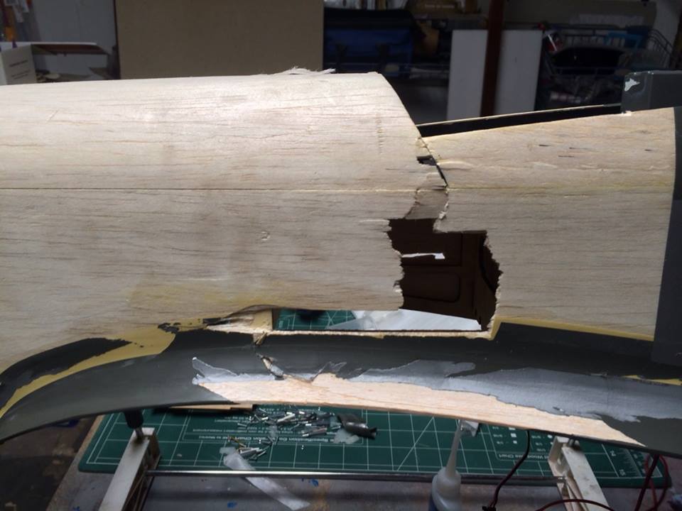

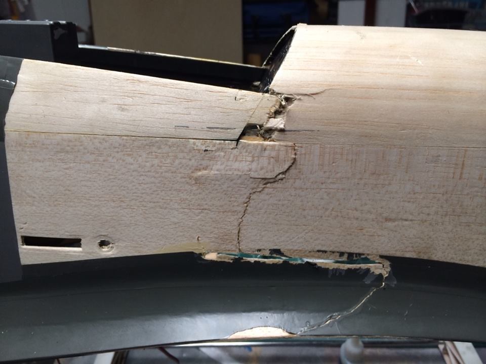

Flew my P-51 last night, it was it's third flight and discovered at landing speeds it has VERY little rudder input. I fly a lot of rudder with my LT-40 and 4*120, especially the 120 on high crosswind days, it usually comes in at a 45* angle to the runway with releasing the rudder just as it touches down, and last night there was a cross wind that kept pushing the Stang to my left as I was trying to land it, and there was NO visible effect of rudder. First attempt was too far south, so powered up and went around, second attempt was right down the middle but too high, didn't want to chance going off the end, so went around again. Third attempt got pushed much further south and I had full left rudder into it trying to cab it, and no effect. I hit the throttle and saw it was going t get too close to the tree behind me, and I must have pulled back too fast as it had snapped over on its back and performed a perfect half circle, but the ground got in its way. Two more feet in altitude and it would have cleared. It hit on the bottom of the cowl and snapped the fuse in half at the instrument panel. The landing gear got ripped out since they were down, and the flap servos, one needs new gears, the other broke the mounts off the plate and the same happened to the aileron servos, so need new gear sets for at least two of those along with one for the throttle servo.
So removed the wheel wells, they are undamaged, removed the gear, looks like they are OK, still straight too. will need to do some minor repairs to the wing where the gear mounts go, leading edges are OK, only busted a few ribs and the mounting blocks.
The Fuse busted clean in half, so might be able to just splice it back together and reglue all the formers. The only damaged former is the one for the wing dowels. Then I just have to recover it.
I might be able to salvage the cowl, it got crunched up, but some epoxy and light cloth should fix it up, then sand and repaint it. The spinner got bent, might be able to repair it, if not I have another one for the kit build. The engine is packed with soil, so will need to clean it up, but nothing got damaged, and it still turns nicely. I have to figure out what is up with the rudder though, I should have had more control with it that it had. Even at cruise speed it has little effect, I should at least see some yaw when I move it, but I dont. It also seems to have little effect on take off too, the plane goes left on take off, and I had the rudder quite a ways right. It is setup with the proper throws, no expo, and no rates. The one thing none of my planes have is expo and rates on the rudder. Last time I flew my LT-40 prior to last night, the aileron servo lead got pulled out of the RX by the throttle servo(since corrected) so I had no ailerons, but brought it in on rudder only, which was a challenge since the rudder sticks a bit and needs opposite touch to straighten out. When rudder input has very little effect on flight its a bit concerning.

Note that "landing speed" on a P-51 of any size is half throttle. The rudder yaws the nose to one side and the tail in the opposite without much heading change on models without much dihedral. You have to use all three axis controls and monitor throttle. And if you were to ignore one successfully it would be the rudder.
With warbirds speed is life and it's about energy management. Keep the airflow smooth to keep control.
There was zero yaw at just below half throttle, thats where the problem occurred, but the thing that brought it down was overreacting to the upcoming tree and pulling up instead of banking to the left and going north. I really didn't have an issue landing it, the issue was keeping it lined up with a cross wind. Going to take more practice and less pulling back on the stick. The first two flights I was able to land it just fine, putting it right where I wanted it, except for hitting the unseen gopher hole and flipping it over, plane was already on the ground, tail down, then blip, over it went. I may just increase my rudder throw once I get it back together.

The wing I started pulling the broken sheeting out, left wing is just damaged on the bottom, and all ribs are intact, right wing rib 1 is pretty much gone, so I will have to dig through my kit to find the template for that rib, shouldn't be too much difference between kit and ARF. Glued together 2 pieces of hardwood to match the forward gear block width, and once cured can cut out two new ones, and have larger block for the aft gear block, the right wing got top skin damage so that will take a bit more work. I dont see more than a few hours work to get it back together, including covering. I'll get some pics of that next time I work on it, I didn't have my phone with me.

Back to the rebuild, I cleaned my engine the other day and found the case was cracked from the crash. A new case and bearings are being delivered today so I can rebuild the engine, then recover the plane and reassemble it.

I have flown a fair few warbirds and I learnt early on to ignore the throws specified for the rudder.
Nearly every plane I have I run full travel on the rudder with only a small amount of expo. Especially the warbirds. I dont run dual rates on the rudder.
One thing I do remember about my P-51 was that it would drop airspeed VERY quickly if you crossed the ailerons and rudder up coming in to land. I always kept half throttle until I crossed the threshold and then slowly drop the power to get a nice sink rate.
Yours having no rudder auth at half engine speed would make me think there was an issue with the servo or the control setup.
When you rebuild it swap the rudder servo out and see if it helps. Also check there isn't any binding in the control rods or pull pull setup.
And set the rudder to give you full throw. If this makes it touchy on the rudder add a small amount of expo to soften it.
