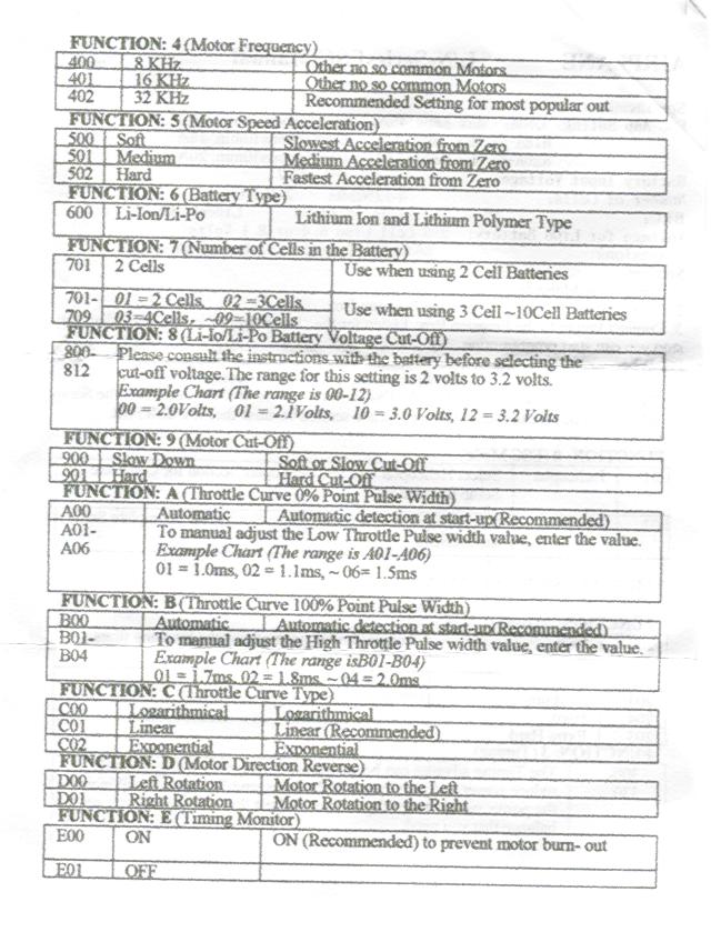

Any one know what colour wires on the towerpro bmc 40a esc
The esc colours are red, yellow and black, and on the motor red, yellow and blue.
Thks
Thks

did you get your esc to work ? I have a "mag8" towerpro esc and the beeps don't match the instructions. Any hints you could give me ? cheers, mugs
Joined: Feb 2007
Posts: 2
From: New South Wales, AUSTRALIA
Mugwings
I have been having the same issues with a Mag 8 esc that i have no instructions for. I have been searching the net and think i have finally found what we need. I am yet to try but it seems to match what i have been hearing from the esc. See if you have any luck with it.
Brushless Motor speed controllerManual

5. If there is setting you want in the process of sound cycle, switch the throttle
stick, to the lowest position at the first time interval. (For example, select
LIPO automatic protection: switch the throttle stick to the lowest position when
hearing one B sound)
6. If there is another additional setting, quickly switch the gun to the highest position to make a
selection.
7. If you have finished the setting you require, wait 2 seconds and the motor will send a
confirmation sound for battery protection. It is usable after confirming the position of throttle
stick.
8. LIPO automatic protection has only 2 voltage protection points, i.e 6V and 9V. There is no
need to use a full capacity battery.
9. NiMH automatic protection is calculated according to the real number of batteries. Sets
0.8V for each battery. In order to ensure accurate judgment of the battery voltage, please
charge the battery to full capacity. If the battery is not at full capacity. The speed controller
will estimate the protection voltage according to 53% of the full capacity.
10. the brake is seeing as default set
11. Reset the brake operation to release the brake function. .
12. Factory parameter reset function: because this series of electronic governor has an
overheating and false operation protective function, if you find that the speed controller is
accelerating or changing is direction, or the throttle is different from the original condition,
you can reset the factory parameters to obtain the highest performance.
When starting the machine there is a long B sound. It indicates that the electronic governor is
in LIPO protection mode. The BBB sound indicates that it is in NiMH/NiCD automatic
protection mode.
