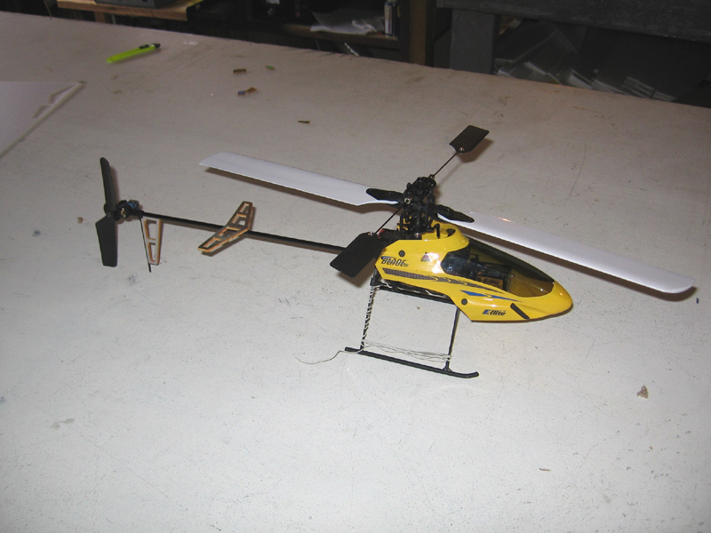

Hey guys, I jumped on the laser and made these tail fins, what do you think? I covered them in holographic vinyl which will look awesome out in the sun. I can do them in any color.
Tried to get a picture of them changing colors, but with the flash its near impossible
I also cut out the blade holders.
