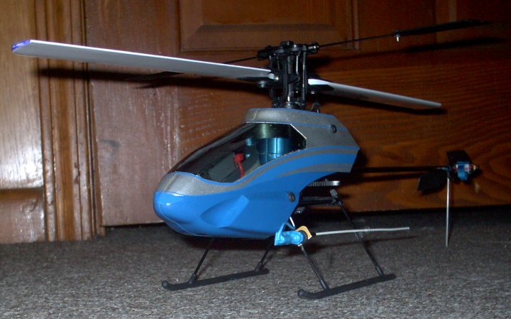

Just finished making the canopy my own. I also bolted a CF battery mount underneith. I'm using the radio shack fasteners to keep the battery. holds tight in flight but releases well if you hit hard. Takes up the impact and reduces damage. Note the new bell hiller.

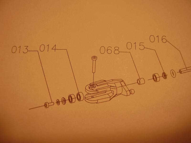

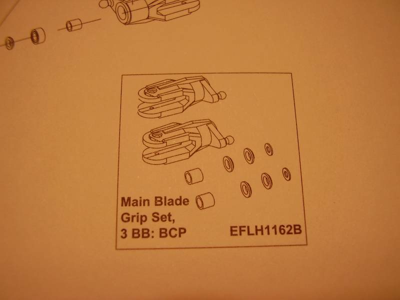

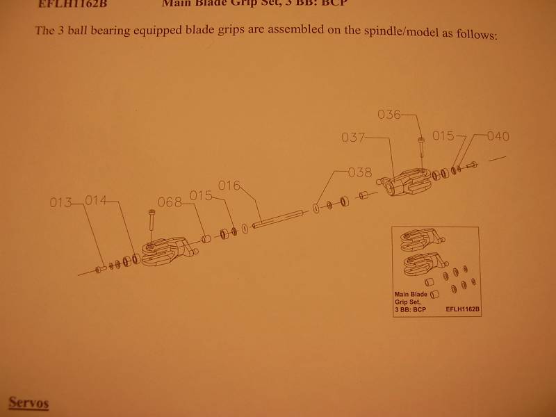

I did order the 3bb grips and got them in last week. I didn't know that you had to order bearings also so I have not used them yet. I am ordering bb's this week.
