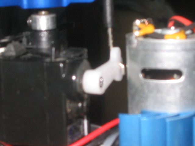

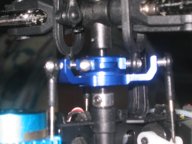

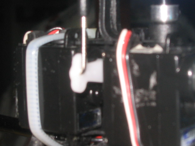

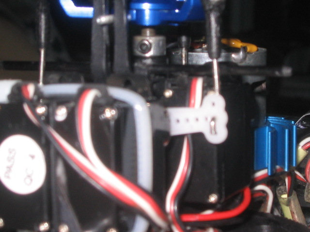

[quote]ORIGINAL: stimpsonjcatt
Horizon CNC Swashplate Problems
Also, if any1 has any pics of their setup showing your neutral horn positions that would be a big time help to.
Scott,
Here are some pics of my two blades and the servo horn positions, I hope it helps. Also you can see my brushless motor set up with the MR RC-Cam board.
