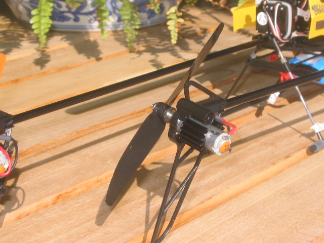

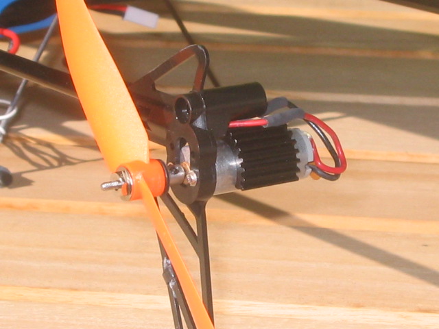

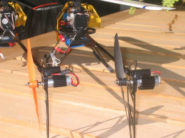

#1450
ORIGINAL: JamesKen
I injoy my blade greatly. I am an old rc'er but new whirley guy. I do hover , now my tail motor has givin way. Has anyone used either the two motor system or the DD motor with any success? And where did I see it in the thread? Thanks all you contriutors for the great insights and tips it adds greatly to the hobby
James
James
I have used the DD tail upgrade and it is very successful. I got tired of replacing the plastic gear and if the motors wern't buring out the bearing would come loose. If your LHS doesn't carry the GWS parts the listed sites do. CHeck out:
http://www.heli-fever.com/index.php?...f76c27f3e4297b
Direct drive Blade adaptor $4.50
DD tail Fin $2.50
GWS motor $7.50
Heat sink $1.50[img][/img]
