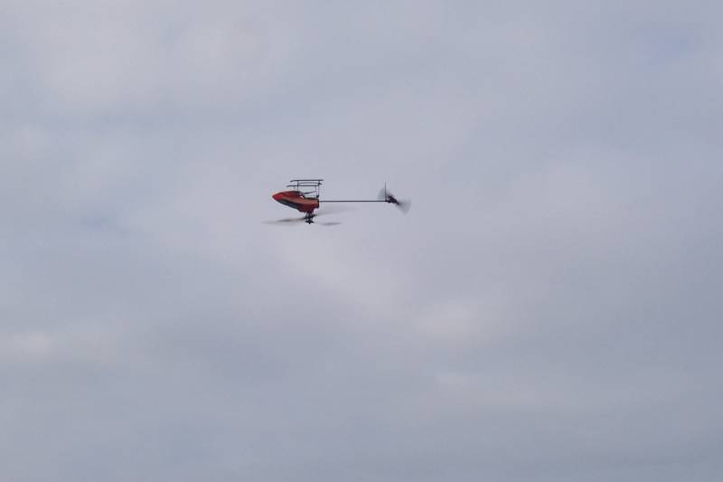

Where is your upright hover in Idle up? 3/4 stick? 1/2 stick? I ask because in idle up at middle stick should be zero pitch. Upright hover should be above that and inverted should be below mid stick. Ive flown my cp inverted, flips, rolls, loops, And even some invert hover. Ive found that the pitch can be manipulated buy changing the links between the blade grips and the mixer. If you have a pitch gauge, check it there. I get +10 to -10 Im in the middle of a rebuild from a loss of control fron inverted hover. Oops the pice is this spring(winter)

the pitch i'm not too worried about, i hover between midstick and 3/4. i have a 7c to do all the programming. so by what you mean... FLYING in inverted is easier than hovering? i've done loops... but that's it. i also found out that the motor will stall very badly and the headspeed will decay if i give a jab of collective. what setup do you use on yours? gyro? bl motor? or all stock? i got a bh upgrade and a lipo.

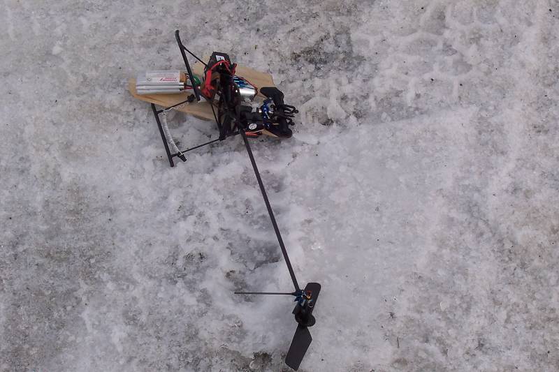

Im running the stock transmitter, alum swash, bell hiller, 1320 lipo and a venom micro fireball 370. I also have some lighter paddles ive used on it. It falls like a brick if i lose the head. I have some short clips but dont know how to load them. Ive found, Even with my nitro shuttle, That collective management is important as to keep the head speed up. Heres the other pic from that day, when in an inverted hover at 5ft, I pushed up instead of pulling down to climb out. my current rebuild is from a back flip to inverted and killed the head and lost it.

olds455, wat do you mean when you said you've lost the head? should my headspeed decay so badly? or is it that my motor is going bad? when i increase collective pitch, the motor would stall, causing teh whole heli to spin tail right even with full revo mixing because of the increased drag. i'll be ordering maybe 5~10 pairs of blades from helidirect. when i do, i'll try to perfect my loop and do rolls knowing that my dad doesn't need to drive me 20min to my lhs everytime i crashed.
olds455, looks like your flying in snow. but how can you fly when your wearing a glove? just wondering...

I mean the headspeed. once the speed is lost, so is control. I ve lost it so bad the right stick does nothing. You say you increse the collective and the motor stalls, How? The motor will bog for sure. Espically if the pitch is to high. I havent ran a stock motor in so long so Im not sure. the venom fireball is only $15 so the price was a no brainer. At full + or - pitch the heli will bog but it climbs out very fast. It sill sound like your pulling to much pitch. It does take practice. Ill try to load these clips at the rcuniverse video site. The pics were on 3-24-06. its cold but Ive learned to fly with cold hands. After the flight its time to warm up. The batteries dont last long in the cold anyways.
