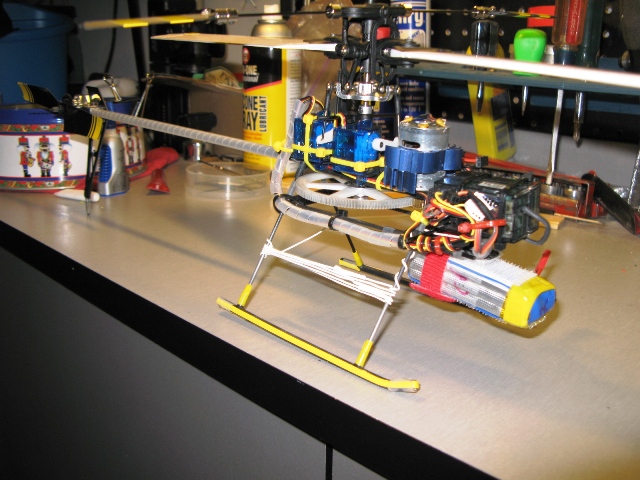

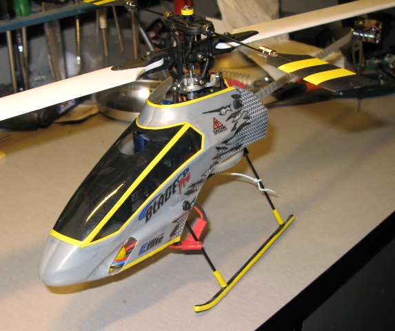

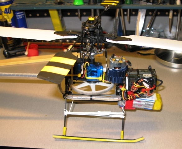

Yah!!! I got the Wheeeeeeeeeeeeeeeeeeeeeeeeeeeeeeeeeeeee Back!!
Thanks to Mr. Choppers and everybody for the tips and advice. So my CPP poor lift/hover with symmetricals problem was due to a failing main motor (duh!!) I’m pretty new to this game and guess I didn’t realize how fast these little motors can wear out. I was flying up to 4-6 packs a day! Also, I think my spindle was bent, but not sure how much as I burned in hard just before I replaced the main motor.
Anyway, I took Dave’s advice and installed a 370 10 tooth main motor. It really gets the head speed up. Almost seems to over-speed at times in idle up so I turned down the idle up mid-point adjustment. The HS-55’s are working good, though they are always bumping up and down just a little bit. I’m gona p/u some contact cleaner for the TX and see if I can get it to stop.
Still getting her tuned perfectly, but it’s getting close. Flew into the wind and light mist today. Hoping to hit the ball fields at the park tomorrow.
Here are some pics. I got a little crazy with yellow pin stripping on the canopy one day when I was bored at work. It actually helps a lot when the visibility is low. See ya, Onad

very nice, I like the yellow bling =) That definately would be useful for low light =)
I also like your wrap around the boom and stuff and how you routed your wires, looks great!
how does it all balance with that pin striping on there? Like the rear rotor, and is it tail heavy with the extra weight on the boom? Have you flown it very much with the pin striping on there, how do you think it will stick with all the wind and stuff?
#4586
Yah, the bling is also really helpful in getting the little bird back home after ripping a big banked turn 100ft away...
The pin stripping is for hobby model and is very thin/light so I actually use it as balancing on the tail rotor. Adds a little bit of weight, but not much. The stripping has been on for 6 weeks or so and stays put with no problems.
The tail rotor in the picture is my back-up plastic tail (this was the first tail I stripped and over did it a bit). I broke my carbon tail in the last wreck. I had a less striping on the carbon tail. I notice a difference with the lighter carbon tail rotor. Seems more responsive and lags less than the plastic. It has been more durable than the plastic. Also, I shortened the tail boom to 10.5†from the frame.
As for the weight, the tail wrapping is very light. I thought about taking it off when I did my rebuild, but it weighs almost nothing. It does help with blade strikes and adds a little bit of visibility to the boom.
I’m running a different Rx and 3:1 on this build and still having trouble getting the tail hold totally dialed in. It might be this 3:1. I’m going to swap out to the original 3:1 and Rx and see if makes a difference. Wondering if the 10 tooth motor is influencing this also?
Chopper’s, do you run a head holding gyro with your 10 tooth motor setup?
Tx, Onad
