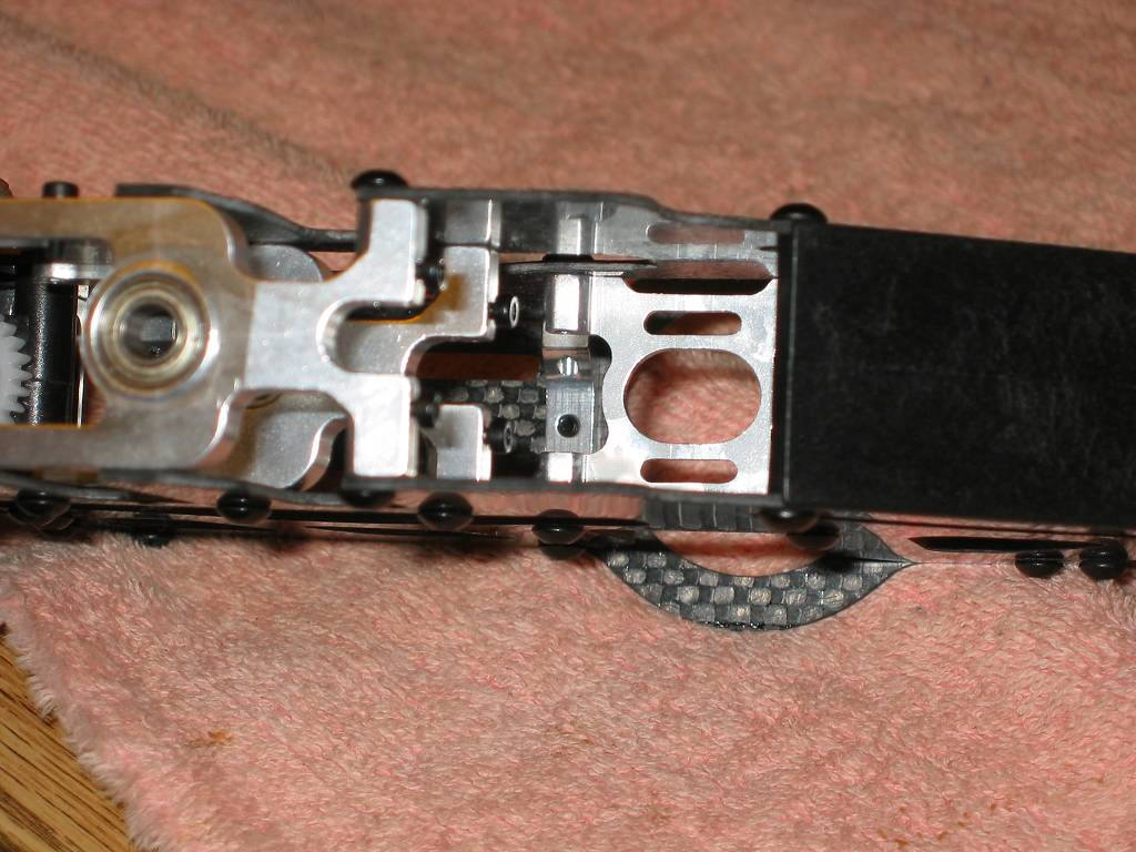

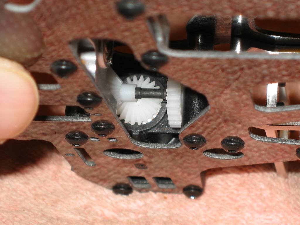

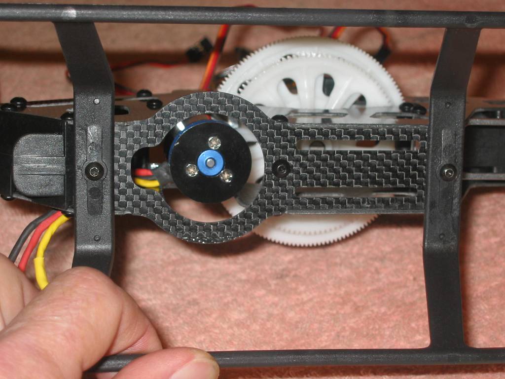

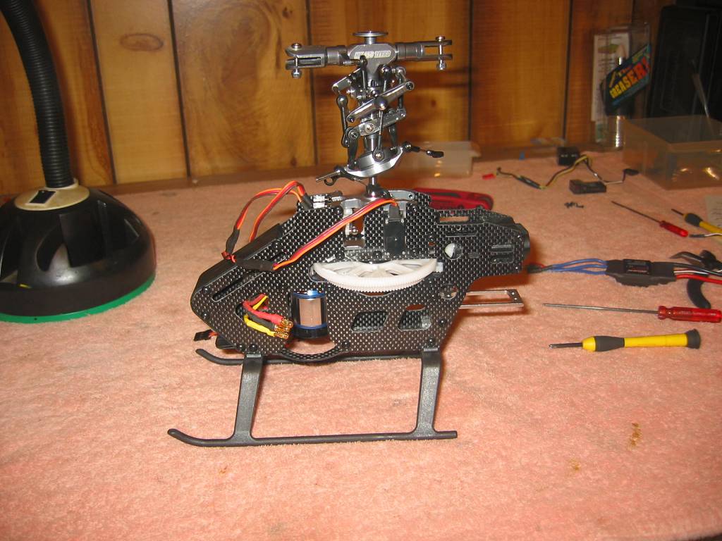

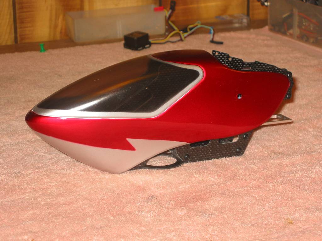

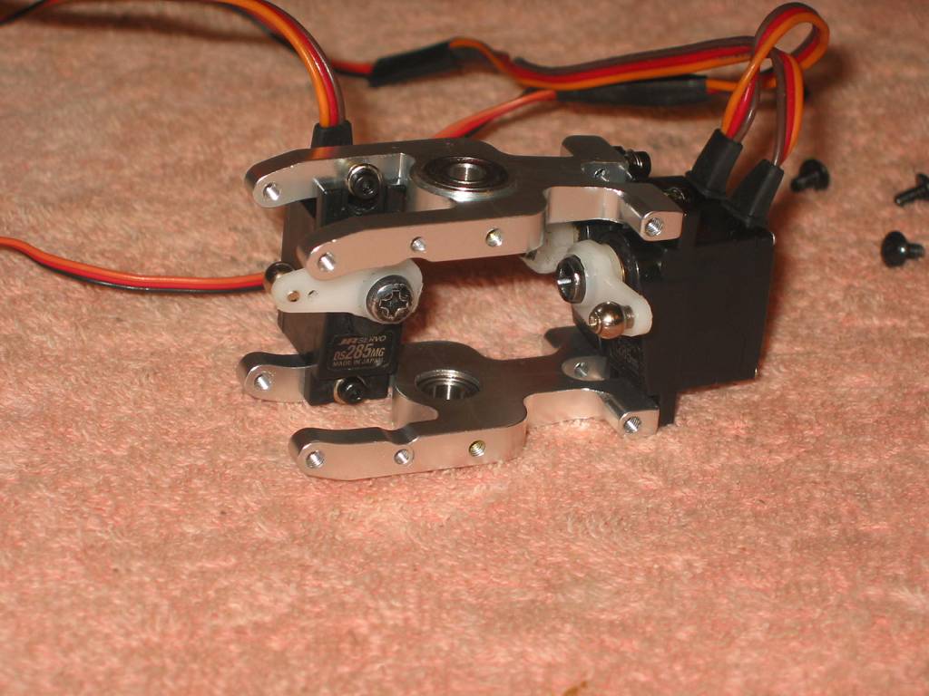

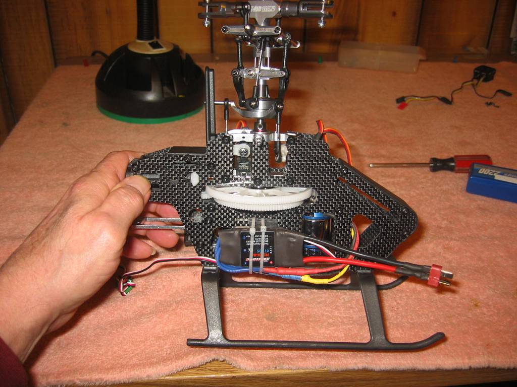

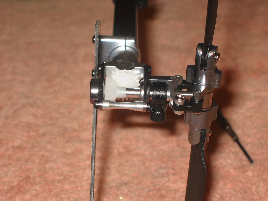

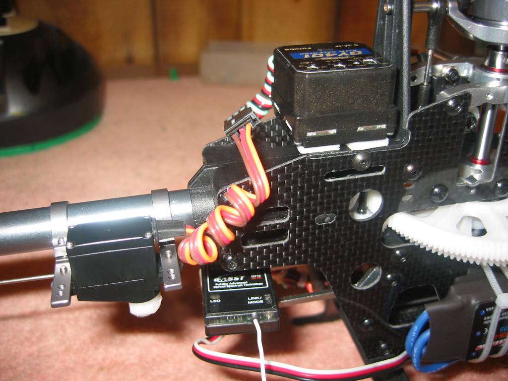

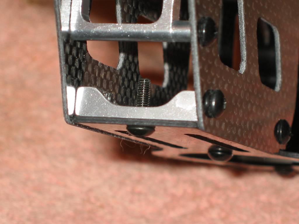

More pictures of the HK 450 TT.
Note: In picture #5, with the view of the tail box. Check out the tail grips, they have incorporated the "Chinese Weights" into the grips. They're suppose to reduce vibration and enhance tail response. Just a FYI.

Dave- The TT looks real nice, keep us updated. I'm especially curious about the chinese tail weight mod.

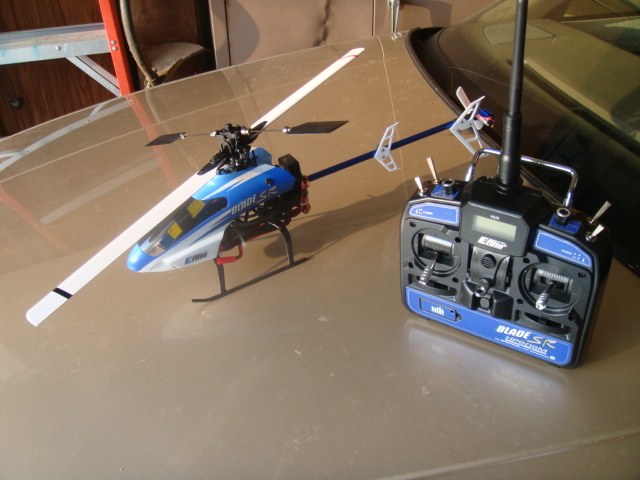

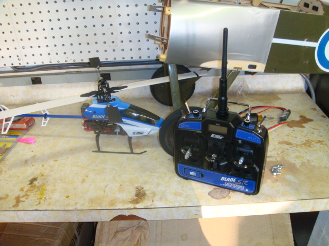

PLEASE allow an OLD MAN to try and fool himself on how he can FLY A HELICOPTER.
This is what arrived in today's mail ! ( 3 pics )
UnSolicited ? I think NOT
Out of the BOX and onto the driveway, even without charging the batter it went.
In quite a substantial breeze , the heli is VERY, should I say EXTREMELY SMOOTH.
Hard to hold very steady in one spot, but I detect a slight , very slight BUMPING sideways
in the tail. Still responsive as required. The INNOVATOR 530 is much more Locked-in. !
May need a touch of adjusting on the GYRO ( ? )
Now going on charge. The battery, unfortunately is a 3S 1100 but with the old orange
micro connectors that we used to have with the CP s.... maybe all the other batts. will
fit onto this one.......Battery fits in the same way as T-REX, Up front and tilted forward.
One bit of nuisance, have to pop the canopy totally off to install and connect the batts.
Me I LIKEEEE but then, what do you expect from a doddering old fool HA HA

Rick,
Congrats on the new SR, you make me think, I need to get one too.
Always have fun, and with your new arrival, I'm sure you do.
A couple things I want to mention.
1) You said, a quite substantial breeze and hard to hold in one spot. That will be almost impossible, because of the disk area and the weight of the helicopter. In a breeze, just keep it moving around and develop more flying skills.
2) On the batteries from the old CP's we had, and the orange connectors. I don't remember exactly, but I think the old batteries were 2 cells and 7.4 volts. The new one you have for the SR is a 3 cell and 11.1 volts. The old ones would work, but may not have the power to lift it off the ground. Can't hurt to try, though.
Hoping all is well, fine and dandy,
Dave

HI Guys,
A couple more pictures of the HK 450 TT build. I should have it completed tonight and ready for a test hover tomorrow. Either in the garage, or outside, weather permitting.
Almost 50 degrees today, and the snow is almost gone. Except for the big drifts.
Dave

just finished reading the THREAD.
IMMENSE CONGRATULATIONS ! what a piece, and so well written. Plus the heli is a beaut !!!!
I can't believe I can be so overwhelmingly embarassed by my posting a BLADE SR, just like
a MORON
when all you guys ( Jay, JPEE, Dave...........etc ) are flying like pros. and REAL HELICOPTERS
not
NOT
"training wheels dummies" like yours truly......
SHEEEESSSSHHHH.....the shame of it all [:@]
i think i'll sign off and never show up ever again........[>:][
][&o]

HK-450 TT Pro update:
Getting real close, but to tired to finish it tonight. Needs, flybar and paddles. And main blades. YIKES! Another day.
