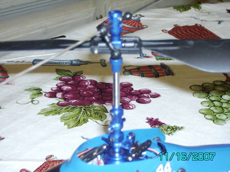

I want to say that due to my addiction I have a need for upgrades. I receieved a set of xtreme blades and 180 motors. I did not get the blade holders, batt smc, prob come in Sat morning. but for now I'm gonna install motors and fly with stock blades to see and compare how it flies against the extreme blades with microheli blade holders.
[img][/img]
Joe
[img][/img]

Hi all, well I installed the xtreme 180's and used stock blades with stock batt and it flies heavy... usually with stock motors I can hover at 1/2 stick. I'm actually 3 clicks higher with new motors.... [X(][:@] I need to break motors in.... HOW do you do that?..... or is it too late..... I hovered for about 3 min... hopefully with the smc 800mah 22c, micro heli alum blade holders and xtreme blades I'll get better hover for the juice....I'll get those hopefully in the morning......Then I will see what alot of you are talking about....
SO HOW DO YOU BREAKE IN A EXTREME 180 motor?
I also lost [X(] which motor was which... I installed the wires on the rx the same way the old ones came off and made sure they turn the same direction... hope thats enough.
Joe

If I remember right a lot of people do 1/3 throttle increments. So start of at 1/3 throttle for 10 or 20 mins can't remember exact time then do the same for 2/3 and full. I just plug the motors in the receiver to do this. I do it a little different. I throttle up until the motors start to spin then leave it there for an hour. It is longer and I don't know how well this works compared to the way others do it. Looking from the back the motor with the pinion that is farther away from the motor is on the right side and the pinion closer the motor is on the left side. Hope this helps.

Some people dislike the 'breaking in via 4-in-1' because that isn't a stable DC, it's a switching power supply. So really fast on/off continously. This might not seat your brushes the right way. You can also just use 2 AA batteries and connect them to the motors and leave them running for around 30 minutes. But there's loads of info about breakin-in on this forum.
Back to Solo; How come you're nimble CX2 turned into a 'whaler'?! Mine (with all alloy, but no grips) doesn't seem any heavier then stock... It even flies better! Have you tried one less colar on the flybar? I can even fly my 'big *ss' batteries with them in slight winds!
There's a post (i think by Wolfpackin) with all the weights of stock and Xtreme parts somewhere around here... Maybe your custom boom is weighing in?
