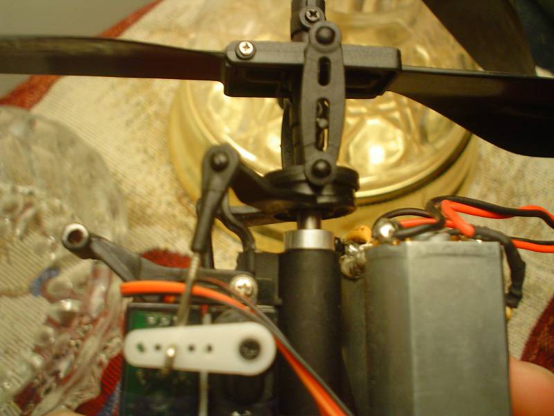

So as you guys know Ive been having this tbe thing goin on for a while...well pretty much since after the first time Ive flown it. Anyhow, I took it the hobby shop...he eye balled it etc, said it was the inner shaft! So I put that on along with new blades and a flybar and its the same thing!!! I noticed a wobble on the outter shaft when I just use the lower shaft....could it be that? Or the the bearing issue? I noticed mine were kinda loose in there too!! Or an unlevel swash plate? What about adjusting the pots?? Because now All it wants to do is fly forward.......I have to to trim the pitch all the way back and still hold down on the stick just to get it to hover and not go straight..but when I do that...it barely wants to fly or pitch backwards!!!!! Could I have installed that innershaft wrong? IM A NEWB I KNOW...but I have no clue about adjusting pots or servos...Im just upset I got to fly it one night....that it actually did what it was supposed to, and right when I learned to hover it I tried to yaw it and make a circle...of course crashed and I havent been able to do anything hardly with it since!! I can fly it, but in order to half ass fly it anywhere the trim is maxed out and Im still pulling the sticks to the max just to get it to hover or not fly or pitch forward! What should I do guys? Pa LEASE help me......
If it only wants to go forward then you need to take the sero link on the left for forward and reverse and pop it off the swash plate and give it a few turns clockwise and then put it back on and try it. After a few times you will get it leveled. May have to do the other side also if it starts to move sideways. center your trim when you do this, and adjust till it dosn't go forwards. And the swash should look level or at 90 degrees to the shaft.

You said you noticed a wobble on the outer shaft.
While going through Soloboss' vibration identification process I observed a wobble in my outer shaft. At first I assumed that the shaft was bent. For some reason - I don't remember why - I removed the stock plastic bearing cup from the top of the outer shaft and spun the left motor up again... NO VIBRATION AT ALL. I put the bearing cup back on and spun the motor up again... Vibration. Took the bearing cup off again... NO VIBRATION AT ALL.
So I replaced the stock plastic bearing cup with the E-Flight aluminum CNC cup. This solved the vibration problem on my outer shaft and SIGNIFICANTLY improved the overall performance of my CX2.

I had a problem with my stock bearing cup as well, replaced it with E-flite's CNC version and the vibrations were reduced alot. There is still the tiniest of wobble though- doesn't seem to affect flight or hover, but I am going to replace all of the bearings w/ Boca ceramic bearings- they make a set for the CX2- its kinda expensive, but hopefully they will last a long time!
ORIGINAL: spence19802003
well, possibly, but it couldn't be that wrong or it wouldn't lift off the ground - sounds like the swashplate is whacked, or the links from the swashplate to the blades are whacked
does the swashplate top look level, front to back and side to side? - is it perpendicular to the shaft? - are the links on right?

The swashplate came to mind here too. How about a separated swashplate. There used to be a lot of conversation about those when the original plastic swash came apart. It seems that everyone has gone to the alloy swash - except me. I'm still using the ORIGINAL swash that was installed at the factory.
If the heli was good until the wreck, I doubt that the links changed length - but the swash might have separated.
Since I've never seen one come apart, I wouldn't know about it, but the flight symptoms sure sound right. Or am I just nuts?
