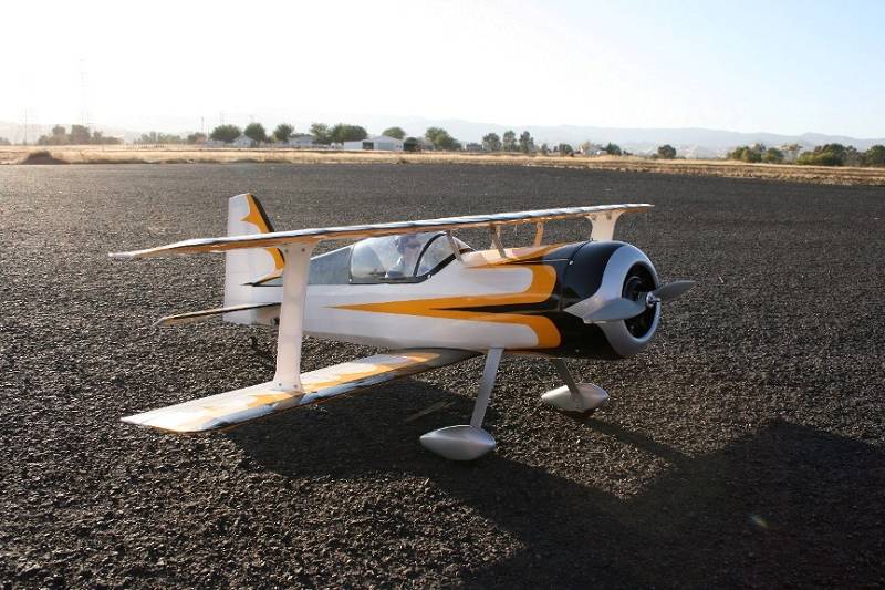

After spending many hours on building this beast it will not FLY! (two flights and two near crashes).The CG is dead on for the battery used and controls are set to the low rate. I'm using a 12x8 prop and all the plane wants to do is climb. Several club members have checked the plane over as see no problems. The kit was short several parts and there were two mod notices with the kit. I've called Horizon Hobby three times and all these people seem to want to do is argue rather that help solve the problem.
Any help would be appreciated.
Ron
Ron

Check the incidence on the wings. (The bottom wing should be 0 (zero) and the top wing should be -1 (negative one) degrees. ) They are calling for them to both be parallel to the elevator (page 14), but it sounds like you may need to adjust that a little. . Also make sure you are CG'ing it on the TOP WING
Per the manual:
"The recommended Center of Gravity (CG) location for the Pitts
Model 12 15e ARF is 3 3/4– 4 1/8-inch (95–105mm) back from
the leading edge of the top wing"
Per the manual:

Like the name and thanks for the input. The incident of 1deg or so might be the trick. The CG is 3.75 just as called for in the manual which makes little or no difference of how the plane flys (nose up, plane will not level regardless of elev). Also there is no accounting for prop factor by tilting the motor several degrees down or to the right as in most designs. This is something else I need to try. The ESC is the E-flite 60 and the battery is an electrfly 3 cell 3200 pushed all the way forward and over the motor.
As mentioned in the second attempt to fly the prop was increased to a 12x8 from a 12x6. According to tech support at Horizon this is the problem and I need to use a 14" prop. Going from the 12x6 to 12x8 just made things worse.

Prop the rear of the plane up so it's sitting level, and sight the wings from the side. For the issue to be this severe, you should be able to detect one of the wings is way higher in the front than in the rear. It's probably the top wing.
It's possible you put the cabane and interplane struts in backwards, which would raise the front of the top wing and lower the rear of the top wing.

I did try leveling of the plane and the wings are parallel. I did however put at least a 1 deg neg on the top wing. Nothing is off from the instructions of E-flite and surely not that far that it would be missed. At this point I'm of the belief that there is something very wrong with the design or at least with this particular kit.
The manual is based on the E-flite 15e motor and 4s lipo. The option for the 25 motor with 3s lipo is only mentioned as an option and not discussed as far as it is 7 ounces heaver than the 15e combo. I have tried both weight options and had to add LOTS of weight to the tail to get the 3.75 in CG. This still doesn't make much sense because my plane flies like it's tail heavy
I did discuss this with Horizon tech and their answer was " adjust you elevator linkage? (i currently have 1.25 inch throws as it is).
Thanks...Ron

I just finished assembling this ARF last Sunday. Like most of you I was frustrated with the errors and lack of logic in the instructions. Several parts were not in the bag while some useless ones added.
I could'nt resist to write to Horizon and share my view as those mistakes were reported a long time ago in several forums - how come it is not corrected now?

maidened it today. Here it is: quit whining about this bird, this is a great model!!! Other than previous comments on parts and manual, I had a blast with this airplane...very impressive at the park. Agile, powerful, solid. And I don't give a s.... about the 3D stuff.
Here's some technical tips:
-I added 28 Grams of lead (4 pieces) in the nose for more authority when landind and less tail-heavy feelings
-Reduced the motor spacers about 7mm to reduce the space between the propellor and the cowling
-With an Eflite 25 motor and a Rhino 3700 MHA 4S 20-30C pack, this thing is on fire !!!
For some who are interested, you can buy this pack from Hobbycity; the size and weight is perfect for this model. With this kind of torque I can take off within 10 feet!
-My Zippy 3S 4300 MHA pack was also very decent, plenty of power but not a powerhouse like the 4s...
