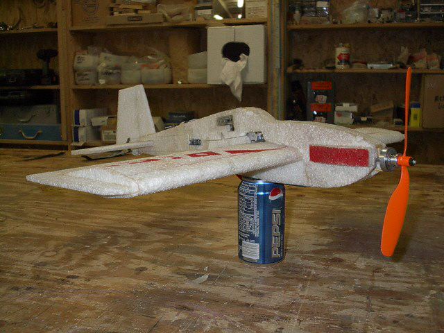

Okay, took 22 days to get my replacement on the CD rom motor. Wired it up and off to the field I go. The setup called for a 8/4.3 prop, direct. The best I could do was a 9/4.7 cut down to 8 inches. Vertical right out of hand. The 4.7 pitch proved to be a little too fast for the Mini Pigi. Now the diameter must be something different, as I used up the battery, 340 mAh 3 cell Lipo, in about 5 minutes. The motor was very hot. Second flight it came back in under three minutes. Now back at the shop, I noticed that the magnets do not have the bite that they once did. The motor now turns slowly in a jerky manner and smells like a H.O. train. Does heat effect the magnets? Oh well, back to the drawing board. I better look into that small Nippy Black. Joe

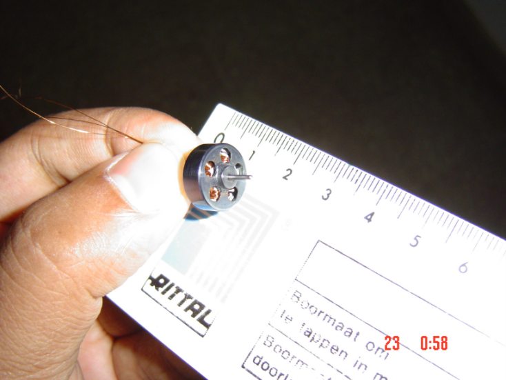

Joined: Oct 2004
Posts: 1
From: Bangalore, INDIA
Default RE: Mini or Micro brushless motors
Hi all,
I'm new here, mainly active at rcgroups. I'm not sure how many of you have seen this:
http://www.rcgroups.com/forums/showthread.php?t=280058
We are developing this 3.2gm BL motor, most issues have been ironed out and the motor is performing beautifully on the CCP 10 and the Smaller Jeti ESC's. Should be out soon[8D]
Happy landings,
Uttam- India, Bangalore
http://uttam.freeservers.com
