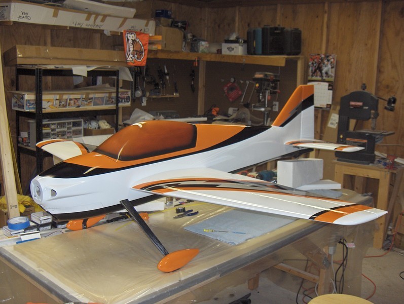

I'm happy to announce that built up wings will be available for the Lightning pretty soon now Dave Snow has agreed to modify one of his wing and stab sets to match the Lightning exactly. I will cut them in house to ship with the fuses, and they will also be available separately.<div></div><div>Have the stab, waiting on the wing. Very nicely designed, to say the least. The jig is awesome. Can't wait to get them both ready </div><div></div><div>Don @ EAC</div><div></div><div></div>

The all up weight with a Hacker C50 14XL, Hacker Spin 99 ESC, Power Unlimited 4900 batteries, and a 900 mAh receiver battery was 4612 grams as the NATs. This weight is also with an APC prop and a Tru turn spinner, which are not the lightest equipment. The key to making this kind of weight is to not allow and piece of wood that is not the lightest into the airplane. I weighed each part that went into my airplane. Out of all the wood I ordered, the difference between the two heaviest fuselage side sheets and the lightest fuselage side sheet was 3 ounces. Saving a gram here and there really adds up in the end.
As far as electric set ups, there are many good setups. If you are new to it, I would use a proven combination. There are quite a few threads dedicated to electric set-ups on this forum.

<div>Have the wood wing and stabs added to the Lightning page.  Dave's wings are very impressive, the jigs make it pretty much impossible to make a bad wing      Thanks, Dave!</div><div>
