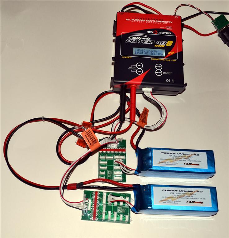

The neat stuff comes next when you daisy chain another 5S pack in parallel with the "safe parallel adapters" and another discharge wire. In theory, you could charge this setup at the 40 amp maximum rate (20 amps into each battery) with the proper power supply.
So you can see that the potential is there to charge your packs at very high rates, or charge many packs at the same time. Either way, you can save a lot of charging time. To add more packs to charge, you would add another balance adapter to the daisy chain and add another discharge wire. And so on, and so on etc.
Pros:
fast charge
charge many packs at once
up to 40 amp discharge capacity
internal resistance readings
Cons:
need 26V available input to get maximum power from the system
cost to must buy extra daisy chain adapters and discharge leads if you charge many packs in parallel
initial cost of charger
inability to hard wire your 5S packs together

If you were discharging two 5S packs at 10 amps each, where is the 20 amps going? That sounds like a lot of heat unless it's going to a lead cell battery or something which brings up the next question. Can you discharge at reasonable break-in rates like 20 amps or so with the system hookep up to a conventional power supply like the Iota 55? It certainly is an intriguing charger!

So if you daisy chain 5 packs it will give internal resistance for each of the packs?
I've been charging 6 packs at a time at about 25A. It's very convenient since you don't have to keep attaching new packs and then start the charge cycle over again.
The PL8 balances by throttling back the current to the higher voltage cells rather than bleeding off the higher voltage cells. I didn't have any luck with the the Thunder power balancers. I think they over heated and drove themselves out of calibration as they bled off the extra voltage.
You can see parallel adapter cables here..
http://epbuddy.com/index.php?main_page=index&cPath=7

Here is a clip from the instruction manual. To get max discharge capability, it needs to be connected to a lead-acid (car battery etc), but it will do 10 amps discharge when used with a power supply.
Regenerative discharge routes most of the energy from the pack being discharged back
into the Lead Acid battery powering the PowerLab 8. This feature is only available
when the PowerLab 8 is powered from a Lead Acid battery. Regenerative discharge supports
up to 40A, 1344W maximum.
- Enable/disable regenerative discharge at the PowerLab 8 via Smart Power Management
for the supply battery.
- Enable/disable regenerative discharge, and set maximum discharge current and
maximum discharge voltage, in the CCS Supply tab. Remember also to set supply
battery low voltage cutoff and maximum output current for charge cycles.
PowerLab 8 automatically determines whether it is connected to a Lead Acid battery or
a DC power supply. If it detects a power supply, it switches to internal discharge (10mA
to 10A, 100W maximum).

How will the Cellpro charger handle parallel charging of two (or 3-6) packs that initially hold different voltages?
(I.e. if one pack is half full, and the other pack is almost empty.)
When these packs are parallel connected to the charger, what voltage will the charger see through the balancing taps?
Also, will all the power initially be fed into the lower voltage battery until this "catches up" with the other pack?
Magne
Magne

Magne
When connecting packs in parallel the higher voltage packs will discharge into the lower voltage packs until the voltage is equal. Most people connect packs that are about the same state of charge and the same capapcity. Tests have been done with packs of widely different state of charge and even with batteries of different capacity without problems. Cellpro sells safety connectors which limit the current between packs, but most people are not using them. The balance connectors will also bleed the high voltage cells into the lower voltage cells. For instance all of the cell# 1's could end up at 3.75v, all the cell# 2's could end up at 3.73v, etc., until the charging begins.
RCGROUPS.com has a lot of info on parallel charging. The pattern community seems to be slow in adapting to parallel charging.
See http://www.rcgroups.com/forums/showthread.php?t=1176112
I don't think we are slow in adopting parallel charging, simply that for this application until higher current output chargers were available there was little to no advantage in doing so.
Until recently most of the chargers were limited to 7-10A, but could do 10-14 cells in series, so it made more sense to series charge. For instance, the TP1010 was probably the most used charger, for a 10s 5000 mAh pack (x2 5s 5000), the time to charge in parallel or series is the same, but it is more work to make the pack ready to charge in parallel.
Likely with some advantage to be had, people will start parallel charging more.

Magne
(But, and I am not trying to be awkward or difficult, just trying to get to grips with the possibilities.)
Does this not mean that if for instance you want to parallel charge four packs (each 10s5Ah) at max power (40A total) INTENDING to get 10A into each pack (2C),
if one pack is at eg. 3.5V and the rest of the packs are at 3.7-3.8V, (could easily happen after flying) then not only will all the current (40A) go into the lower pack, but the higher packs will discharge into this pack as well, putting the total current even higher, until the voltage is equalised in all four packs?
Regards,
Magne
