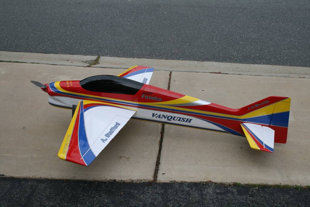

Just put the graphics on it...really makes it stand out. Since I have a vinyl cutter, I cut my own Vinyl graphics in the same font as Extreme Flight. Really brings the plane to life. Will post pictures tomorrow once its outside.
Arch

Well, the graphics are on....will be heading to the field here in about 2 hours.
Will give a detailed flight report this afternoon,
Arch

Anyway, here is what everyone has been waiting on. Flight report.
The plane flies very nice. Very smooth and constant speed. The power is very good with the stock Torque motor. It's not equal to my Neu motor setup, but I didn't expect it to me. The plane will do a vertical snap and keep on trucking. It is drawing about 76 amps with the 21X14APC and has very good power. Cooling is good as the motor wasn't overly hot and the batteries weren't even really warm. Right now the only mix I have on the plane is a 2% downline mix. Knife edge flights looks very good, but the wind was blowing so it might need a little once I get a calm day. Currently the wing is a .5+ with the stab at 0. CG is about 1/4" in front of where the book recommends. I was only able to get 2 flights on it today as we had some storms rolling in, but initial impressions are very good. Rudder authority is good, but not exceptional. Part of that is due to the fact I only have a 200oz torque servo on the rudder and I set this plane up to be able to easily fly the AMA patterns and it will do that with no problems. Lands VERY nicely. Anyone who wants this to just get in the air quick and fly will not be disappointed. On the second flight I passed it to a fellow club member and he was very happy. He doesn't even fly pattern, but I think he is going to get one anyway as he just liked how it flies. The color scheme is very vibrant and easy to see in the sky. I flew it through most of the AMA Masters pattern and had no issues. I'm going to play with rates a little as it snaps a little deeper than I like, but that is a rate thing. Stops very clean and the same with spins.
Overall, incredible value for the money.
Arch
