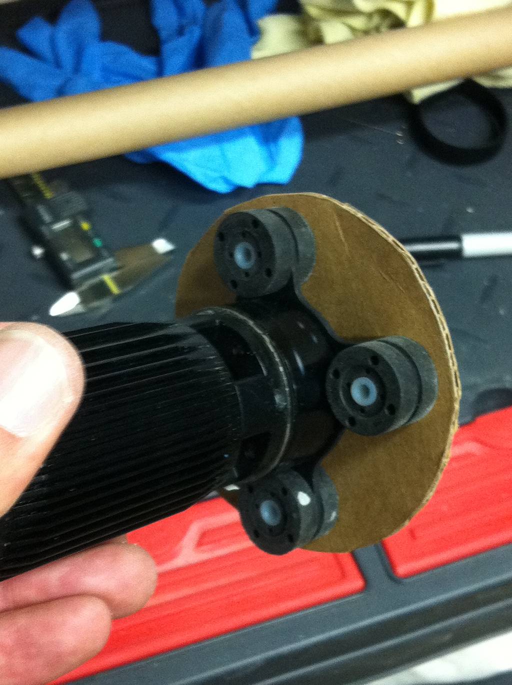

I made the firewall mount for my Neu motor. I am using the Budd Engineering mounting system. In order to fit it into the Nuance I did a simple test fit with a cardboard firewall. I estimated the location of the firewall by a quick trial fit of the motor and spinner. I measured the diameter of the fuse at that location.
Luckily, in the area where the firewall goes for this mount the fuse is nearly circular in shape. So I started with a 92mm cardboard disk with a 27mm hole for the motor. I trial fit this and trimmed it and then used it as a pattern for a lite ply disk. I stuck a depron disk on the back of my spinner to act as a spacer. I wanted to leave plenty of gap room since the thrust adjustments for this motor will be done behind the firewall. That will pull the spinner closer to the nose when I add space washers for thrust adjustment. I made the ply disk using my cardboard pattern and then sanded it to fit.
Once I was happy with the ply disk I laminated 3oz CF onto it using my Reynolds Handi-Vac and ziploc bags with the check valve. That's the best re-purposed tool I have found.
I'll take more pics when I mount it with Aeropoxy.
By the way, I should point out that after I mount the firewall then I will enlarge the opening for the motor gearbox to pass through. It shouldn't touch the gearbox, but it makes it a lot easier to position it for fitting and aligning. I'll remove material and open it up, leaving some area around the rubber isolators.

I looked at those, but decided to go with the stock approach. I was skeptical as well, until I put it together. The servo fits very tight into the ply brackets, no side to side twist. The zip tie is pretty tough and holds the servo well. I made a mockup of the strap and screwed it into my workbench. I couldn't rip it apart. Maybe it will get brittle over time or stretch. I'll keep an eye on it. Its easy enough to replace if it loosens up, but I really don't think it will. Its simple to test it out, just screw a zip tie to your bench with a couple socket head servo screws. Then throw your back out trying to lift your bench up.
I glued in the firewall tonight. The hard part is over. Its all down hill from here.....
By the way, I have a question for those that use the Budd soft mount. How tight do you torque the thing down? All the way till the SS washers are compressed onto the nylon inserts, or do you leave some room for movement? I torqued it down all the way.

As for the Budd mount, I've used em for years.. They will tighten down pretty tight and stop (or feel really tight) when they bottom out of the white nylon spacer. It's whole purpose.

Make sure you use the proper allen wrench though. If it's even a little small, they screws will strip out. I usually hold the allen wrench stationary, and use a socket on 1/4" drive ratchet and turn that.

I think I'll just use some standard SS socket head screws. I have never liked the button head screws for the reason you point out. I bought some SS washers of the same size from McMaster Carr so I will put those large washers as my thrust spacers as well as on the screw head side and locknut side of the mount. I like having the area of the washer to spread out the load so I don't crush my ply/CF.

I fully agree on spreading out the load. I like the washers with the Budd Mounts. It's funny, Jerry uses aluminum can metal for his spacers to get his thrust right. I can't tell that much difference. hahaha
