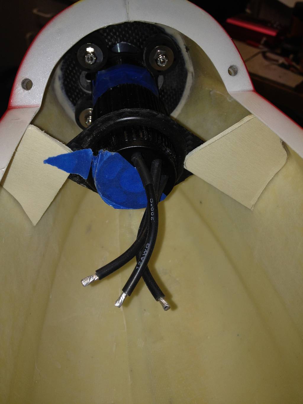

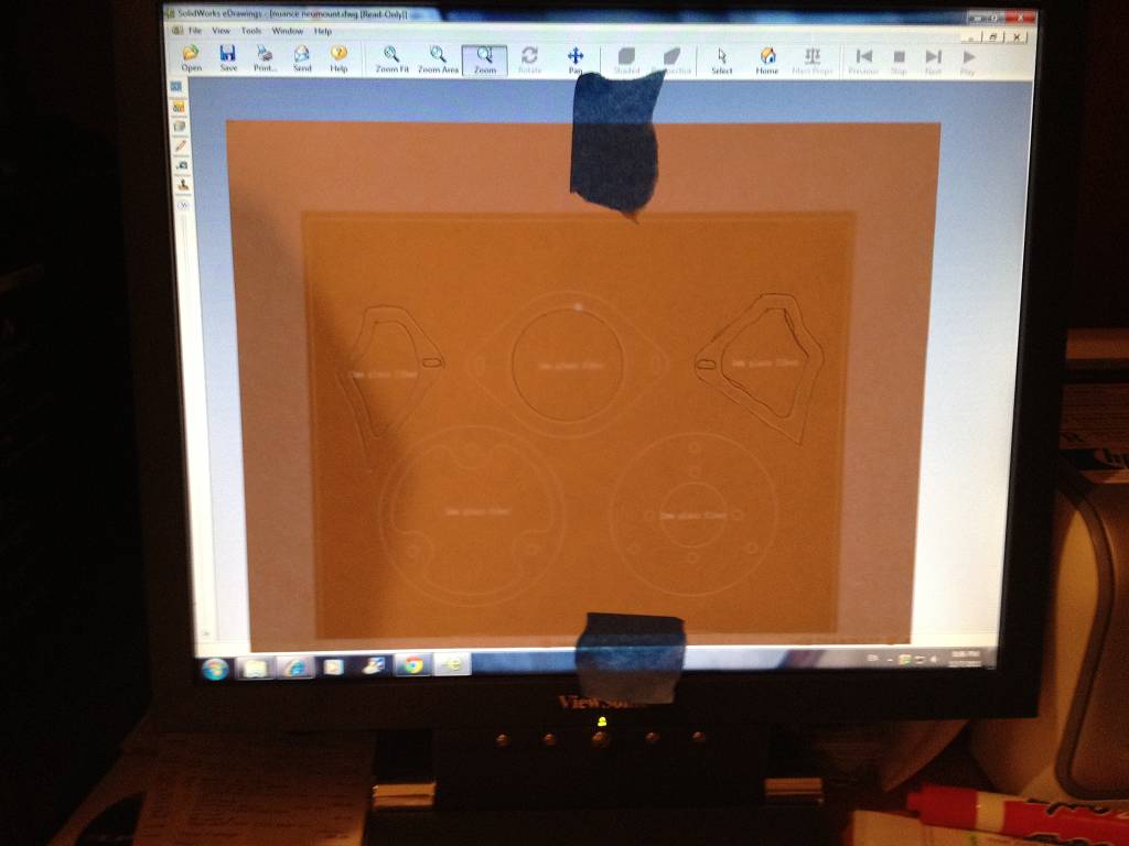

For the tail ring installation I used the template that was uploaded here:
http://rcone.kr/board/index.html?id=bjreference1&no=13
I downloaded the zip file version for the Neu motor. Even though this drawing set is for a hard mount installation, the tail ring support will be the same no matter what mount you use. It is a .DWG file so you need a viewer to open it. I prefer to use this rather than the JPG file that is also uploaded. If you want to get the viewer, go here and download the e-drawings viewer. It will allow you to open and view most CAD drawings, including Solidworks and Autocad. http://www.edrawingsviewer.com/pages/programs/download/ Its Free.
Once you have the JPG or e-Drawings file on the screen, then zoom the picture so that the tail ring opening is about 47mm on your screen. That's actual dimension of the tail ring opening, without the tubing, for the Neu motor housing (new version).
I taped a piece of paper on the screen and traced the shape of the tail ring support brackets.
I cut them out from the paper and did a fit check in the plane. They fit great.
I traced them onto a piece of lite ply and cut it out. It fits. I just need to trim them down a bit where they mate with the tail support ring.
It only took me about 15 minutes total time to do this. I would have been having fits trying to get the complex shape required to fit the tail ring supports, but the template made it very easy.
Next, I'll open the support brackets up a bit then laminate them with CF. Then glue in place and DONE.

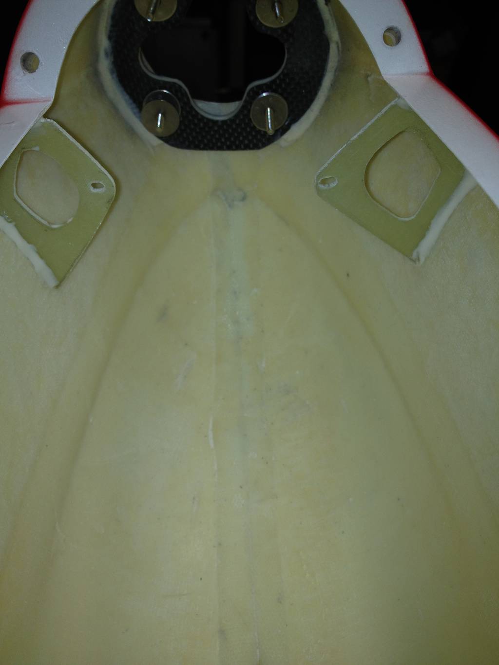

Here's some quick updates. The build is going well. In general, everything fits and lines up straight.
I decided to make the rear motor mount support from FR4 rather than CF laminated ply.

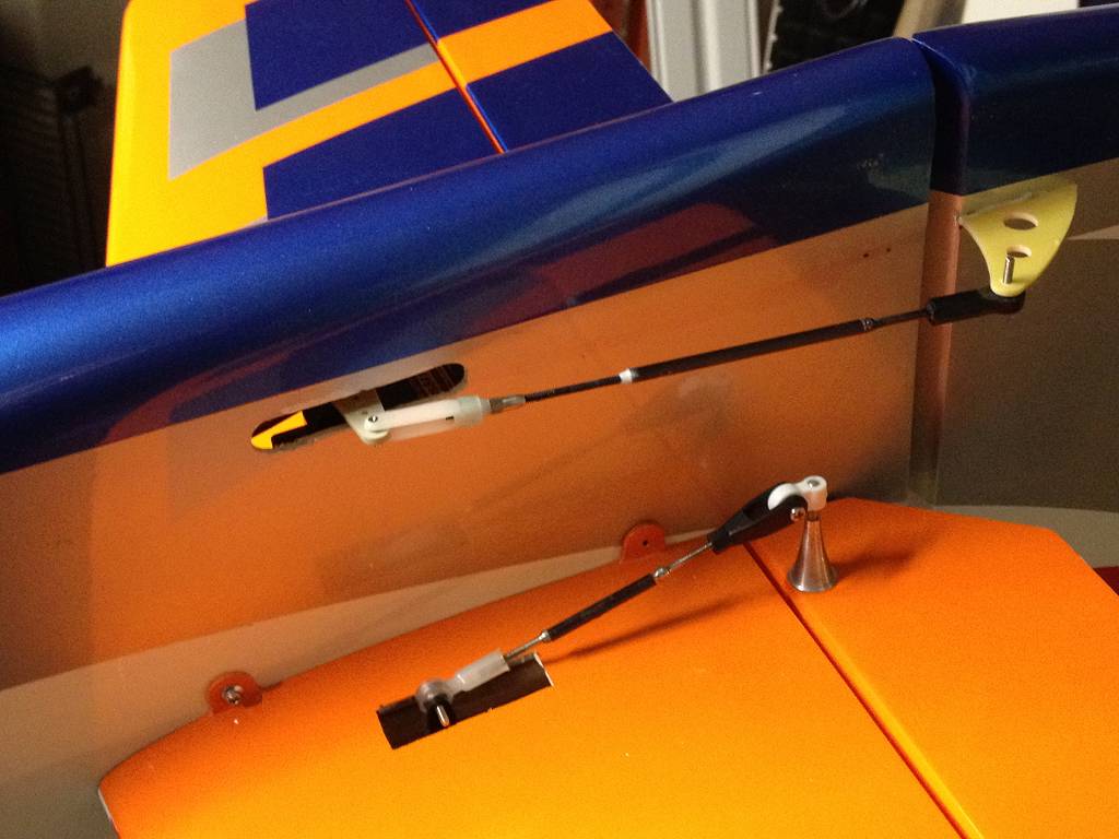

Hi Steve, I've just got a couple of questions to ask about your Nuance. With the rudder servo arm/linkage modification you installed, how much rudder throw (degrees) did you end up with and where can I purchase the FR4 material you used to fabricate the rear motor mount support? It appears to be a really nice plane at a great price. Thanks, Everette

I'll measure the travel on the rudder. It might be a bit before I do it since I moved the fuse aside and am working on the wings now.

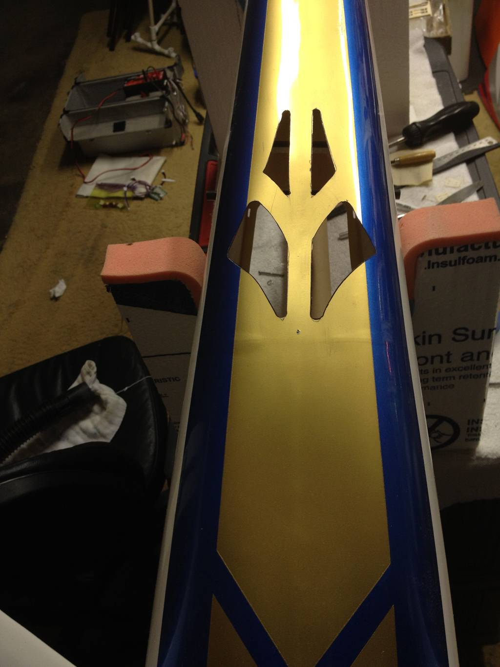

I cut out the air inlet and exhaust holes. This is certainly a step which I wish the factory had performed. Its a pain, but with the provided templates it isnt all that hard. I traced the template outlines and used a small dremel cutoff wheel to cut to shape. The chin cowl cutout was a bit more challenging, but the templates help.
