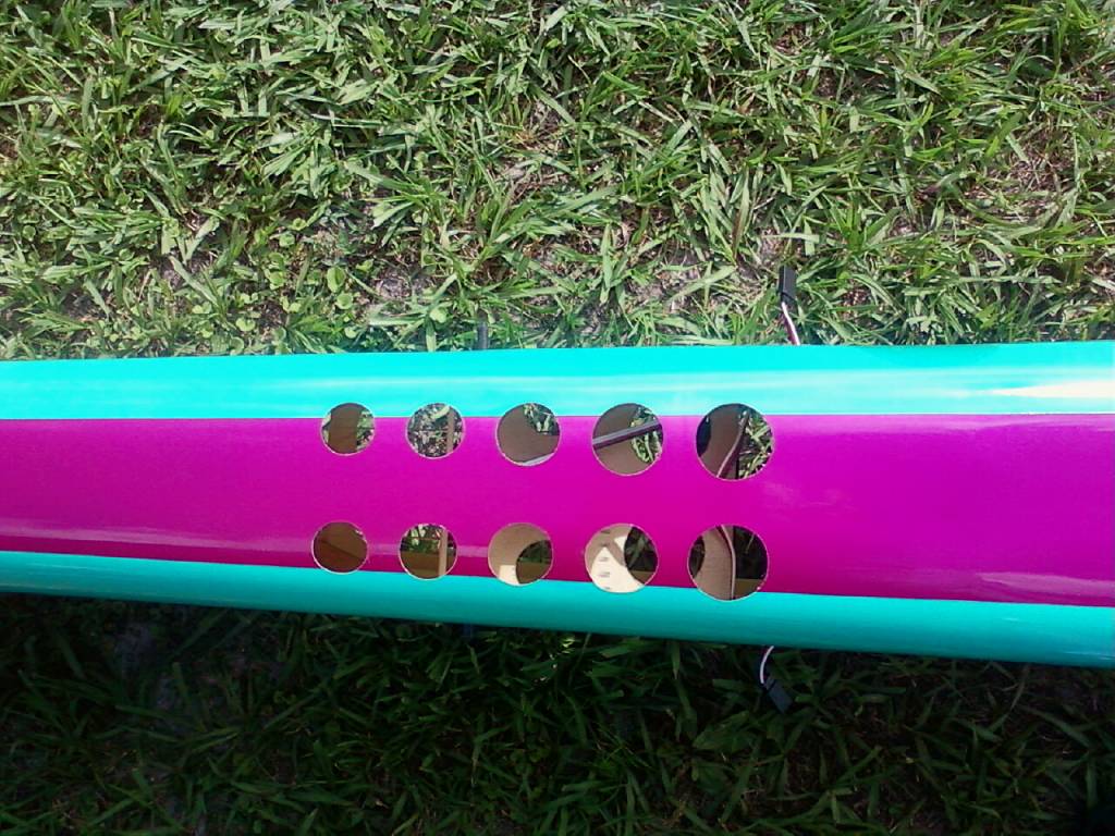

Build Photos : Last V1?
Round air exits.
