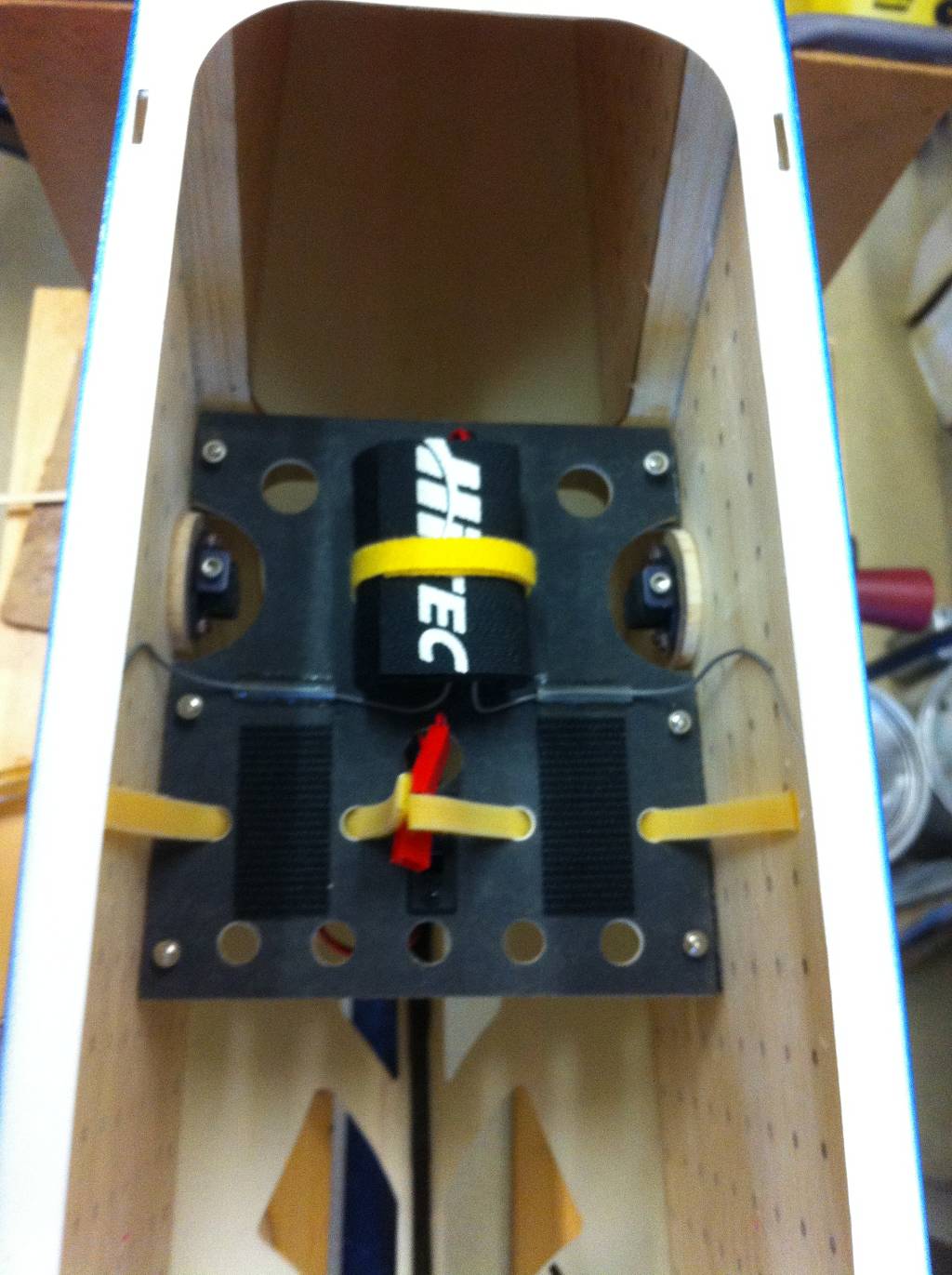

Got the Prolog done a couple of week ago, and it a great flying plane. First flight took the basic trim and small mix on down elev to low idle.
Heres the wieght final ready to fly 4749grams.
Break down
Fuse 2676 ( Pletty 30-10, Castle ice 80, arming plug,volt reg.,rx switch,trutrun spinner ,Rasa prop,and all servoext, rudder servo,ect)
rh wing 393g (Jr 8411 servo with 6 in ext)
lh wing 390g "
wing tube 60g
sub total 3519g
rx battery 40g 800ma
10s pac 1190g
Total 4749g
I use standard hardware didn't go out looking to save any wieght. Use Jr's 8411 servo on rudder and wings,3421 on the evl.
Plane was easy to built. Rolls with this plane are effortlessly, had an FAI pilot fly it and he said that he could fly p13 as it was set up.
I will ahve some pictures latter on of set up.

Linkage that was use Seacrest hardware from F34 Unlimited.
elv. likage rod 60mm servo arm 20-25mm
rudder 120 my servo arm come out 145mm from rear end of fuse to center of servo arm (servo arm 1in long)
air 80mm servo arm 20-25mm
the CG calls for 260mm from rear corner of canopy base with a range of 10mm less or plus 30mm. I end up at 305mm or just forward of wing tube.
Battery tray end up with two inch of the tray forward of land gear .

from the rear lower corner of the canpony forward, 260 like they call for should put you aft of wing tube. At 270 you will be right at back side of tube , I started out at 280 and believe ended up around between 270-275mm, not quite center of tube. Which motor are you using. Like you said at center you'll be safe.
Jr

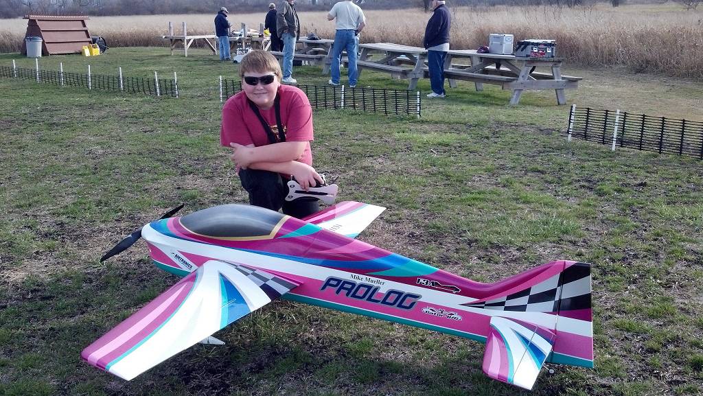

Guys after thinking about this for a bit I thought the Prolog could use a minor facelift. We tested the new canopy on our Prolog Version 2 today. The new canopy that we got this week from the factory looks and works great. The only difference Brandon and I could tell is the plane rolls even better now. It rolls like the Nuance but has the soild stable feel that I've grown to love on the Prolog.
It'll be a while but we plan on bringing the Prolog V2 to market with a modified paint scheme in the not too distant future.
We are looking into making the canopy's available as a refofit for those who would like to do this upgrade.
Thanks, Mike Mueller

I like that canopy on the Prolog and I would go out on a limb and say it will probably fly the "P" program better than before.
That could end up being my plane for the "P" program?

More visable bolder colors, a new sleeker look with the canopy which is also a slight aero improvement and a new further forward UC.
It'll take a bit to get the wheels in motion but it'll be in the works soon enough.
Victor are you going to the Tangerene?
Thanks, Mike
