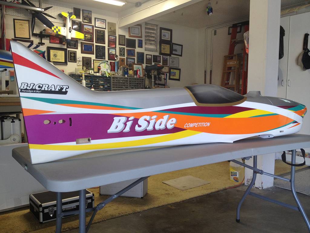

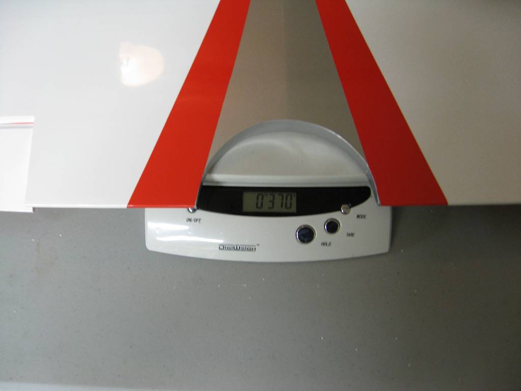

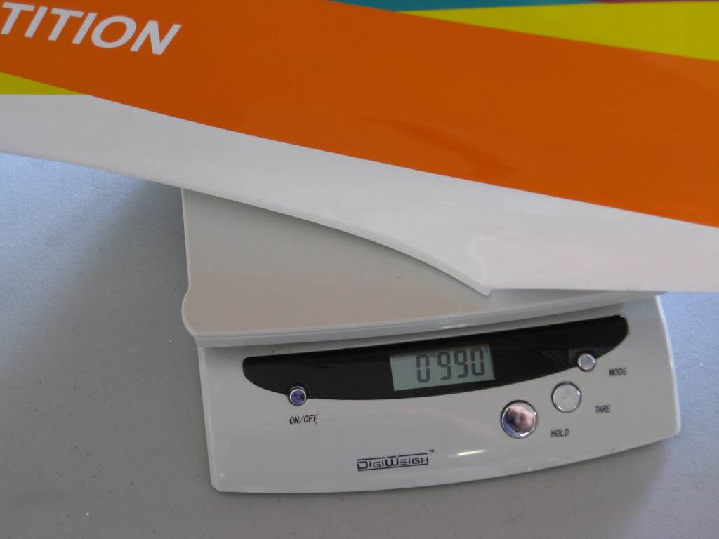

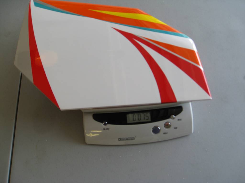

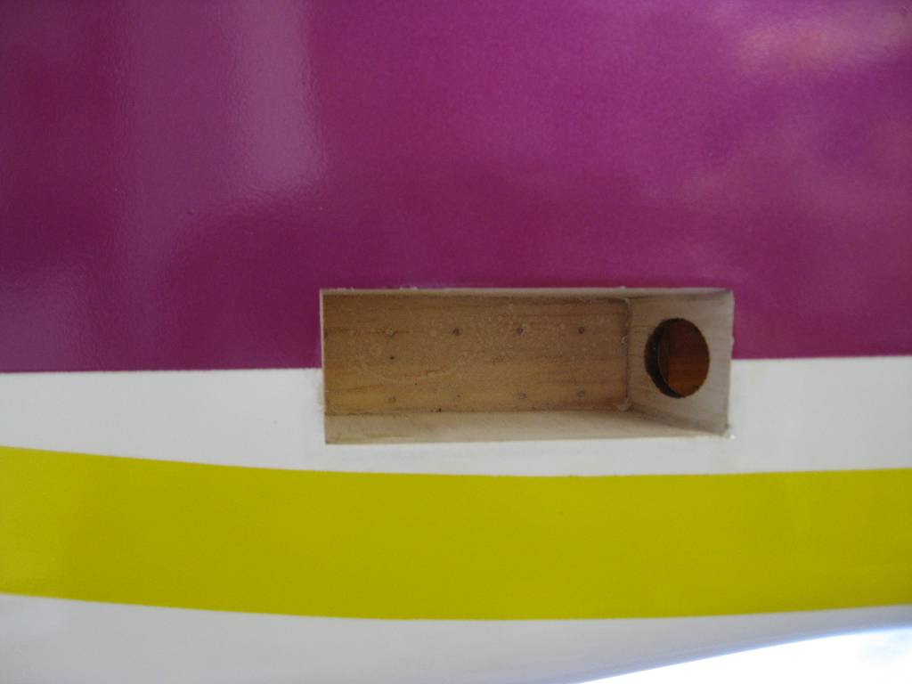

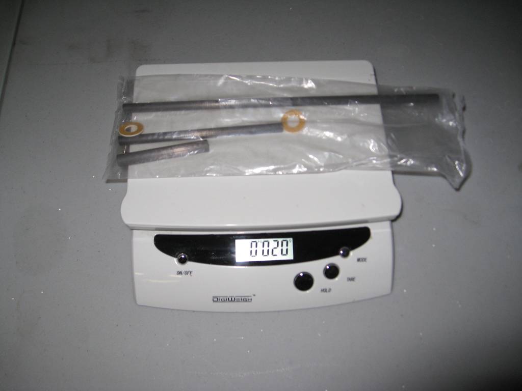

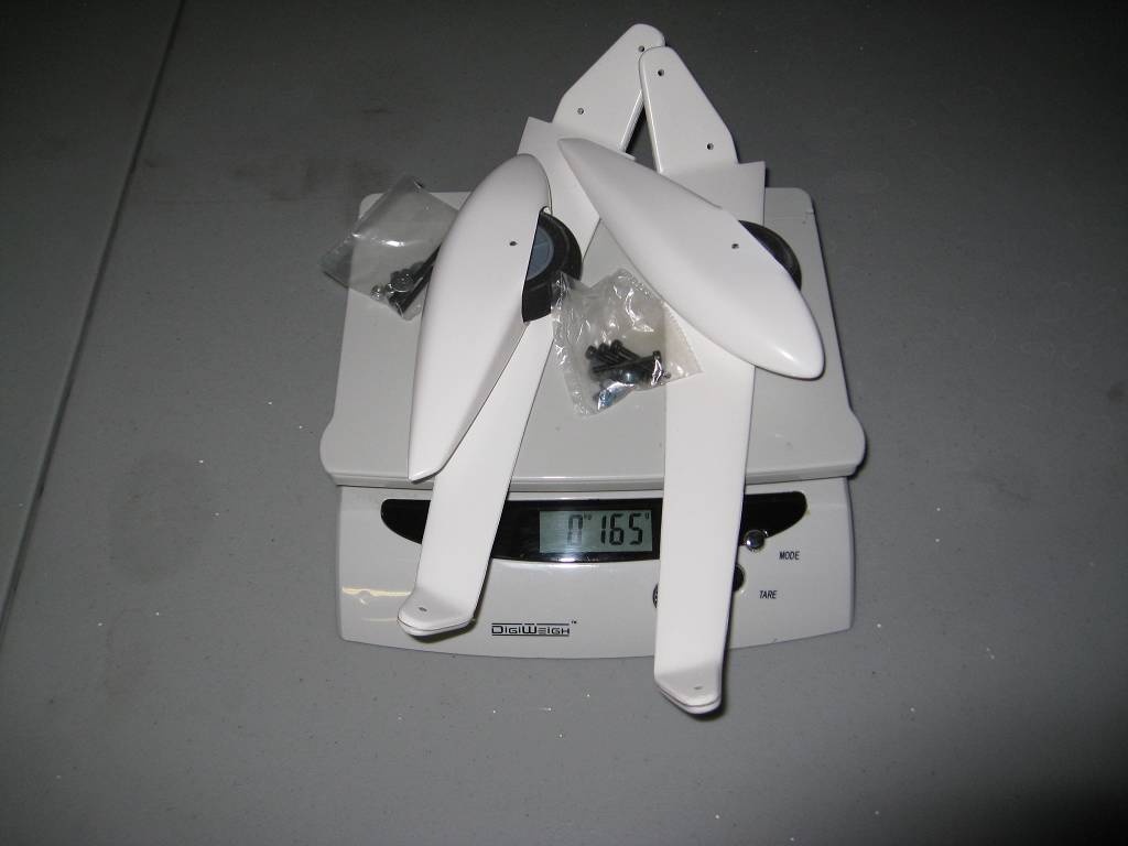

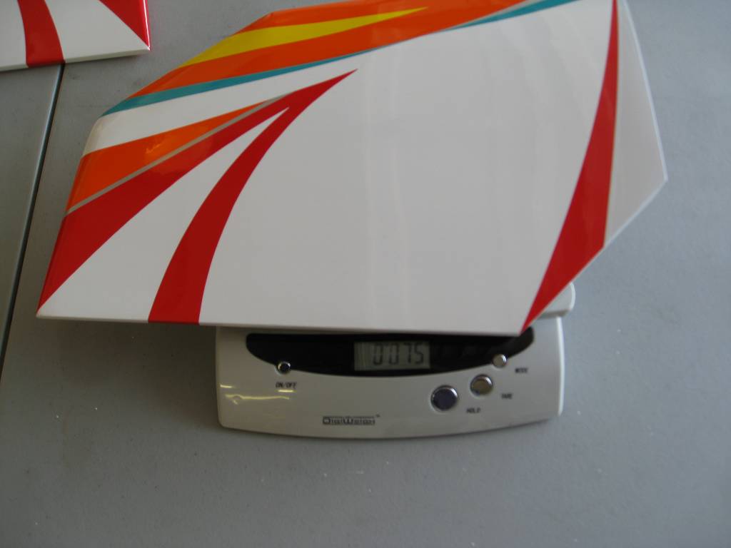

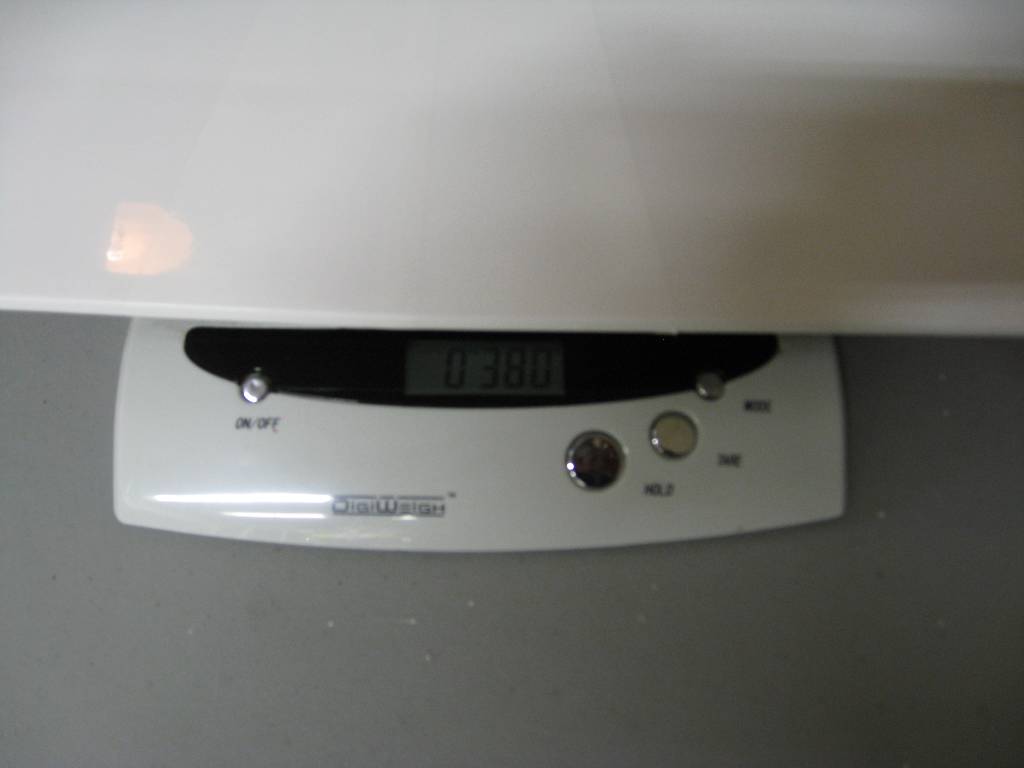

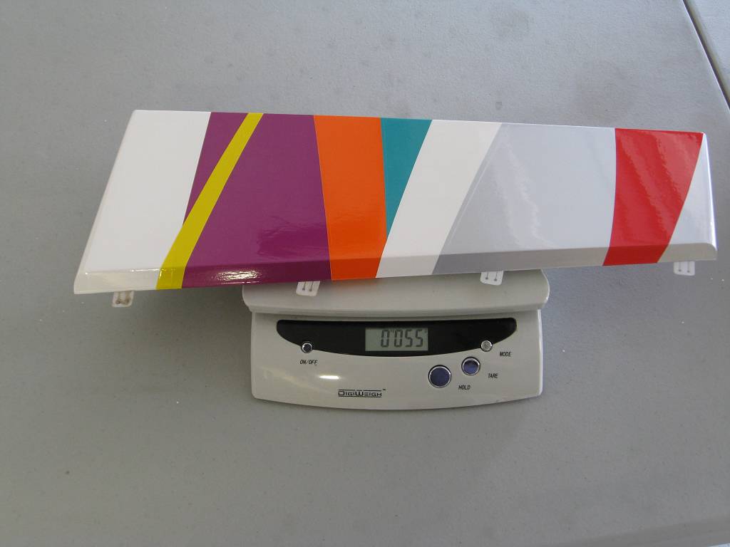

I had a chance to weigh the items and take some more pictures. Here are the weights:
Fuse: 995g
Top Wing: 370g
Bottom Wing: 380g
Horiz Stab R: 75g
Horiz Stab L: 75g
Landing Gear L&R, Wheel pants L&R, wheels L&R, axle hardware L&R: 165g
Rudder: 55g
Horiz Stab tubes: 20g

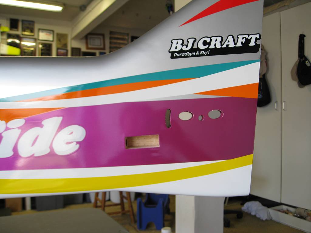

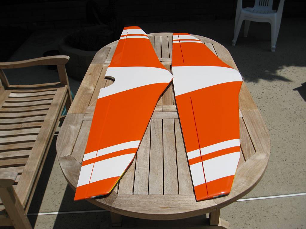

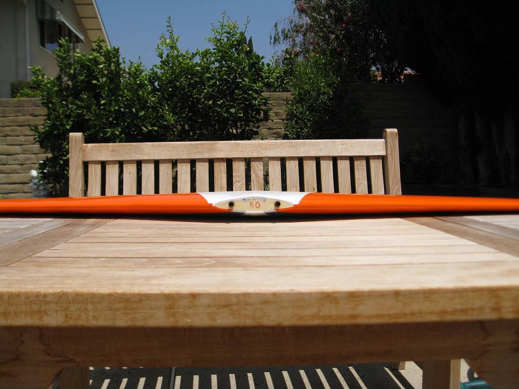

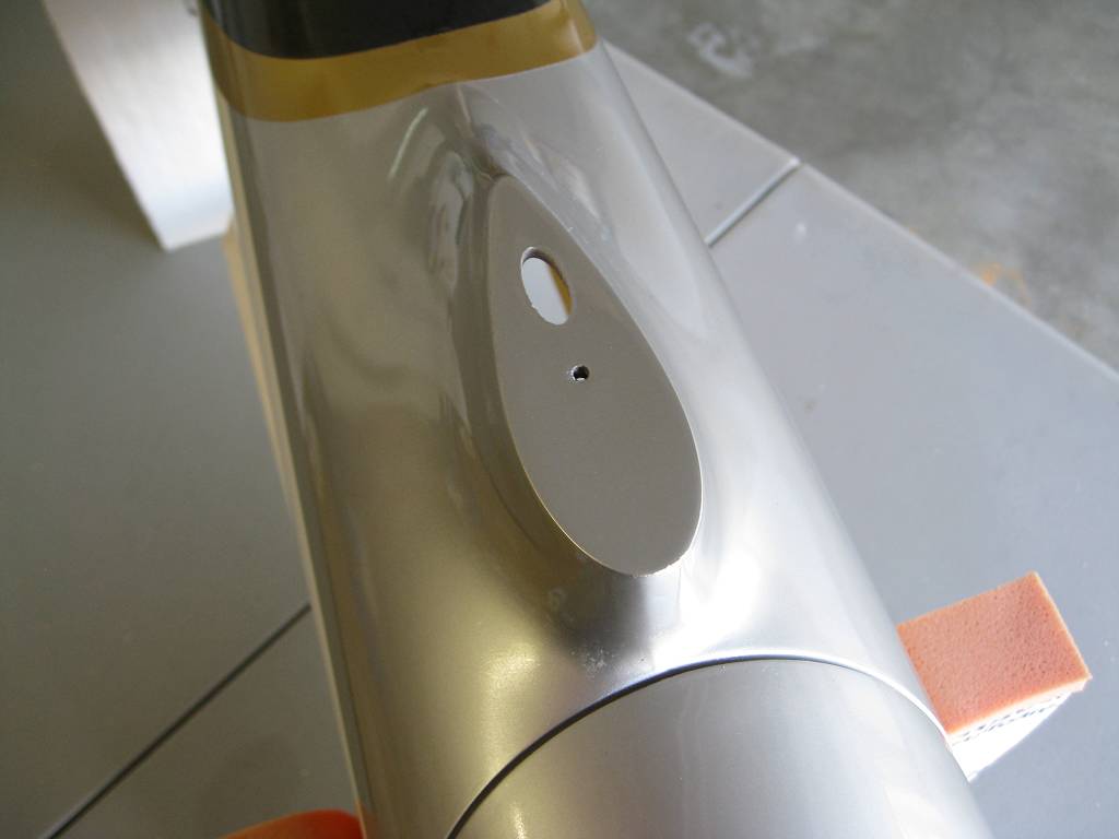

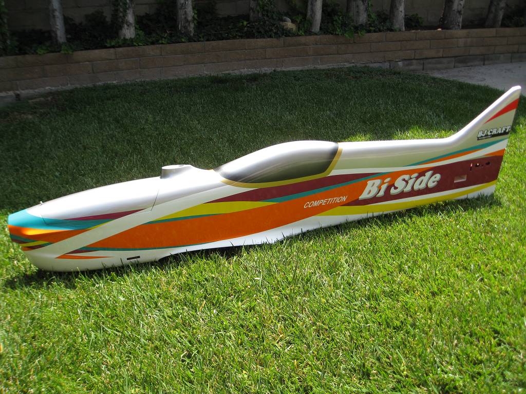

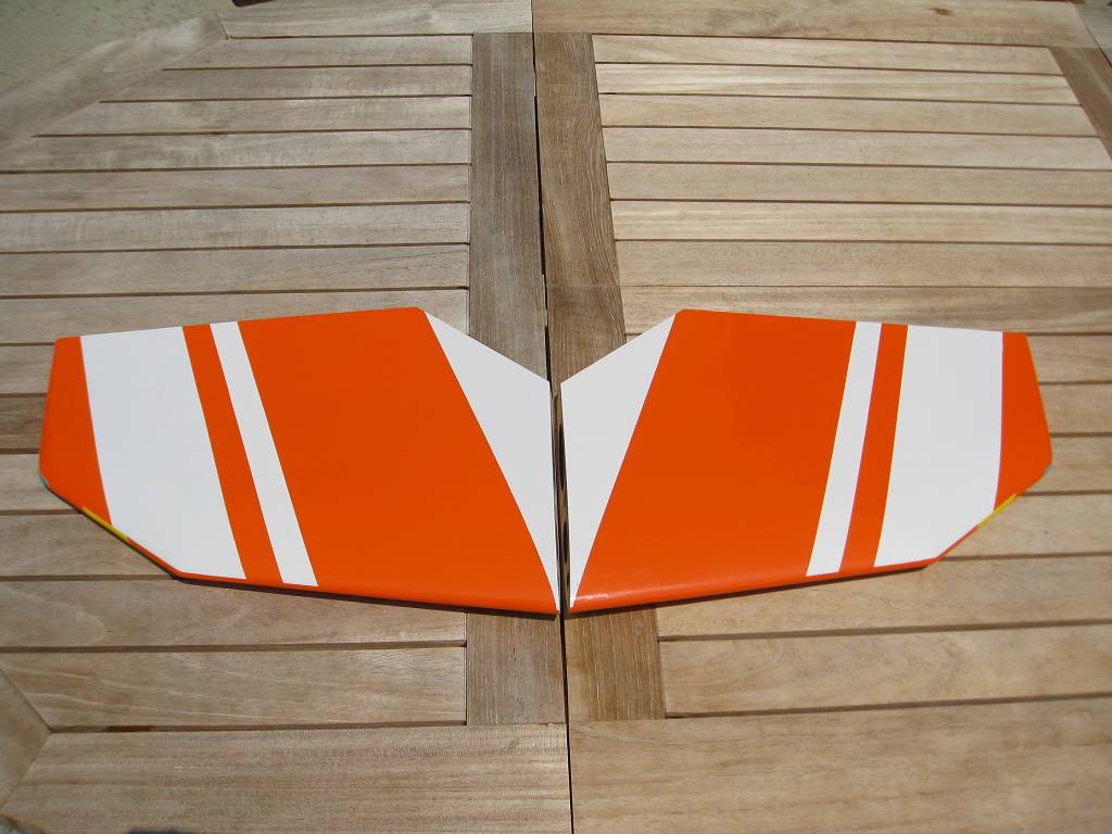

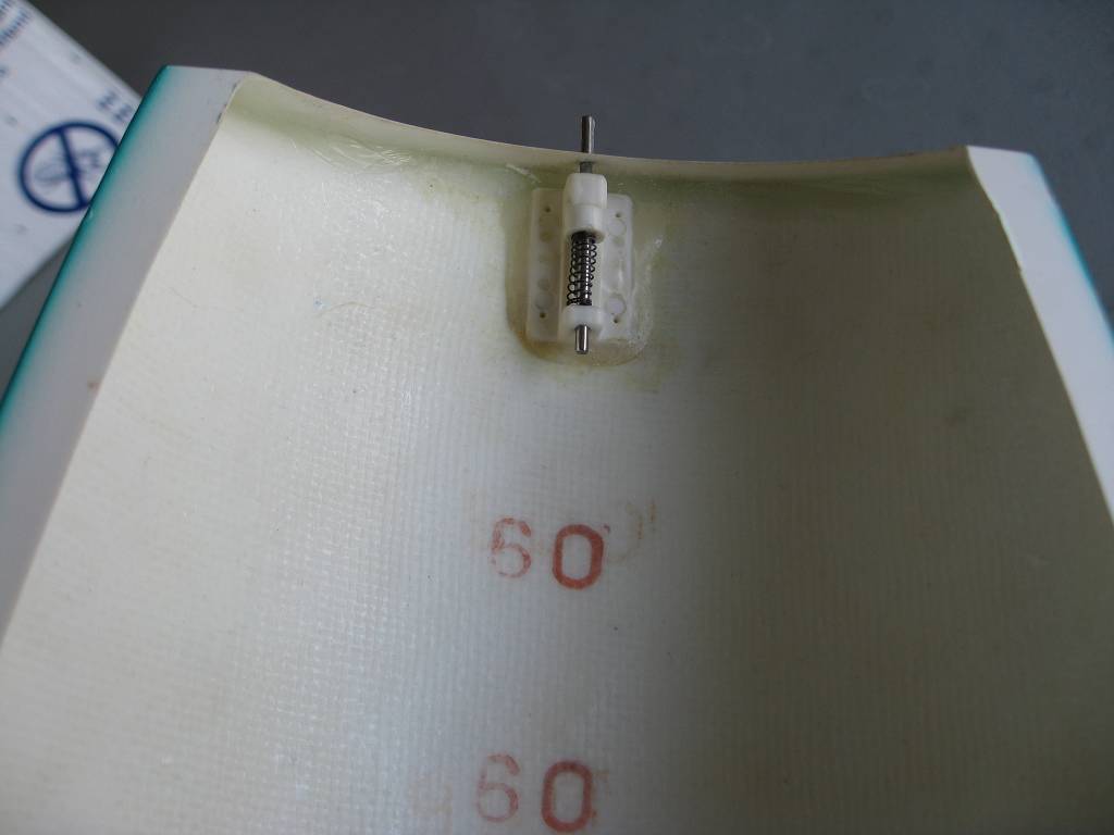

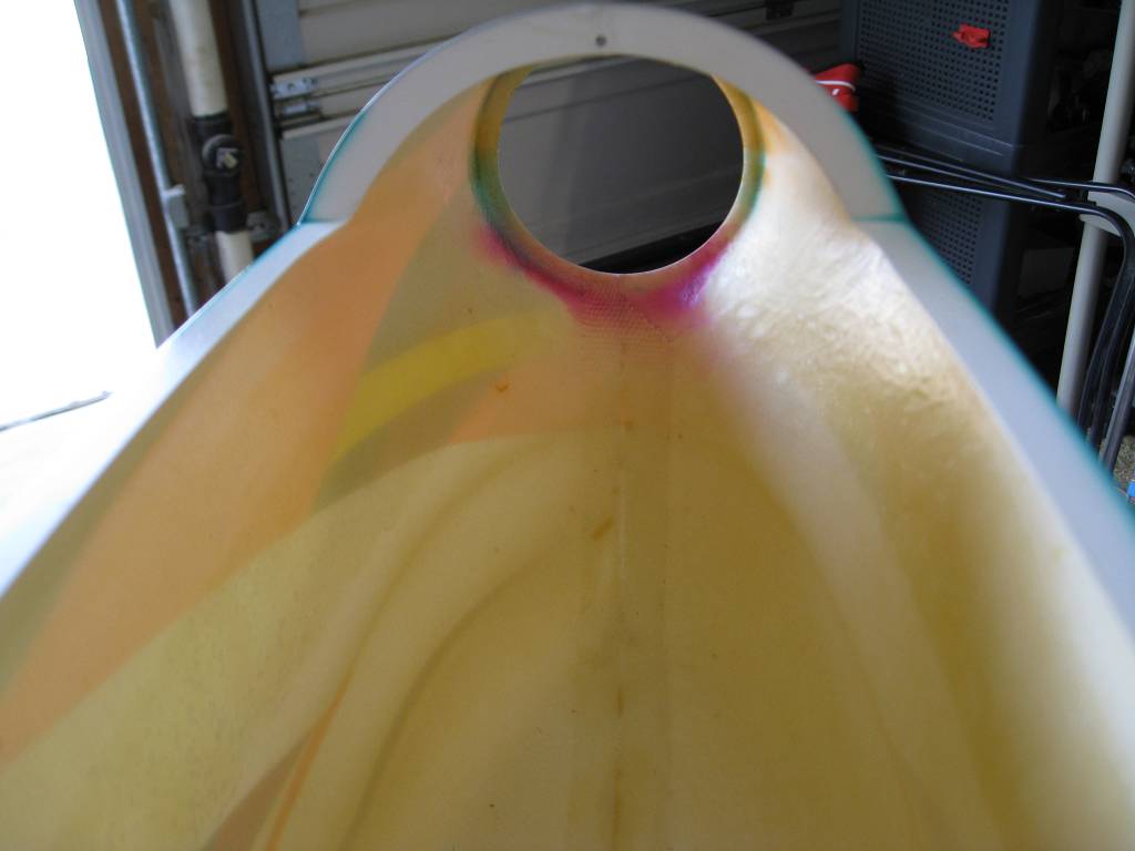

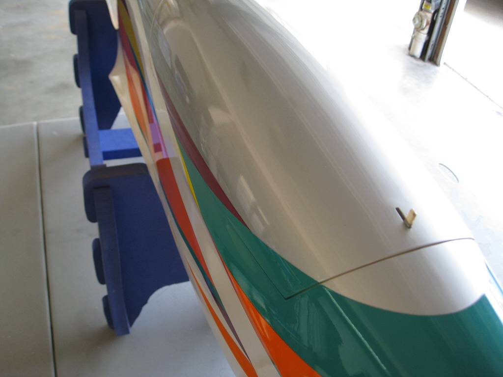

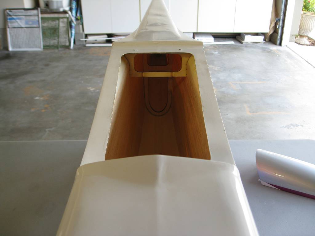

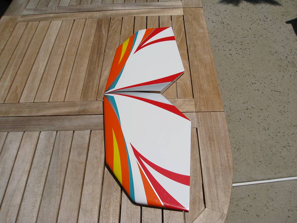

Here are some more pictures and some notes/observations:
- The Fuse is much lighter than the Episode. This is due to a different layup. He used a thinner balsa laminate and wrapped it further up the sides than on the previous models.
- The hatch fits very tightly, just like the previous models and uses a latch similar to the Nuance
- The wings are extremely light. It seems that they are lighter than even the Episode panels. Yet, they feel very rigid.
- The wing planform is very different than the original prototype. They have a slight forward sweep on the TE. The shape seems to be basically the same for the top and bottom. The Wingspan of each is 67.5"

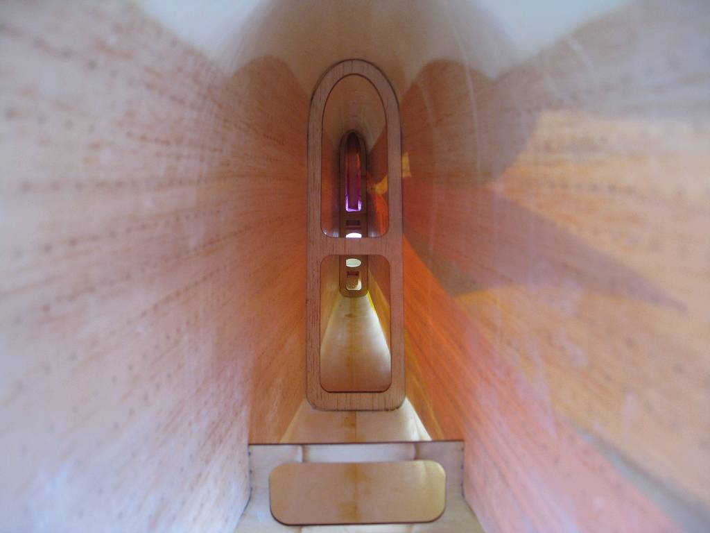

Here are some interior pics. The layup work is very nice, as usual.

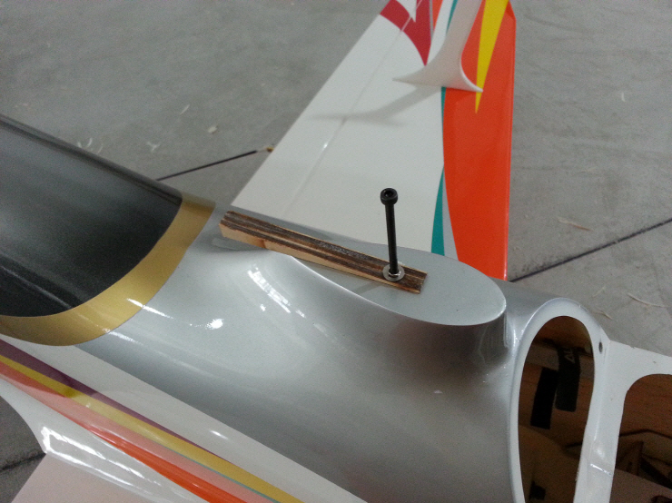

Just looking at the website and was wondering if there has been a change in the wing mounting ? see pics, is this an incidence change aswell?? looks like hes adding additional support and incidence??

Hi Niall,
Actually, I contacted B.J. regarding the top wing mount and incidence. He posted the additional pics yesterday to show the incidence change and the mounting method. He has included a shim spacer in the kit and it mounts as he shows. I find it interesting that he is adding the additional TE support mount. At first I thought it looked a bit odd, but after thinking about this I realize it is a very good idea. This will help to eliminate twisting of the wing at the root. I suppose he will eventually update the molds, but this approach should do fine.
I will install the shim and rear mount on my build.

Hi Mike/Steve
I think top wings on these bipes (F3A ones) need 2 mount screws (points) set as far apart as possible to set and maintain wing alignment, triangulation etc .
I don't think that this mod does that at all well enough. It is a small improvement on a very questionable mounting arrangement. If the wing pivots (tips to and fro) this movement will transition into twisting at the struts causing the tips to twist out of true.
The centre mounting should also set and hold the incidence at the root.
This mod will help with incidence setting but won't do a lot to stop tip 'to and fro' pivoting.
If this mod is only to change the wing incidence it has to ask questions about the quality of the testing.- the kits have hardly landed.
Don't mean to be too harsh but this needs more attention than this mod - frankly a new molding that has a seat to suit the section and two well spaced mount points is the way to go.
Brian

Hi Steve,
The problem ,as I see it, with that rear support is that it can swing.
So as the tips move to and fro it will swing side to side.
I'm sure it will help some in restricting or perhaps I should say limiting this movement.
However a small amount of 'pivot' here will be a lot of twist at the struts and/or especially at the tips.
Perhaps two carbon (or something) pins, one front and one aft set in the wing that would locate in the wing seat might help some more.

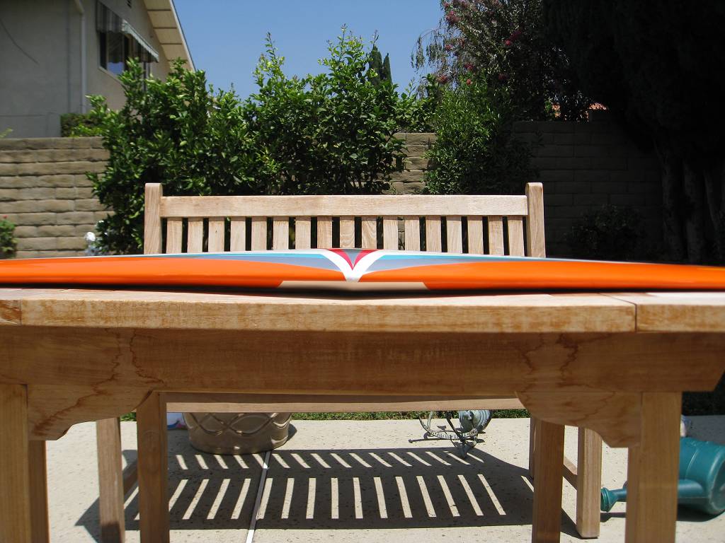

Hi Brian,
It looks like I was overthinking the modification which B.J. made. He sent a note saying that the purpose of the rear support is really just to add a brace for when you carry the plane by the top wing. He hasn't had any problems with wing pivot during testing. In fact, he had no rear support at all until just recently and he had over 500 flights on the prototype. So, I will just build mine per spec and fly it. He really feels confident about the flight performance of the Bi Side and likes the outcome.
I'll post more build info shortly.
Steve

Default Biside wing incidence
How much does the modification change the upper wing incidence?- it looks a lot. Does anyone know the incidence on the lower and upper wings?
CW
