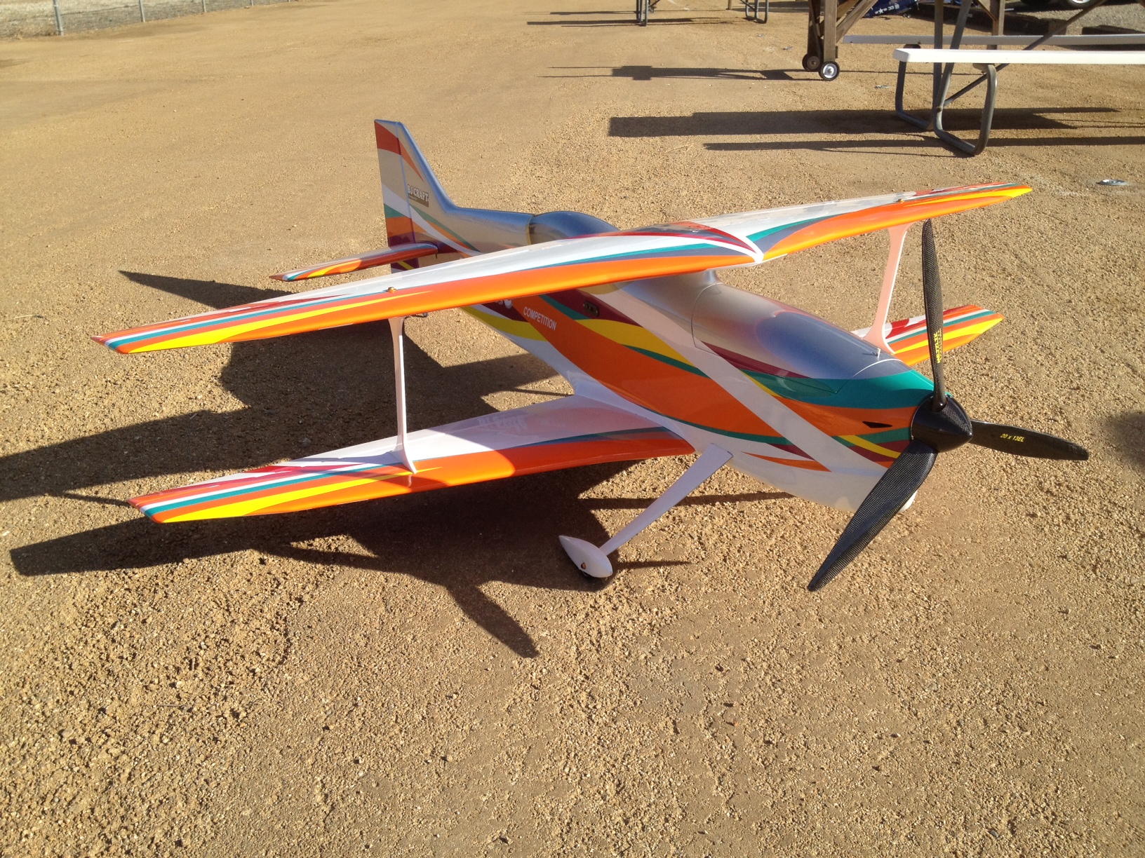

I had a chance to try out the Mejzlik 20x13 EL 3 blade this weekend. I was pretty impressed overall. It had a slower downline (downlines were already pretty good) and a very constant speed. I will continue to fly it and compare it with the Falcon 21x13.5 2 blade I was running. The weight of the prop is very similar to the Falcon, maybe 10g heavier.
My impression is that it rolls slightly better with the 3 blade and feels even more solid in flight. I did notice that I tended to burn more power per flight because I was trying to fly at the same speed as the 2 blade. I will need to adjust to the slower pace and then the power should be comparable to slightly higher than the 2 blade.
We had some fairly windy conditions yesterday so I was able to see how it handled the wind. It did great.
More to come on this.
Steve

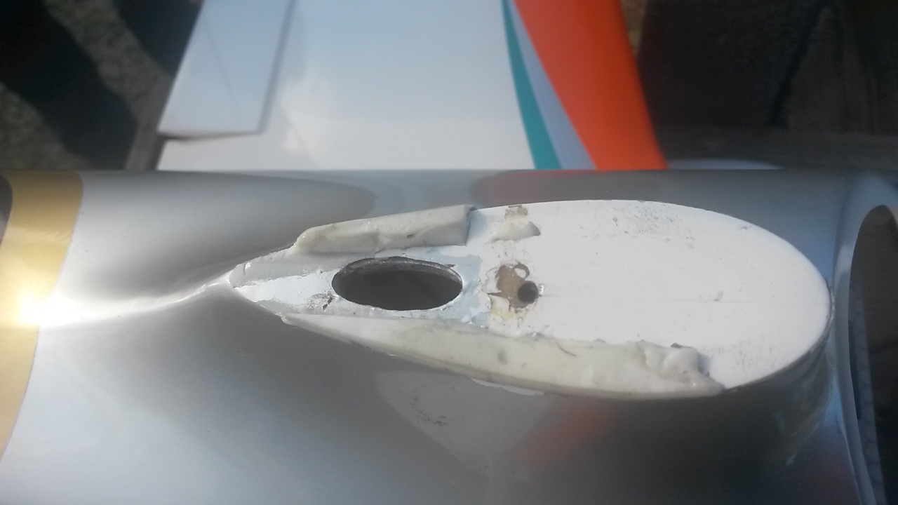

corresponding the fixing of the top wing on the pylon:
Has anyone found an other way as BJ suggested ? I really would like to fix the top wing with 2 srews.
Also it would be good if the top wing would be not able to move on the pylon during building together the airplane for flying.
Regards
PW

It is a bit difficult, but it gets easier the more you do it. I have a pretty good method which goes quickly. I set the top wing on the pylon with the center bolt protruding several mm. Then I locate the hole in the pylon with the bolt and get it started in the blind nut. Then I seat the wing into the cabane struts and partially tighten the cabane bolts. Then tighten the center bolt and then the cabane bolts. The hardest part is locating the pylon bolt hole. I marked the hole location on the pylon so I can see it from the side as I put the win on. It makes it a lot easier to line up the bolt with the hole.

JR Varela made a fillet on the "company plane" that is on the center pylon. The ply spacers sit in a groove in that fillet. Makes it easy to align and doesn't allow the wing to pivot. I plan on doing that on mine as well. Very slick and makes putting the top wing on very easy.

correct: to find the hole on the pylon to fix the M3 srew is tricky.
Arch:
Do you have a foto from this methode of JR Varela ?
Regards

PW what I did to the Biside is, I use some petroleum jelly on part that I didn't want to be stuck and used some wax paper on the buttom of the top wing . I put the wing on where they belong . I mixed up some 30min epoxy with some microballoom force some of the mix around the gap filling the open between buttom of top wing and the fusage. Once it set up it will keep the wing from rocking sideways, since it spread the area that the wing sit on. Beware make sure you coat anything you don't want to be glued with the petroleum jelly or something that act as a release agent..
Jr Varela

Here is the fillet JR made. Not a great picture, but couldn't figure out how to take a better one. You will notice that it isn't symmetrical. The other half stuck to the wing when he made it. It's not a bad thing though as it makes it almost keyed, so it goes together even easier.
Arch
