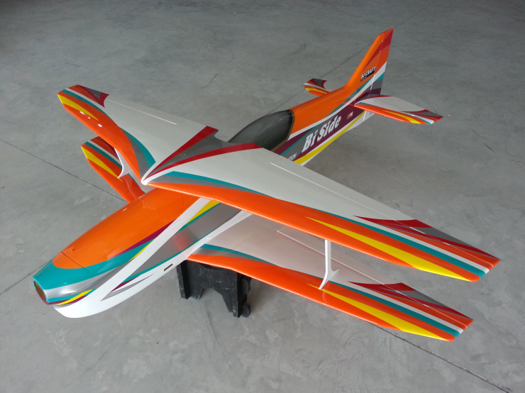

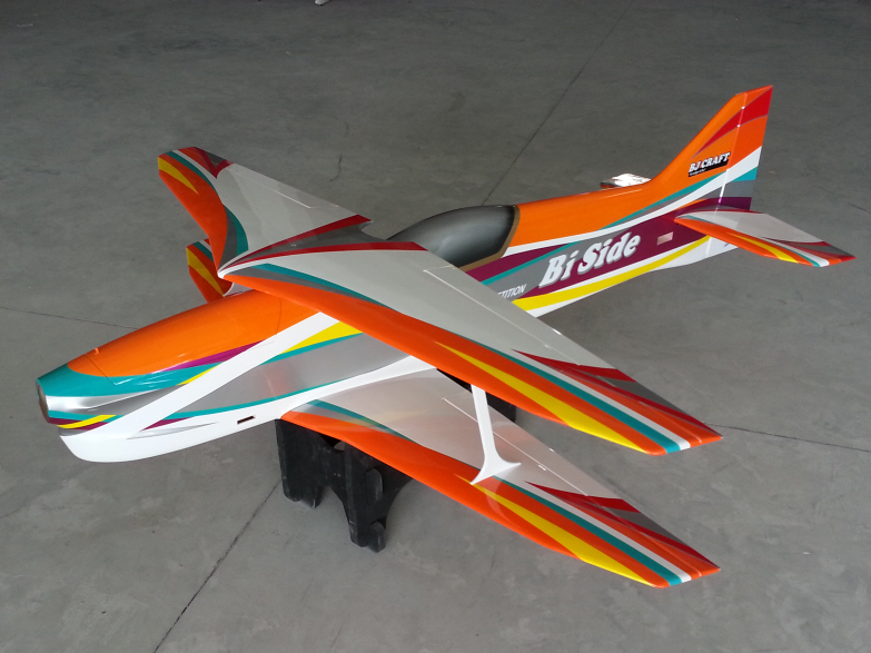

Another nice color scheme at the Biside.
From the original scheme, only the silver is changed with orange and a little more silver at the wings and tail.
Found at Lorenz Modelltechnik Germany, shipping worldwide at attractive prices.

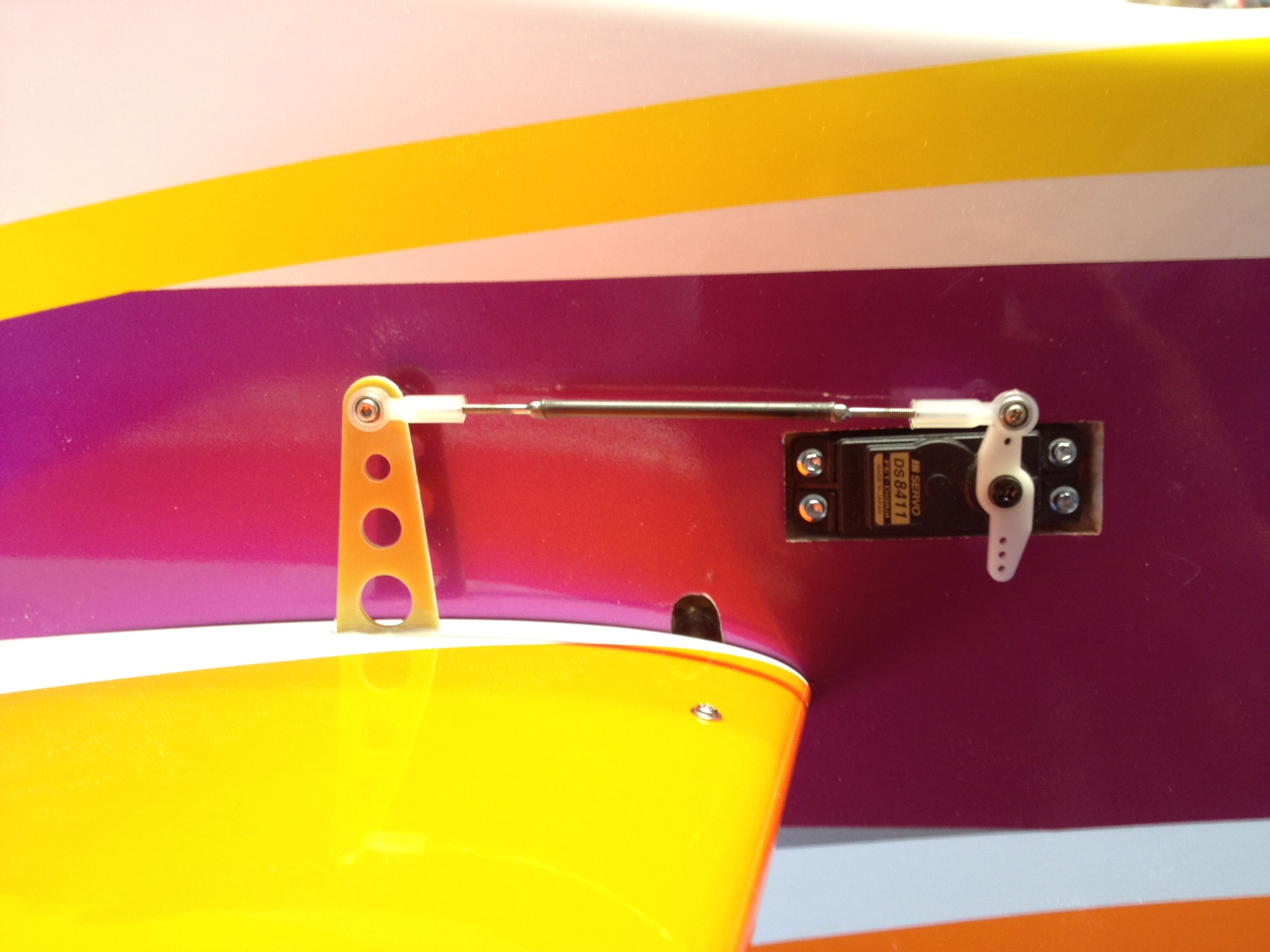

I think the most unique thing about this airplane is the flying stab. It has a very different feeling to it than a conventional elevator. I remember discussing this with B.J. and he told me that when flying a loop you do not need to modulate the elevator input as you would in a conventional elevator. Normally, when flying a loop you begin by feeding in elevator then you relax it a bit and then feed more in etc. as you fly through the loop. With the flying stab you do not fly the maneuver the same. Basically, you modulate the elevator much less than you would with a conventional setup. I found that I would set my elevator input and then vary throttle to fly the round loop segments. I still modulated elevator, but much less than I was used to with conventional elevator control. I found that I was initially flying loop and loop segments like I would with a standard elevator and it just didn't feel or look right. Then I remembered our discussion and began to use the elevator as I described. It has a very nice and solid feeling. This is a whole new element for me. I really began to like the feeling, but it does require some getting used to.
It is very important, I believe, to follow his setup recommendations to the letter. I set mine as he described with a servo that meets the basic requirements. I used the JR DS8411 (with plastic gear set), put the pushrod at 17mm location on the control arm, placed the elevator control horn in the stab such that the clevis hole was 45mm above the stab, set the throw to 80%, and used NO EXPO.
Here's a pic of my elevator setup:
I felt that the elevator control was extremely solid. I never had any feeling of overshoot or lag. It is not overly sensitive around neutral but has a lot of authority.
