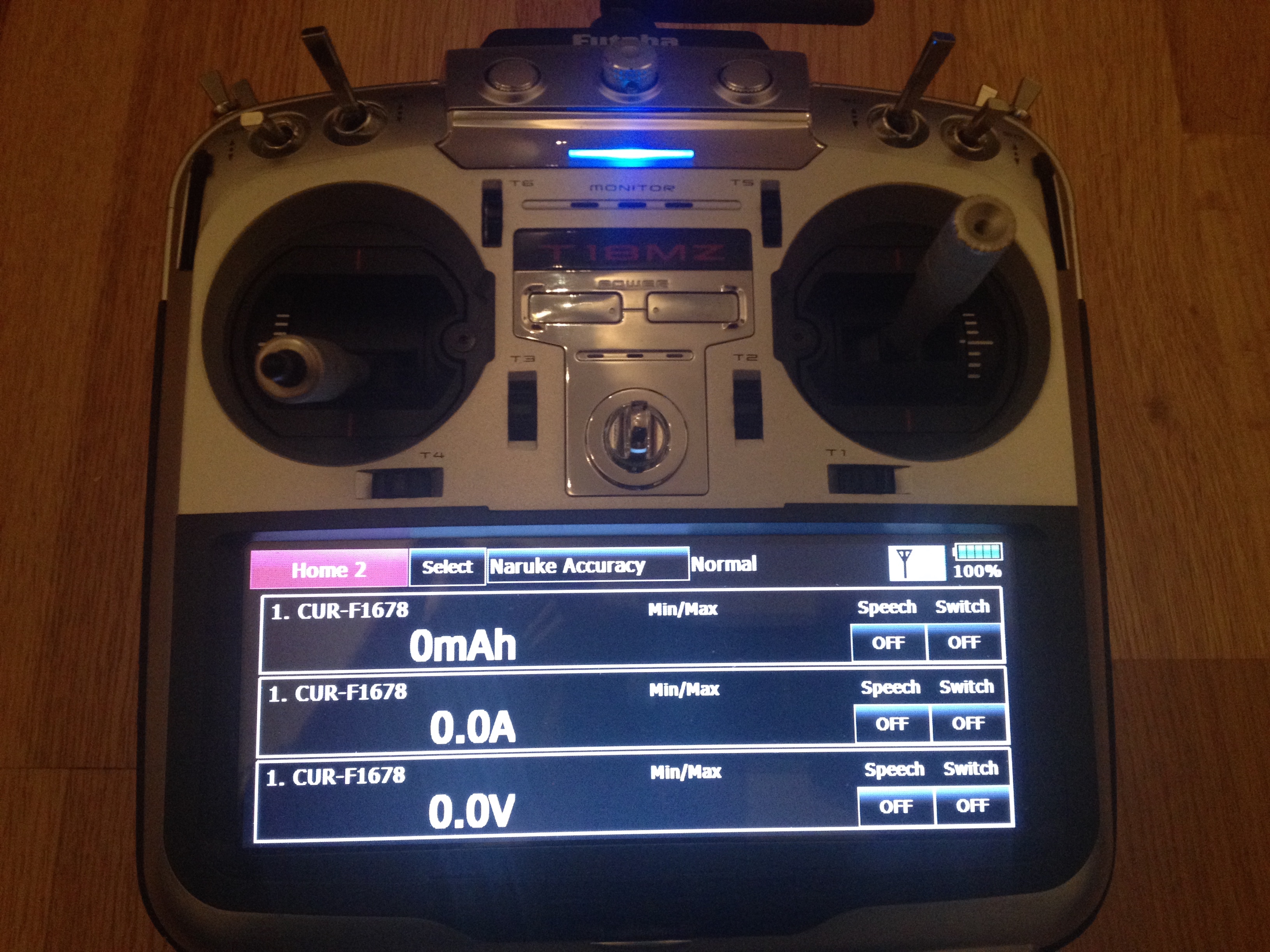

Hi,
Although You have already the Jeti telemetry components it maybe can be of interest that one can select another path with Futaba 14MZ when one want some telemetry and it is to get a Robbe/Futaba Telemetry-Box
http://www.robbe.de/telemetry-box-2-..._from_store=en
With this receiver
http://www.robbe.de/empf-r6308sbt-fa..._from_store=en
I use above and use the Robbe/Futaba current sensor
http://www.robbe.de/stromsensor-150a..._from_store=en
And the voltage connection lead
http://www.robbe.de/anschlusskabel-e..._from_store=en
That gives me the important things I want to keep track of in the air: mAh consumed in LiPo flight battery and alarm when limit I have choosen is reached, and voltage of LiPo flight battery. I also get alarm on low voltage on receiver battery supply.
It works fine but I sure would like a transmitter with built in telemetry support, but my Futaba 14MZ will have to be in use some more years before I get a new transmitter (18MZ or what is avaliable then as a good choice for me).

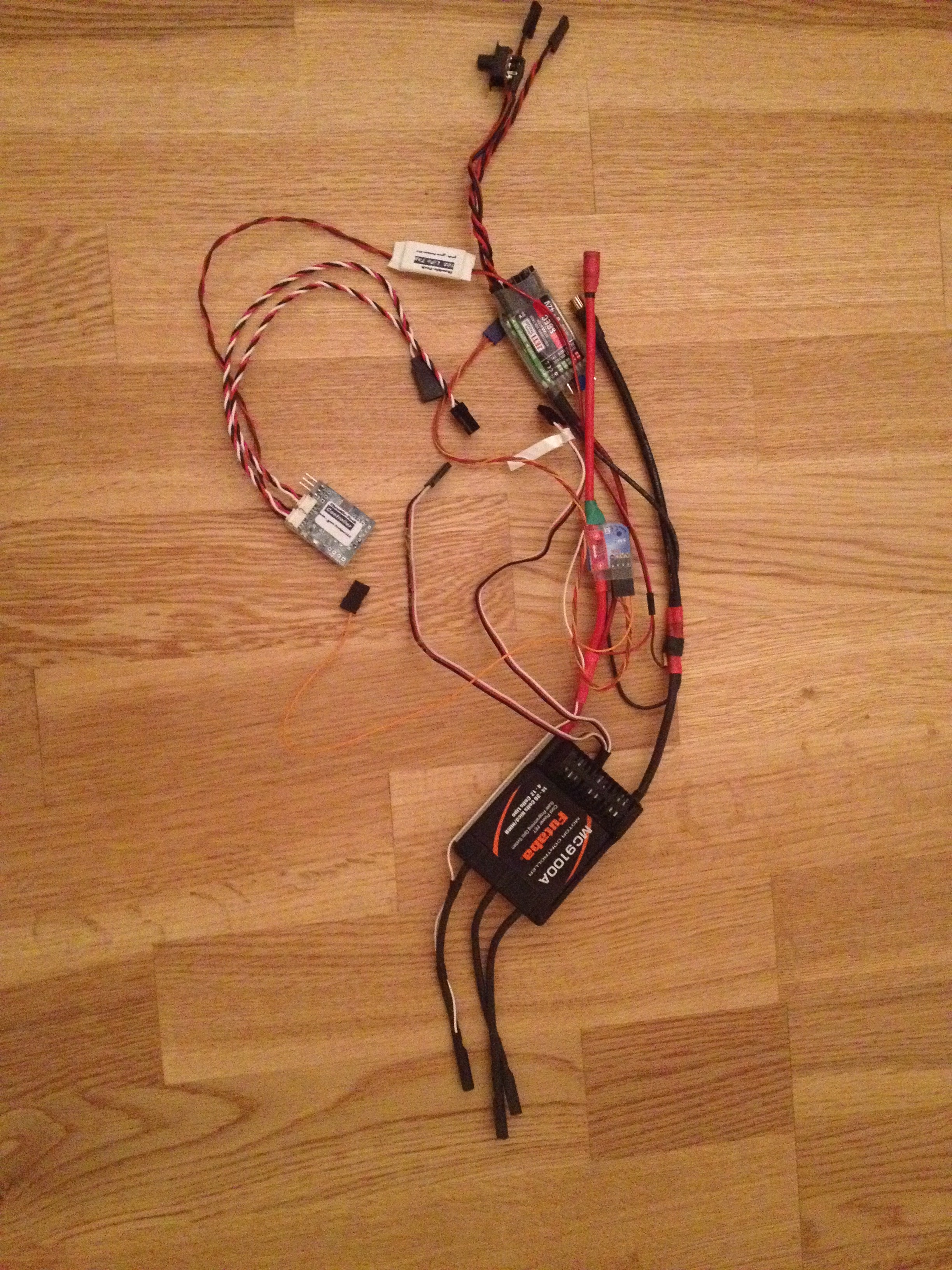

Joined: Dec 2012
Posts: 15
From: KIEV, UKRAINE
I played a bit with my Jeti stuff.
My current setup:
* Jeti Mezon 90 ESC Lite with BEC (5.8V) connected to Futaba R6208SB Rx.
* Backup rx-power from Scorpion BackupGuard (500mAh 2s lipo + regulator 5Vdc/10A + switch + LED + Shottky diode). Shottky diode is important. It prevents mismatching between Mezon BEC (5.8V) and BackupGuard (5.0V)
* Futaba transmitter
* Jeti R9 and DC-16 display (instead of Profi-box) for testing purposes.
Test 1:
R9 is powered only via Mezon red cable plugged in EXT-port. The telemetry on DC-16 screen works but unstable. For example, rx voltage display is floating from 4.8 to 5.8V.
Test 2:
R9 is powered via Mezon black cable plugged in BAT-port. Red cable is still plugged in EXT-port. The telemetry on DC-16 screen works flawless.
Conclusion:
Jeti Rx manual is correct. Don’t use EXT-port to power Rx. Use Y-cable to feed Futaba-Rx and Jeti-Rx from Mezon BEC. Pay attention to proper wire gage. Or use another cable. Apply a diode to separate BEC and Backup voltage.
Hope it helps.
Sergey
