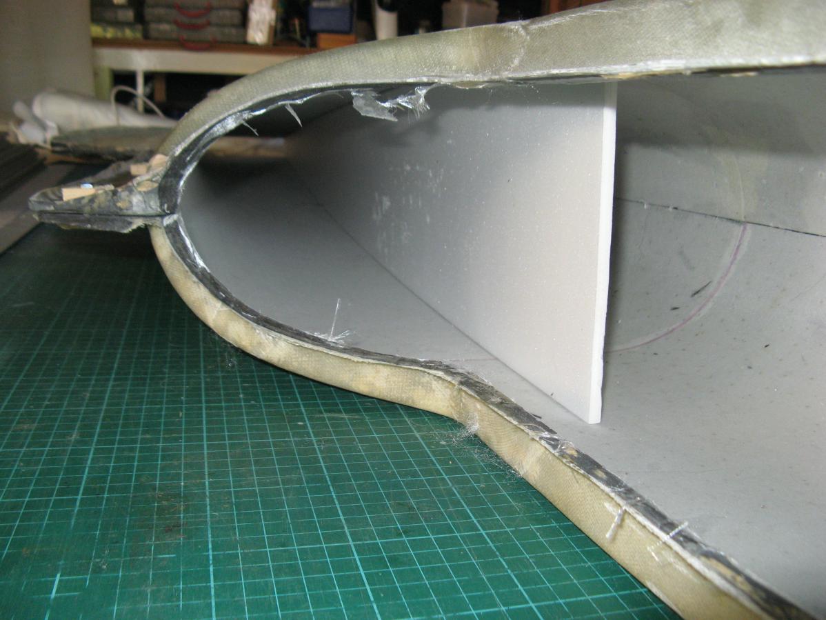

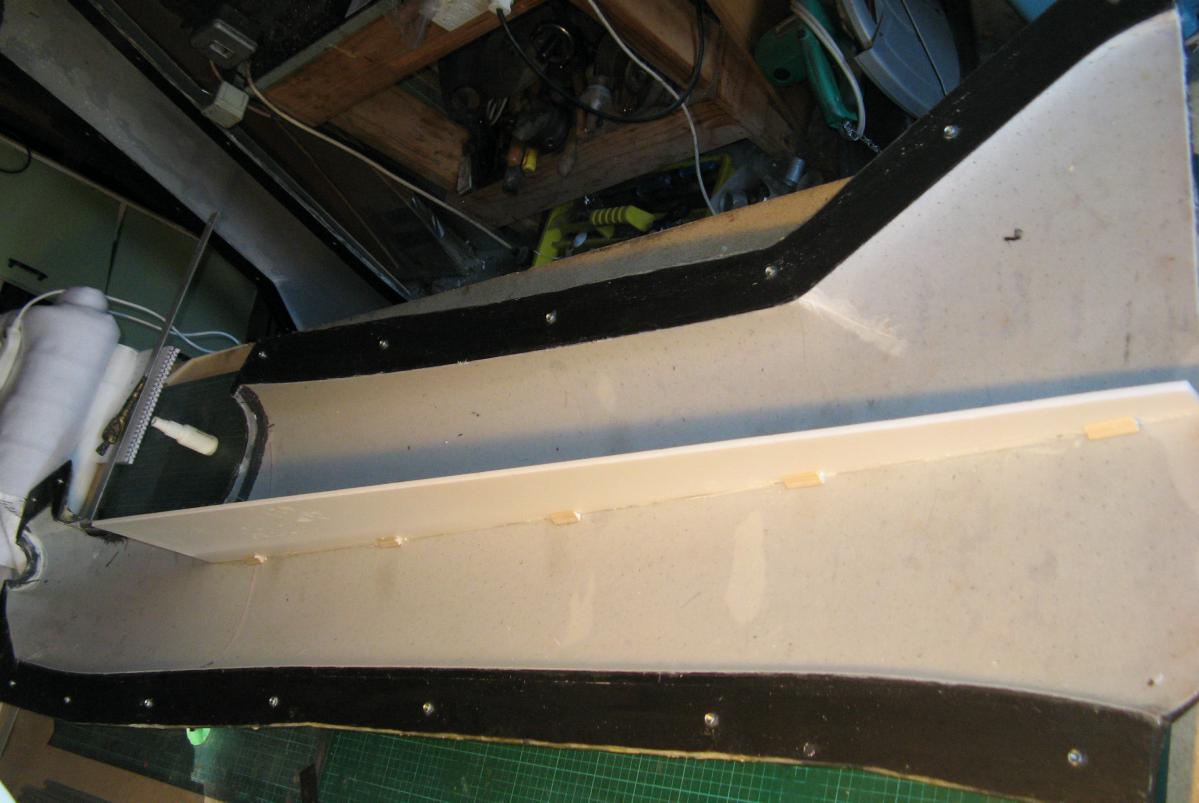

Trial fitting the rear fuselage stiffener before joining. It is 6mm depron 43gms.
Name:	trial fit stiffener.jpg
Old 07-25-2016 | 06:22 PM
  #127
drac1's Avatar
Joined: Jul 2008
Posts: 1,750
Received 10 Likes on 9 Posts
From: Romaine, Tasmania, AUSTRALIA
Are you going to lighten it, or leave as is?
Old 07-25-2016 | 08:14 PM
  #128
RodneyFord's Avatar
Joined: Apr 2015
Posts: 424
From: Lower Hutt New zealand
I've glued the stiffener into one half using scraps of balsa cynoed in to hold it in position while the epoxy microballoon mix (5.5gm) goes off. Normally I would be considering lightening it but the latest Allures have stopped lightening them. Maybe to eliminate extra cross ribs or for extra stiffness. I have never used a rear fuselage stiffener so I thought I would take their lead and see how it pans out. Will probably do another fuselage now I have worked out a system for them.

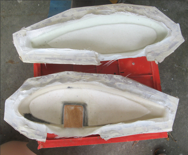

Finally got one out of the mold. Very happy with the weight, however there are a few blemishes and a few things I would like to do differently. So I think I will do another one.

You may want to add some more glass around the wing TE and 6" aft. Also, a bit more around the stab LE.
I had one buckle just aft of the wing TE. Just not enough reinforcement.
Weight wise you have plenty of room for the extra 20 grams.

Hi Rodney,
You may want to do another but that is some start - very good weight.
The brace across the rear half will do a lot to retain integrity. It keeps every thing in place which will help avoid compression failures.
Matt, Did yours delaminate or just break - or was it too crash damaged to know ?

Hi Rodney,
Just noticed something now, sorry !
Have you had to join the Rohacell core ?
I would taper/splice or use a finger (zig-zag/saw tooth) joint so as to avoid stress focusing !
Brian

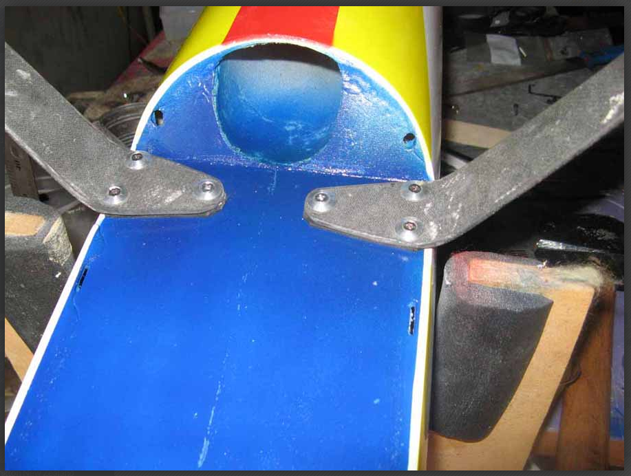

I modified the original Wist Model innovation quite a bit to simplify alignment and improve the installation to the fuse. The struts simply plug in....very tidy inside the fuse
The total weight of the mount in the fuse is about 20 grams. My complete, rtf weight of the gear is just under 5 ounces with spats. So about 5 1/2 ounces installed and rtf.

Thanks for the input guys. Yes Brian there is a join in the Rohacell at that point the marker pen tends to accentuate it. I get a reasonable join and fill it with microballoon mix if necessary. I also join the 50gm glass at that point and overlap it about 75mm. I will have a good think about the layup for the next one. I running short on Rohacell but I think I could do 1mm rear fuselage and 1.5mm at the front. Would like some carbon around the wing tube and UC area and maybe do the inner glass layer with 50gm at the front. Keen to look at your UC mod Matt.

Rodney, the gear struts are rather slender and thin by most standards. They are shock absorbing to reduce load transfer to the fuse. These are designed such that they are neutral....no front or back to them. The tangs insert into sockets self aligning. A single 4-40 screw holds each in place.
A 21/2" square carbon cloth is epoxied on bias in the fuse sides. The carbon and aircraft plywood sockets are installed into the carbon cloth, through each side of the fuse, with some laminating epoxy filled with micro balloons and carbon chop. The struts are then put into their final location, bolted in place and the epoxy is then cured with everything aligned.
Highly recommend this mounting method with the shock absorbing struts. It has proven itself super reliable over the past 4 or 5 airplanes and at least 1500 flights. With your skill, it should t be that tuff to figure out the details, but if you get stuck, shoot me off a pm.

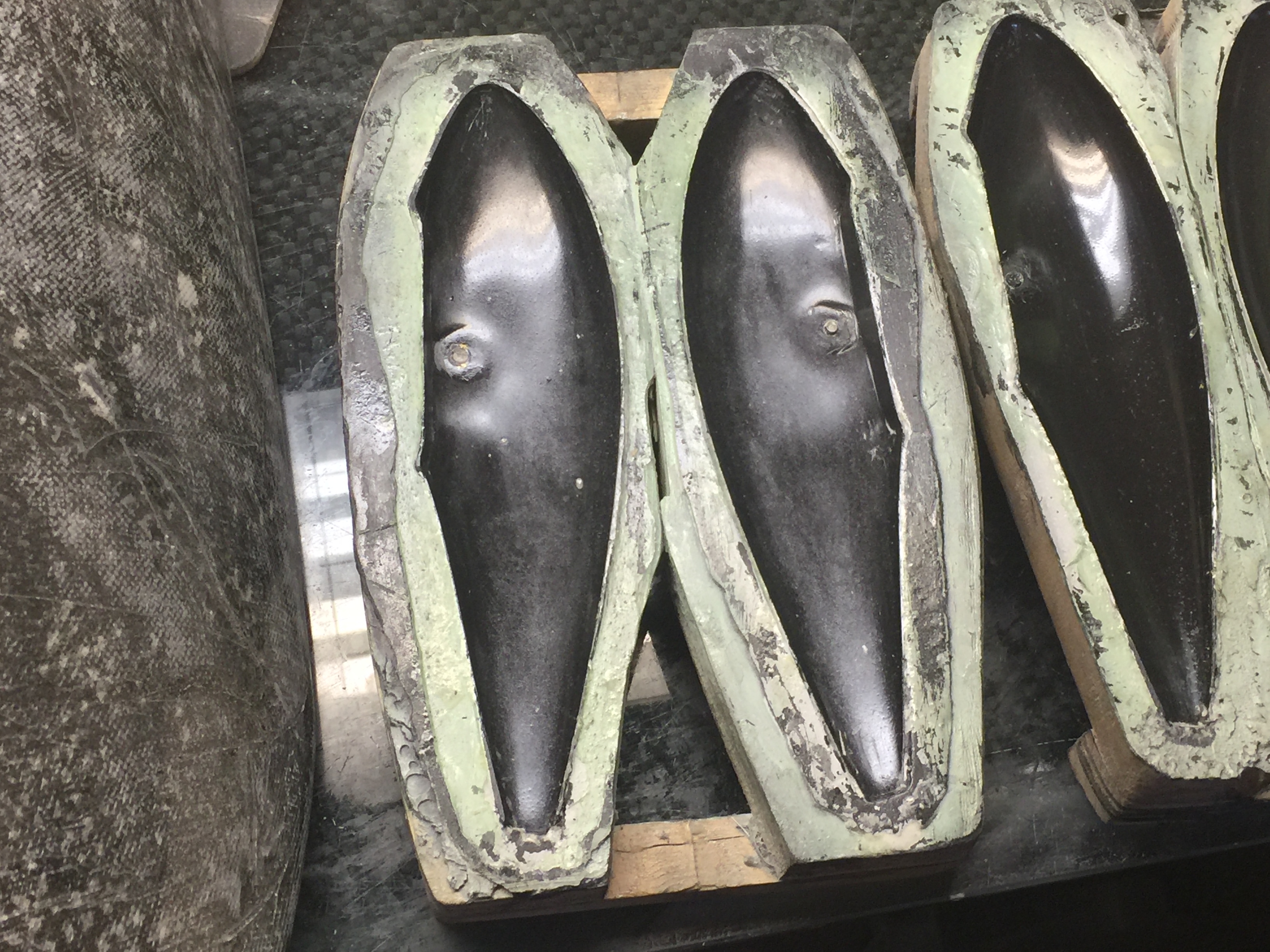

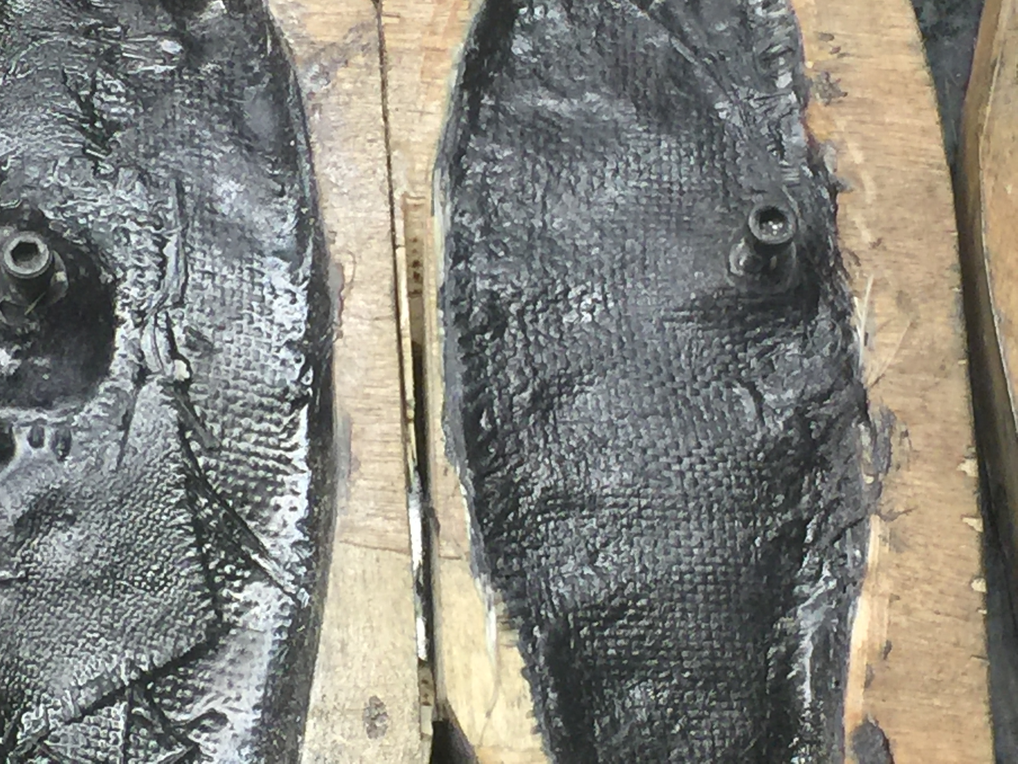

Well Matt I am very interested to hear what you have to say regarding spats. This is how I make my legs and will be easy to adapt to your style of leg. The mold is cut from blue foam with my cnc foam cutter then lined with mylar then dams inserted to shape the legs. 13 layers uni 3 layers bias cloth 78gm.
ID:	2174784   Click image for larger version

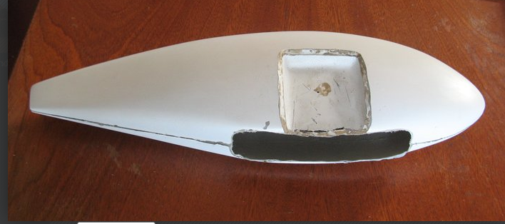

Matt here are a few shots of my Slick 360 (DA200) spats. The idea is to have 2 inserts to mold recesses for the legs. This means I can mold left and right spats out of one mold.
Making inserts.
Not sure yet if this will work on my little F3A spat molds.

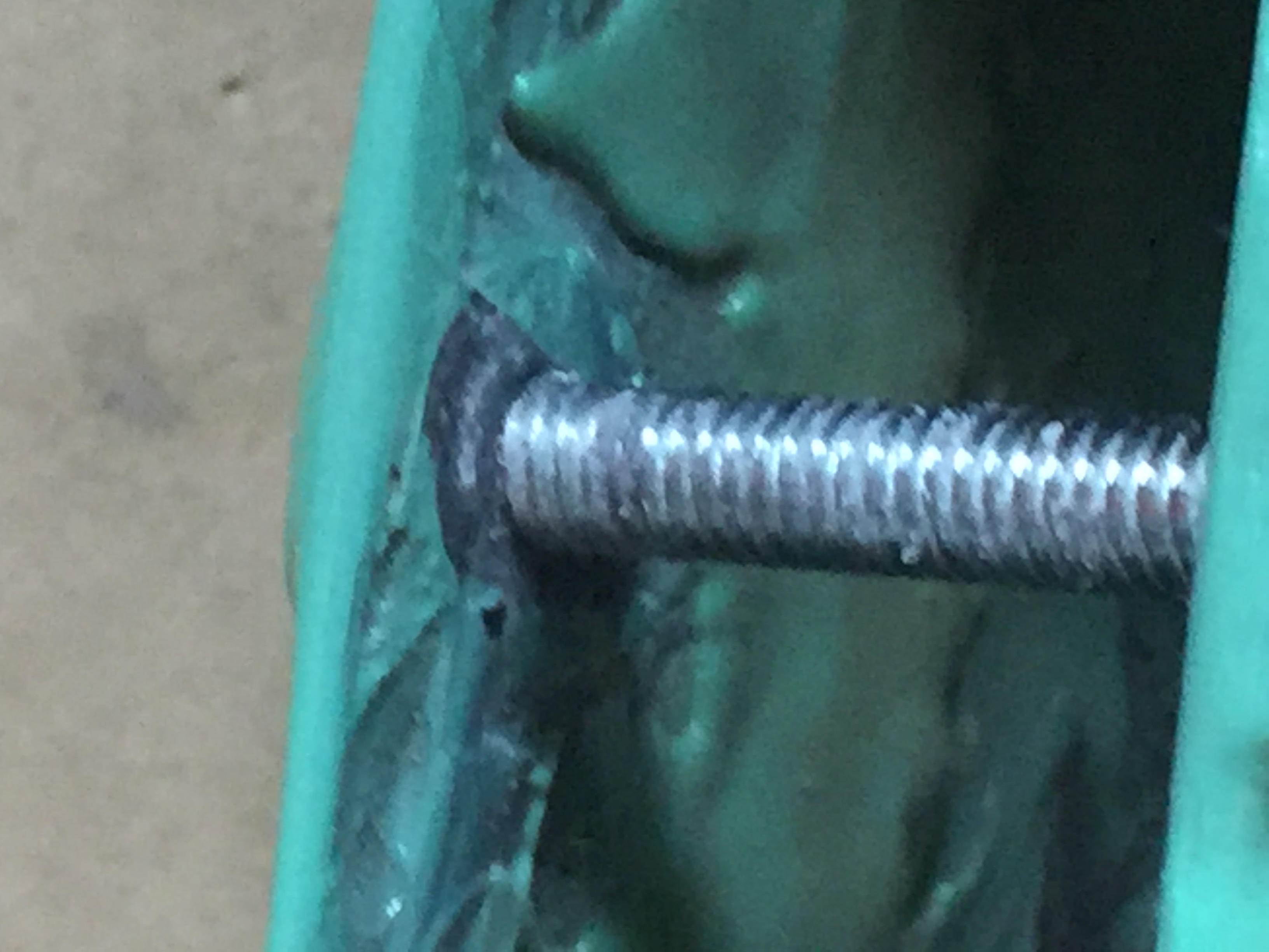

I usually use two layers of 2 ounce cloth for the smaller. Then add carbon cloth to both sides of the spat in the axle area. Then I add the steel nuts to both sides that the axle screw goes through and secure it with some glass and carbon chop.
My molds have alignment tubes at the nut areas such that the 8-32 screw pulls the nuts into perfect alignment.
Once the spat halves have joined, I add carbon roving around the wheel hole. The spattypically weighs 12-13 grams after all of the reinforcements and nut install. The spat and strut are epoxied together with high strength flex epoxy.
The axle is of course an 8-32 bolt about 11/2" long. The steel secures both sides of the spat
Ill take a photo of a complete strut and post.

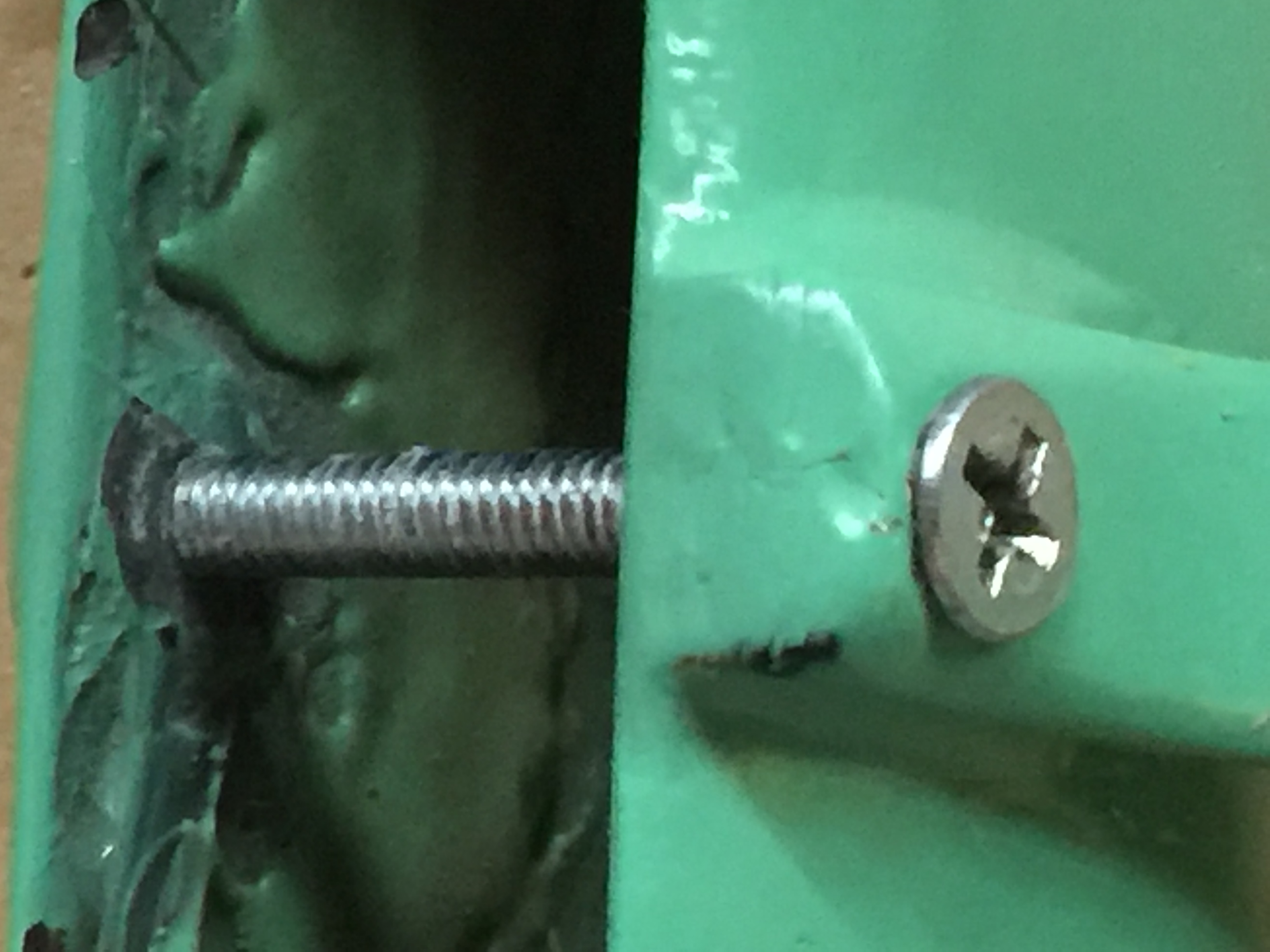

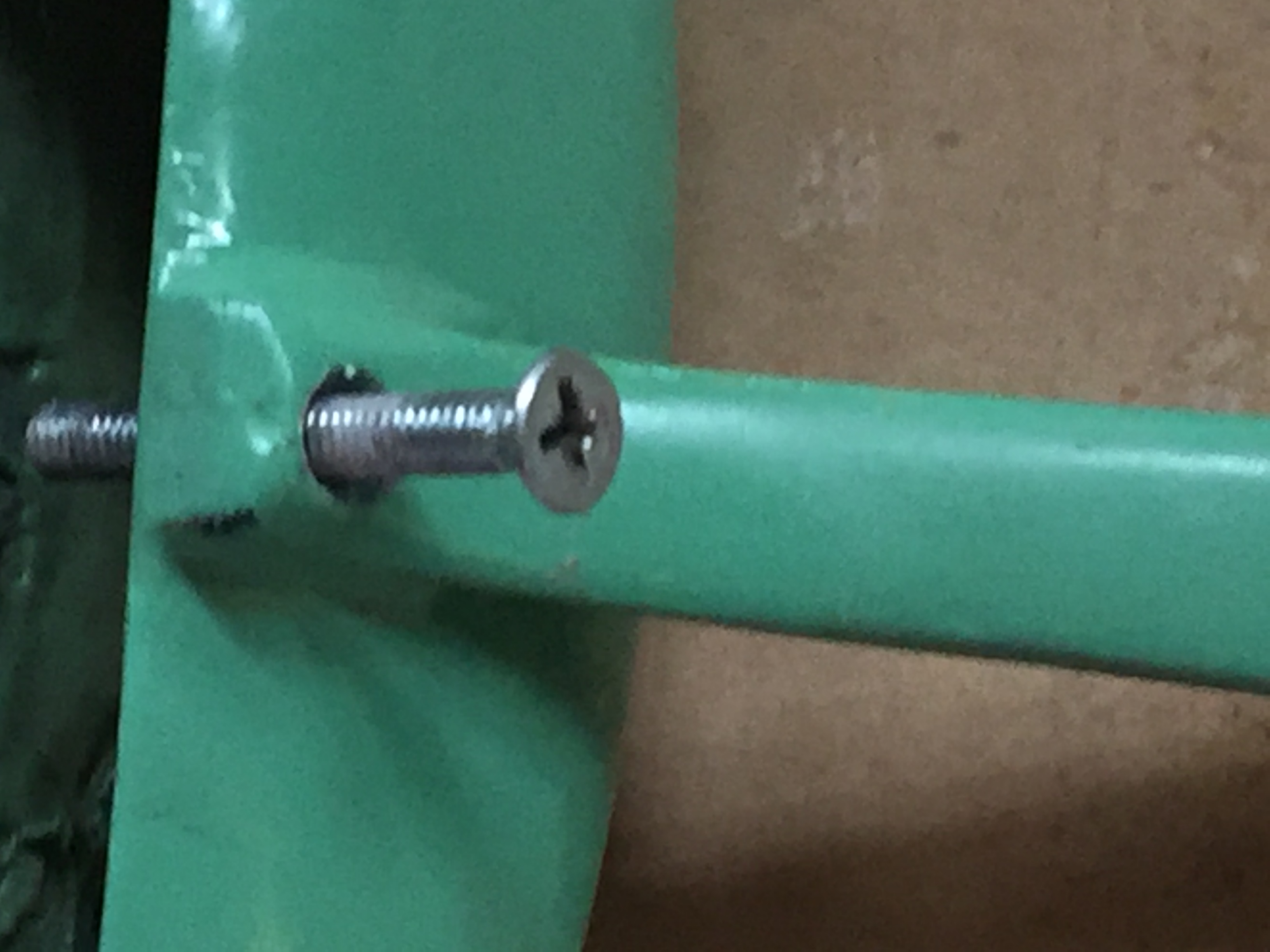

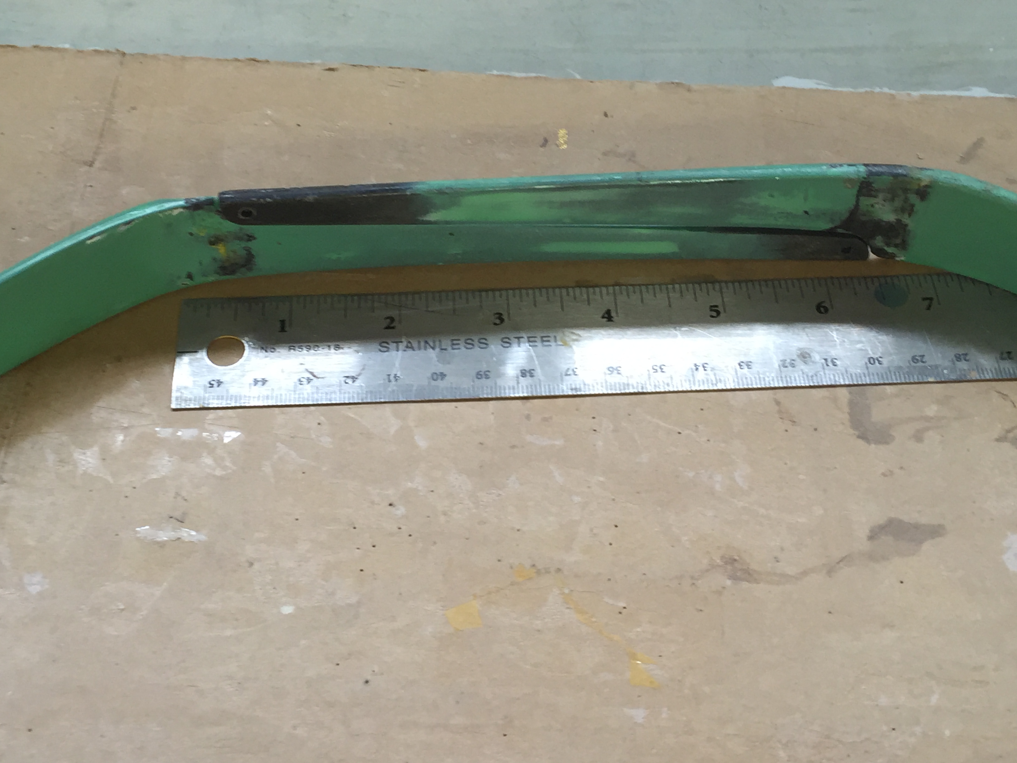

Well used spat mold....I need to build another. Shows the axle bolt areas
Outside view of mold showing the alignment tubes
Struts and spats epoxied together. The spat has carbon cloth inside. Very strong and secure. Flat head 8-32 "axle screw" countersunk into strut
And extends to the far side of the spat, securing the outside
Self explanatory?
Tang length out of the mold is 7.5". It is tailored to fit any fuse width from about 8.5" to as narrow as about 4". Tangs are thinner than the rest of the strut for flex and shock absorption.
Tangs designed to fit into one another. They are fitted into sockets (not shown), which are fitted into the fuse sides. There is no orientation with this style, but could be made differently if orientation or rearward slant is wanted.
The complete gear set (strut and spat) typically weighs around 105 grams. Wheels and axles weigh whatever they weigh.
