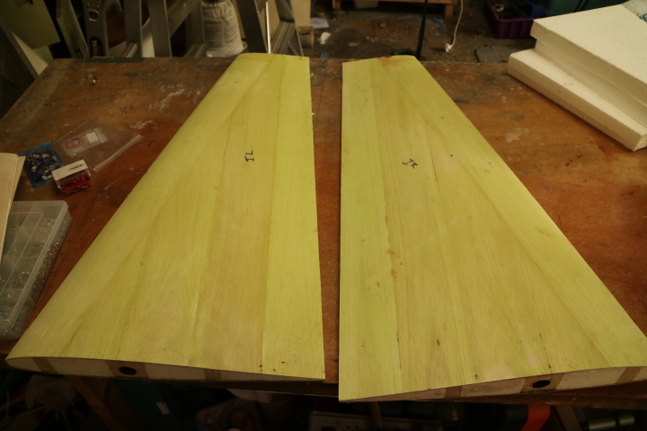

This project has been on hold due to work commitments. However I am unemployed for a while hopefully.

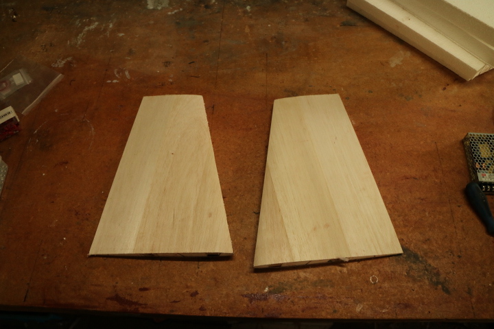

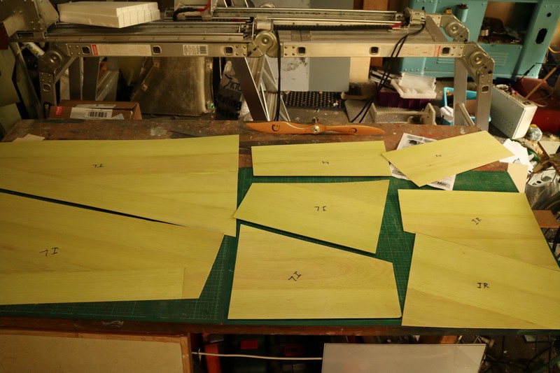

Time to build the wings. First worked out the sheeting plan. Most sheeting parallel to the trailing edge and one sheet parallel with the leading edge.
Name:	Wing sheeting.jpg

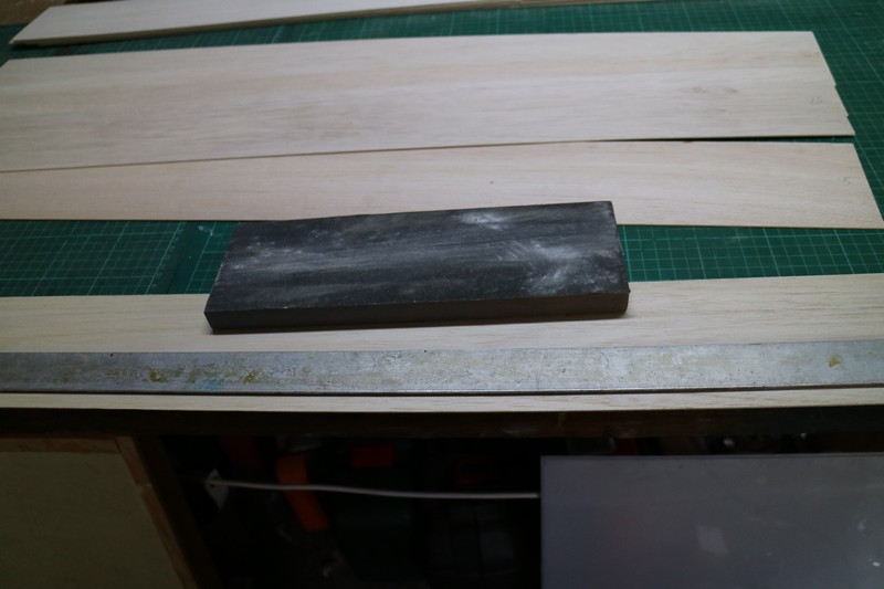

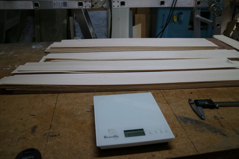

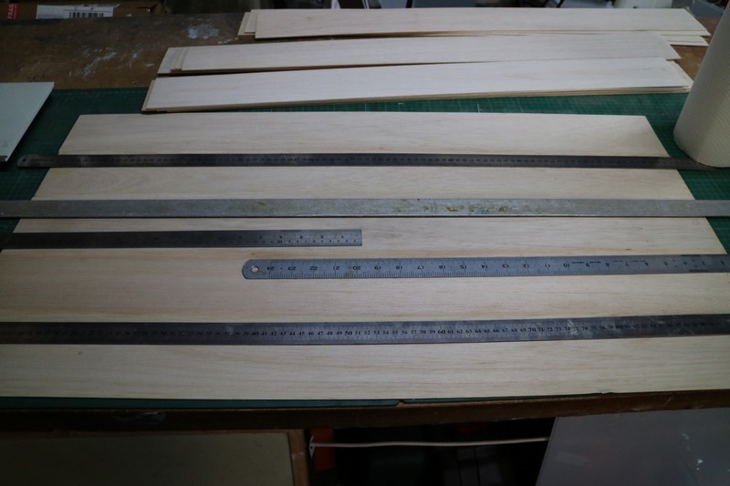

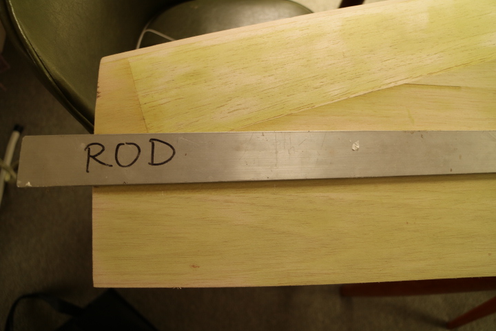

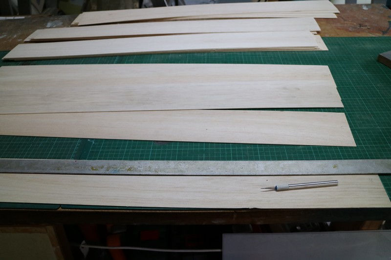

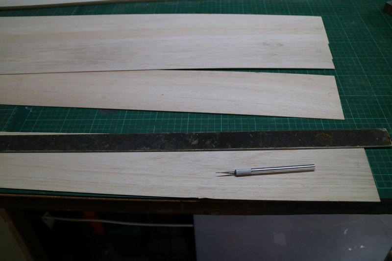

Graded my wood for equal weights per panel. It is a gram a sheet too heavy but I will sand them to weight later.
Straightened all the edges with a sandpaper backed straight edge then sanded them.
ID:	2196485   Click image for larger version
ID:	2196486   Click image for larger version
ID:	2196487   Click image for larger version

Taped the sheets together and then glued them with aliphatic.
The convention is to keep the grain parallel to the leading edge to improve flexibility around the airfoil and prevent splitting.

The single sheet at the LE pretty much does it. Sometimes I will do it the other way with a single sheet parallel with the TE for the ailerons. Due to the wing taper it works better for me this way.

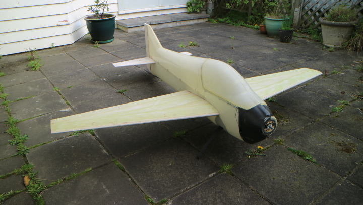

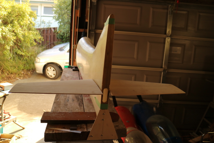

Made the horizontal and vertical stabiliser skins too so I can seal inside of them with dope at the same time.

Haven't painted for a while so it was good to get the gun out again and start getting my hand back in. Put on 2 coats of dope sanded in between. Tinted the dope with a little colour (Green) for a visual indication of coverage. Sealing the inside surface of the skins stops the epoxy I will be using to glue them too the cores from soaking into the balsa. This reduces weight and promotes bonding. Hair spray will also work and is easier but I like the traditional materials. Started preparing the wing cores for bagging.

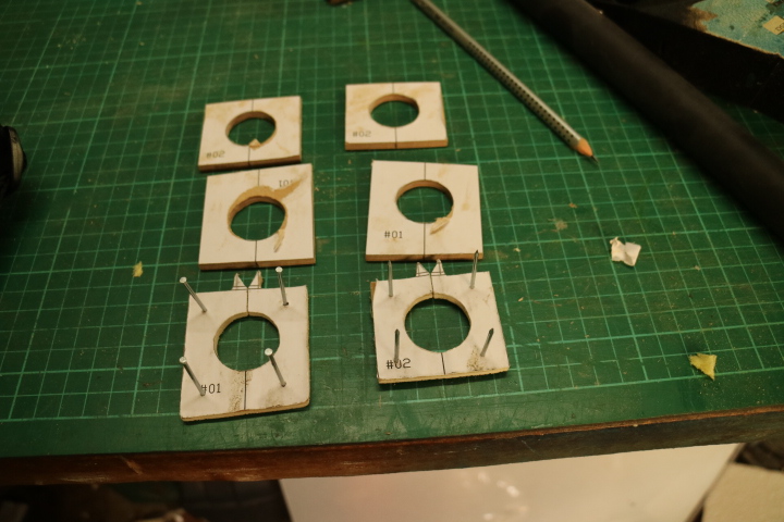

Old 01-25-2017 | 11:38 AM
  #160
RodneyFord's Avatar
Joined: Apr 2015
Posts: 424
From: Lower Hutt New zealand

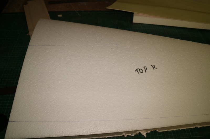

Sheeted the cores. I used epoxy and vacuum bagged them. Wings 320gm each (a bit heavy I suppose but in the ball park). Tail surfaces 55gm each.
ID:	2198158   Click image for larger version

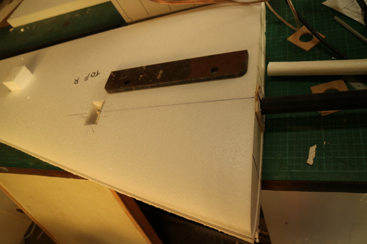

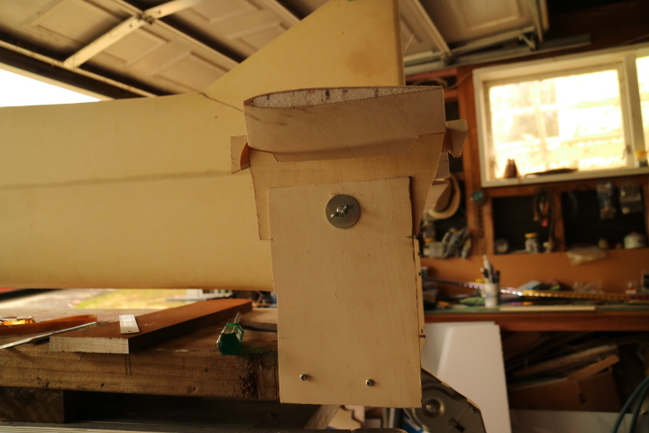

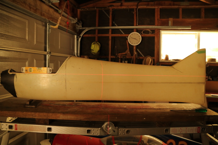

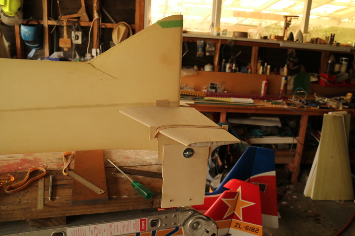

Made a fixture to hold the fuselage in position to set up the horizontal stabiliser. This is just a false tail post with a hole for access. In the first image you can make out the laser line I used to get the tube position.
ID:	2198500   Click image for larger version

Made an adjustable fixture to hold the stab in position. Four different measurements to get right.

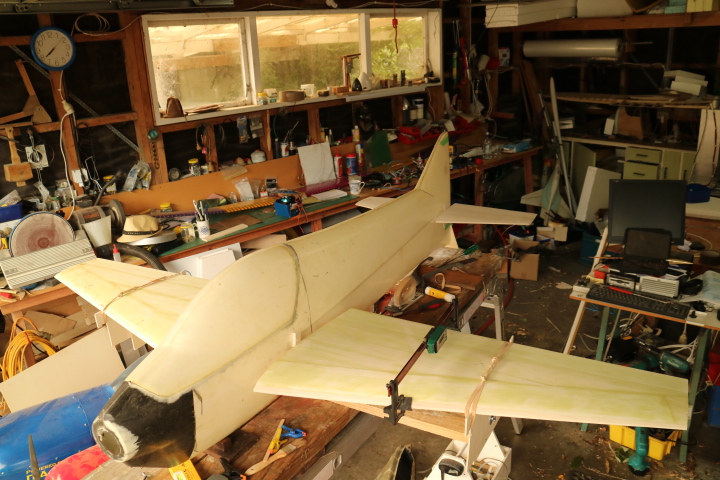

Setting up the wings with more fixtures. I'm setting it up as per Brian Hebert's triangular trimming method. 0.5 degree down thrust 0.5 degrees positive incidence on the wings and 0 on the stabs.

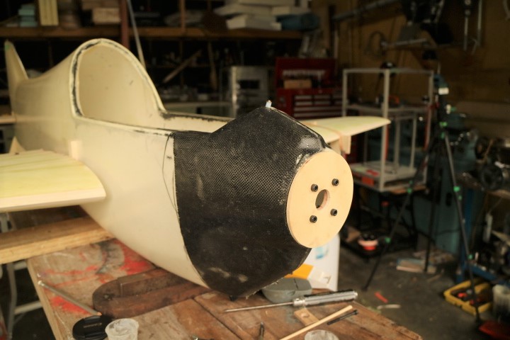

Glued in the front motor mount. Front plate is for clamping and alignment and will be discarded. Wing doughnuts are glued in too. They will get some carbon reinforcement.
ID:	2199269   Click image for larger version
ID:	2199270   Click image for larger version

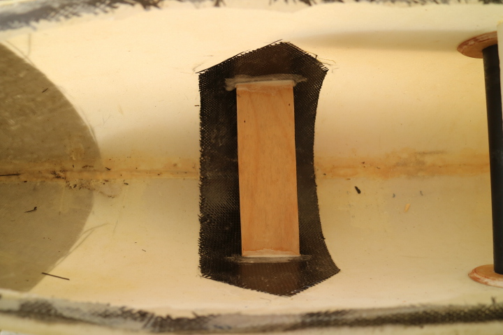

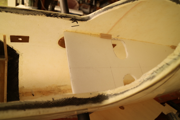

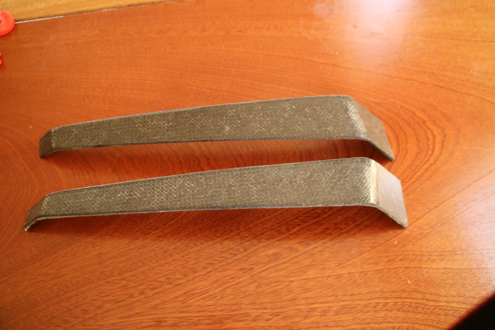

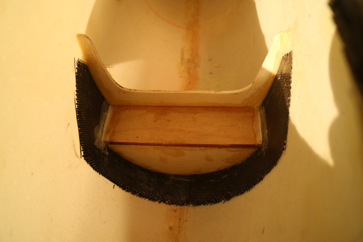

Got the UC mounting plate in along with carbon reinforcement. It will also have some reinforcing formers front and back. I'm going to use these legs I made a while ago for another project.
ID:	2199417   Click image for larger version

Installed the UC formers. I developed the shapes by trial and error with the band saw and (mostly) the disc sander.

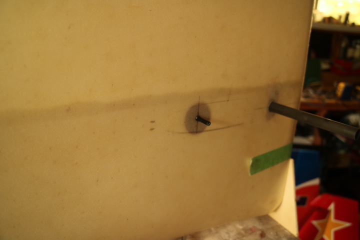

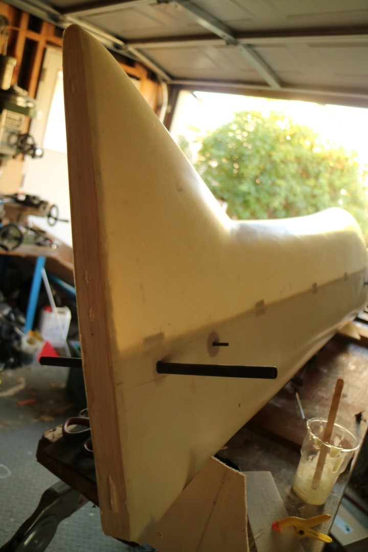

Stab anti rotation pin 4mm carbon tube.
Got a carbon arrow for the wing anti rotation pins. I glued them in one piece to keep them square and will cut them off when the glue dries.
ID:	2200018   Click image for larger version
ID:	2200024   Click image for larger version

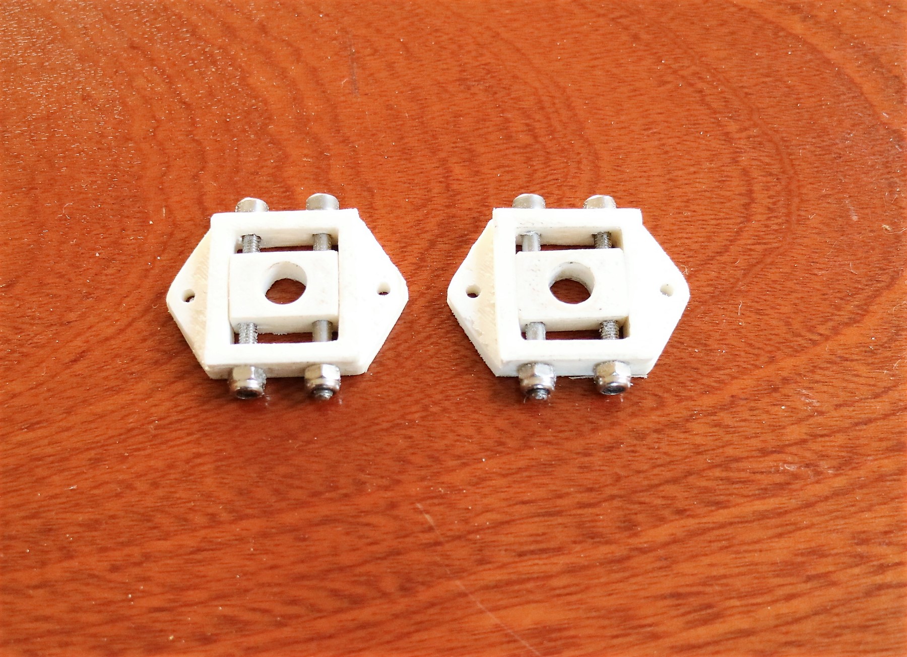

Got the ply plates in for mounting the incidence adjusters on. Designed and printed the incidence adjusters in ABS Poly-carbonate alloy, this stuff is incredibly tough.
Laminated the tail post from 5mm balsa and glued it in. Also got the ply/carbon tail wheel leg mount in.

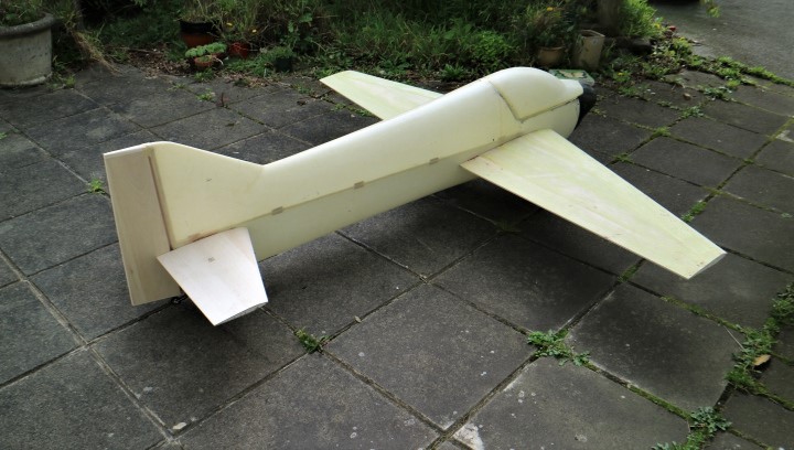

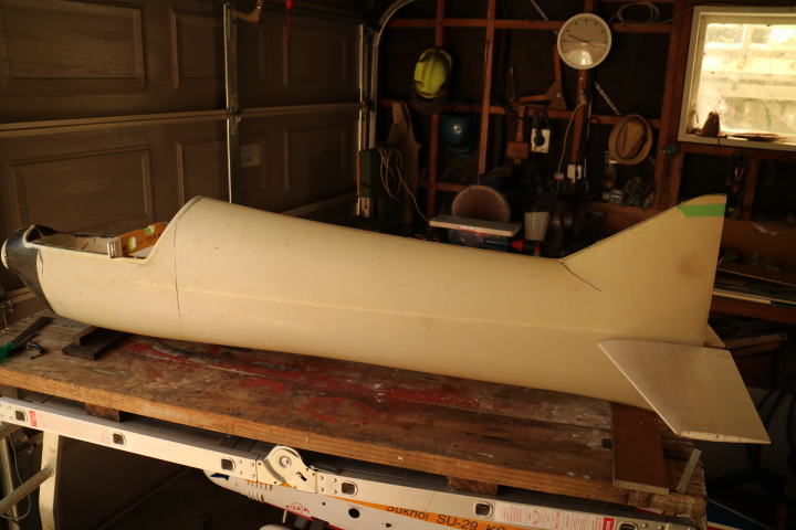

A six week adventure to Europe intervened but back into it now. Starting to look like an aeroplane now.

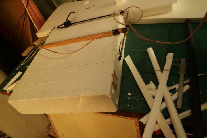

Let's see, what have I missed. Foam core rudder. 2 pieces of foam cut on the CNC foam cutter. Vac bagged as usual. I added a bevel to the tail post as well.

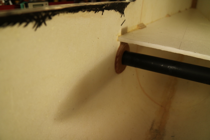

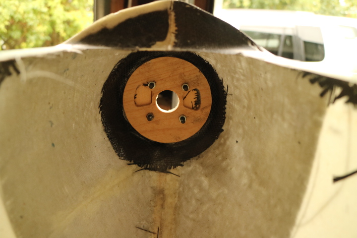

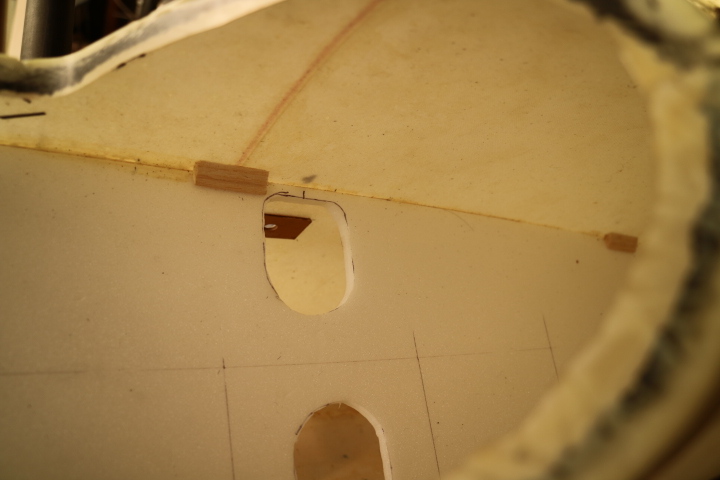

Got the battery tray supports in and started on the rear motor mount. Got the hatch fitted with front dowel and rear latch.

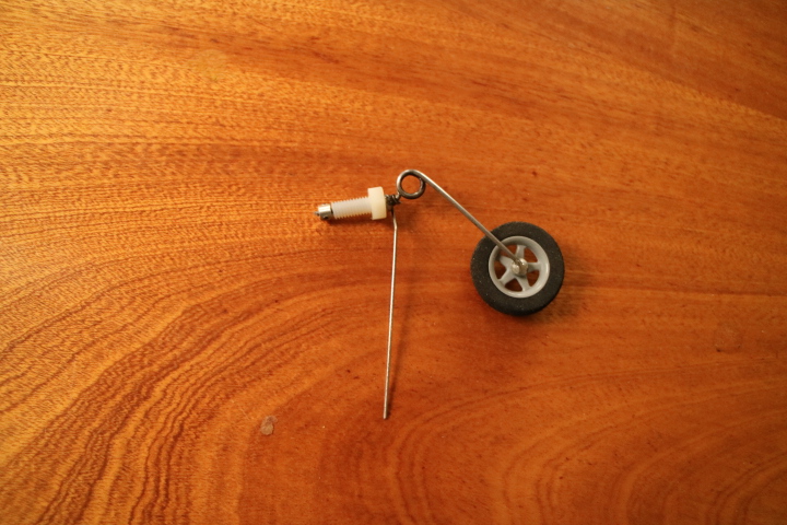

Made a tail wheel assembly. 6mm nylon bolt that screws into threaded hardwood plug glued into the bottom of the tail post. Made the little 5mm diameter collars on the lathe.

Got wing servo mounts in and capped the trailing edges. Also some smart***** at work got to my straight edge.
ID:	2233126   Click image for larger version
ID:	2233127   Click image for larger version
ID:	2233128   Click image for larger version
