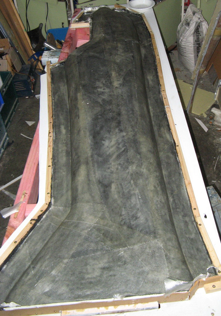

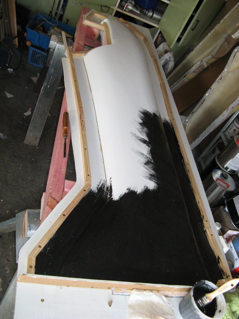

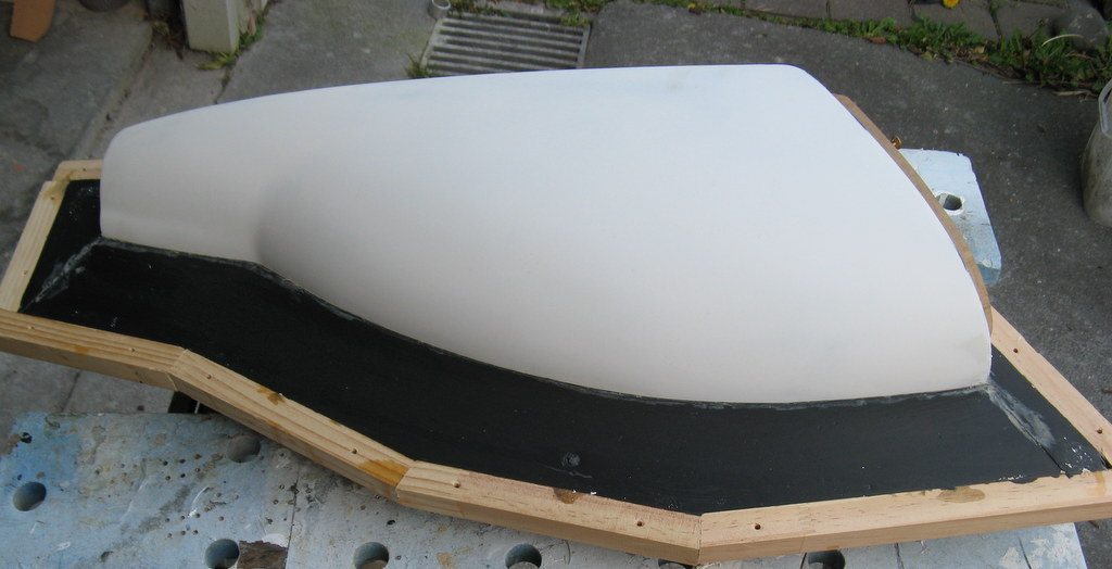

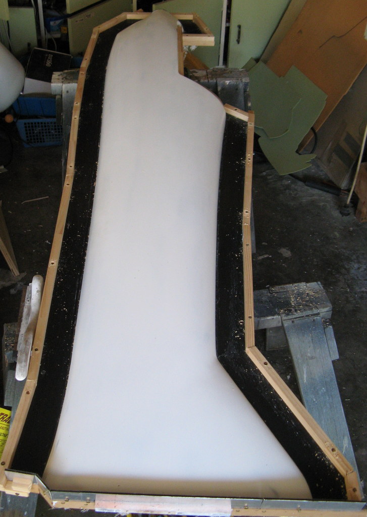

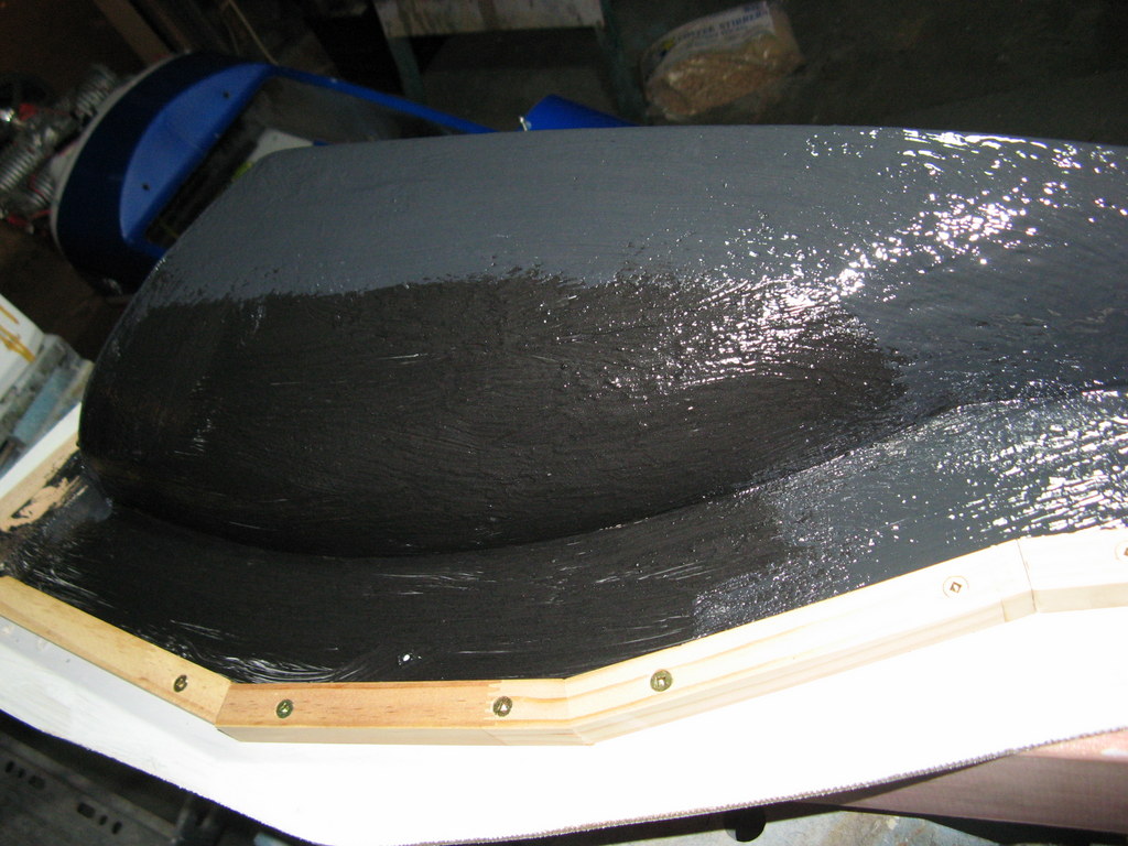

Applied the first gel coat. This will be an all epoxy mold. The gel coat is made by mixing West 404 high density filler and graphite with epoxy. The mixture is filler 30% of resin weight and graphite 7% of resin weight. This is a fairly thick mixture and is brushed on. I am going to apply 3 layers of the gel coat. Now that I have started this process I need to apply each layer before the preceding one fully cures so as to get a molecular bond between the layers. That means another coat tonight and another tomorrow morning etc.etc.
ID:	2118811   Click image for larger version
ID:	2118812   Click image for larger version
ID:	2118813   Click image for larger version

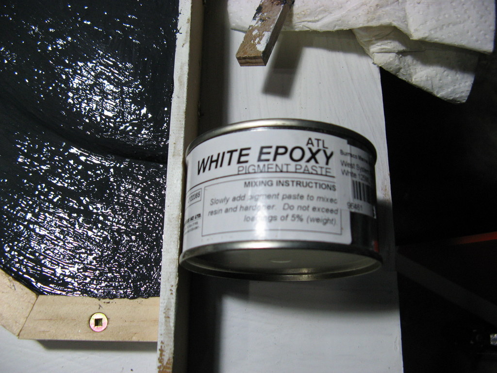

Old 09-08-2015 | 03:13 AM
  #102
RodneyFord's Avatar
Joined: Apr 2015
Posts: 424
From: Lower Hutt New zealand

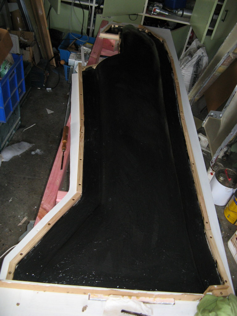

Got the second gel coat on. Put some white epoxy pigment in it so I could make sure of full coverage. Will need to do the next coat first thing tomorrow morning,
ID:	2118819   Click image for larger version

Applied another gel coat and 2 layers of 80gm glass while the gel coat was still wet. I use quite small pieces of glass mostly cut on the bias. This makes it easy to go around all the sharp corners. 40% Slick 360 in the background getting some work done on it.
ID:	2118864   Click image for larger version

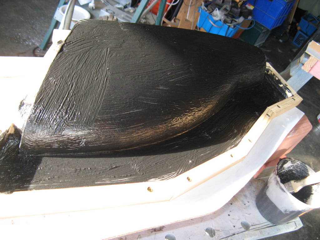

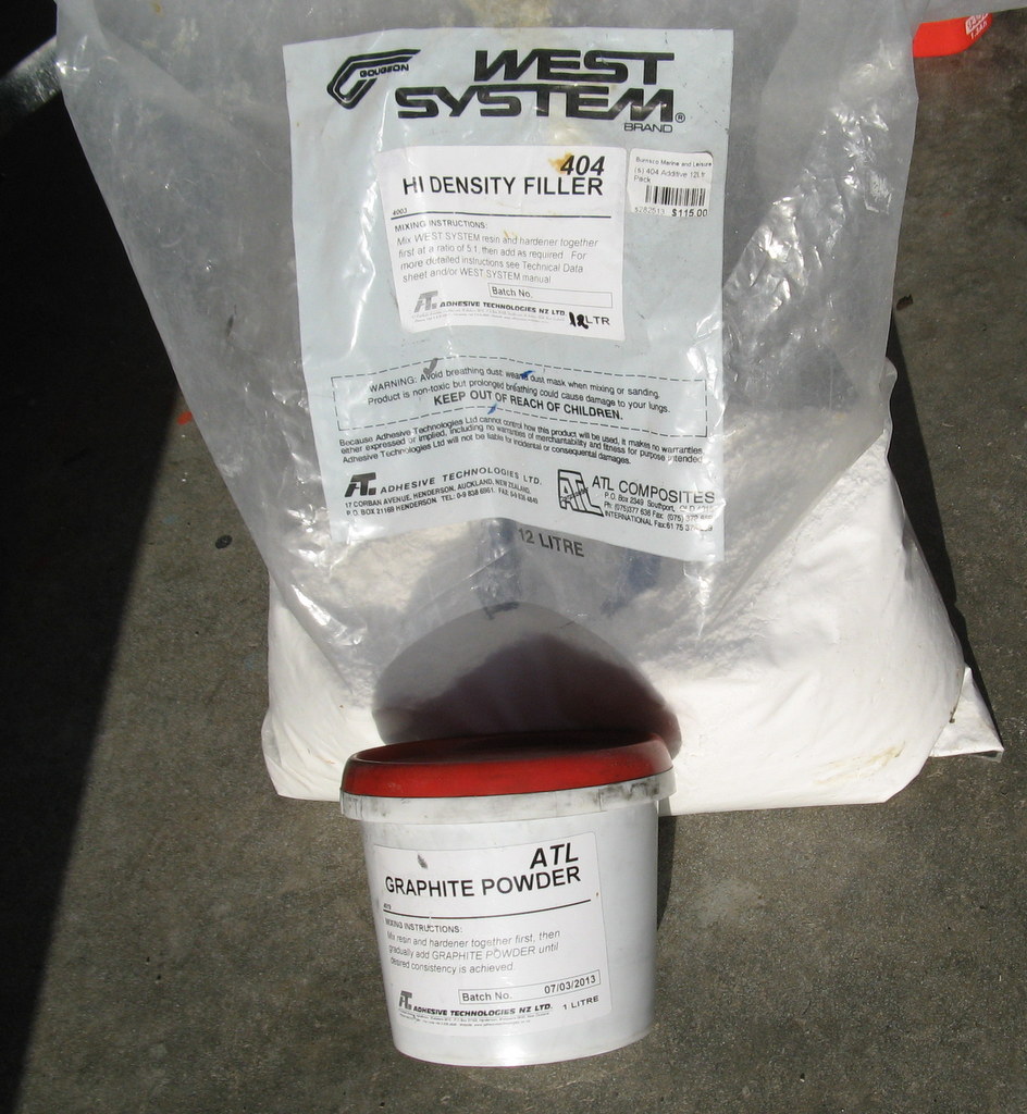

3 layers of 200gm glass. First I apply a coat of epoxy with some filler powder in it so as to get a seamless bond between layers. I use a heat gun as I apply each layer of glass to help the resin migrate between layers.

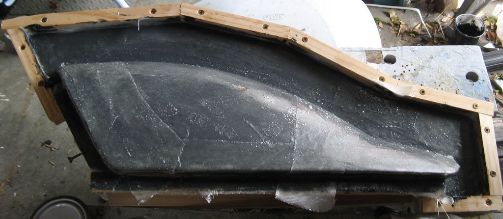

Old 09-09-2015 | 06:36 PM

Originally Posted by grahamj4
Coming up nicely, how many layers would you put on altogether?
Hi Graham

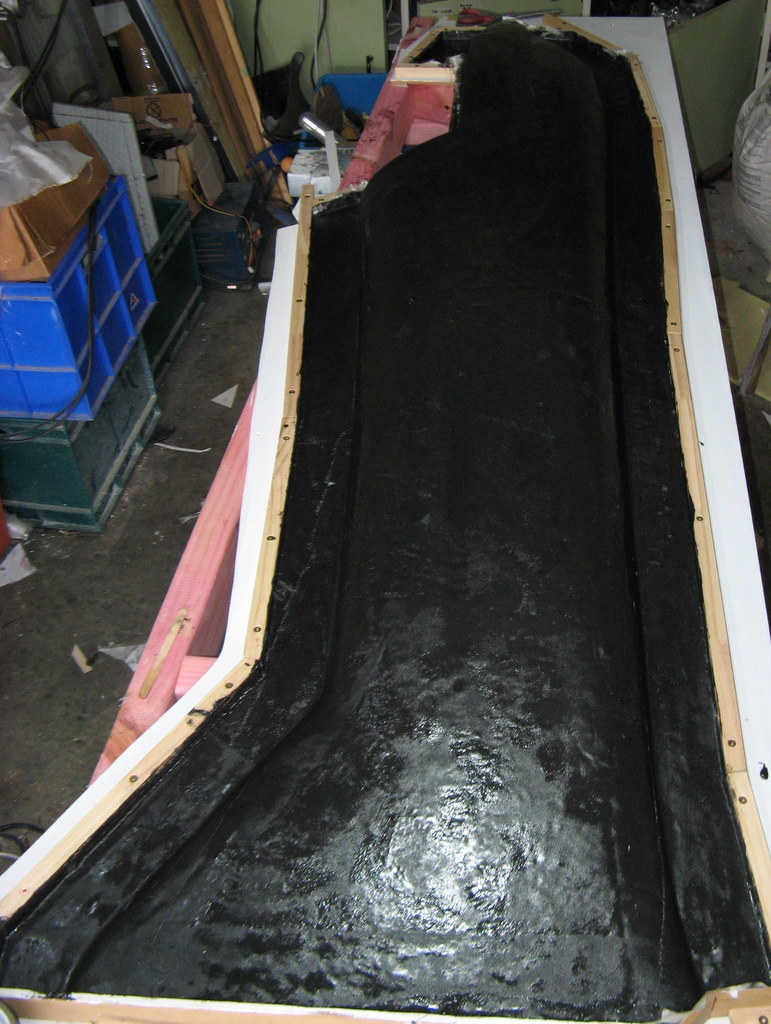

I put on more layers last night which finishes that mold half. There are 3 layers of gel coat, 2 layers of 80 gm glass and 5 layers of 200 gm glass as well as 2 extra layers of 200 gm glass on the flanges. Also because I used strips of glass from 100 to 200 mm wide and various other small shapes which overlapped maybe 20% is double or more layered. I'm going to leave it to cure for a few days before removing the parting plate and starting on the other side.

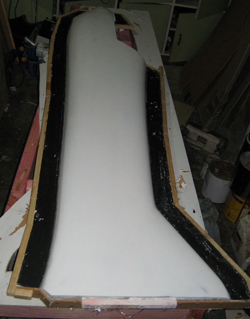

Unfortunately slowed by work. However progress will continue. Released fuselage from the parting plate.

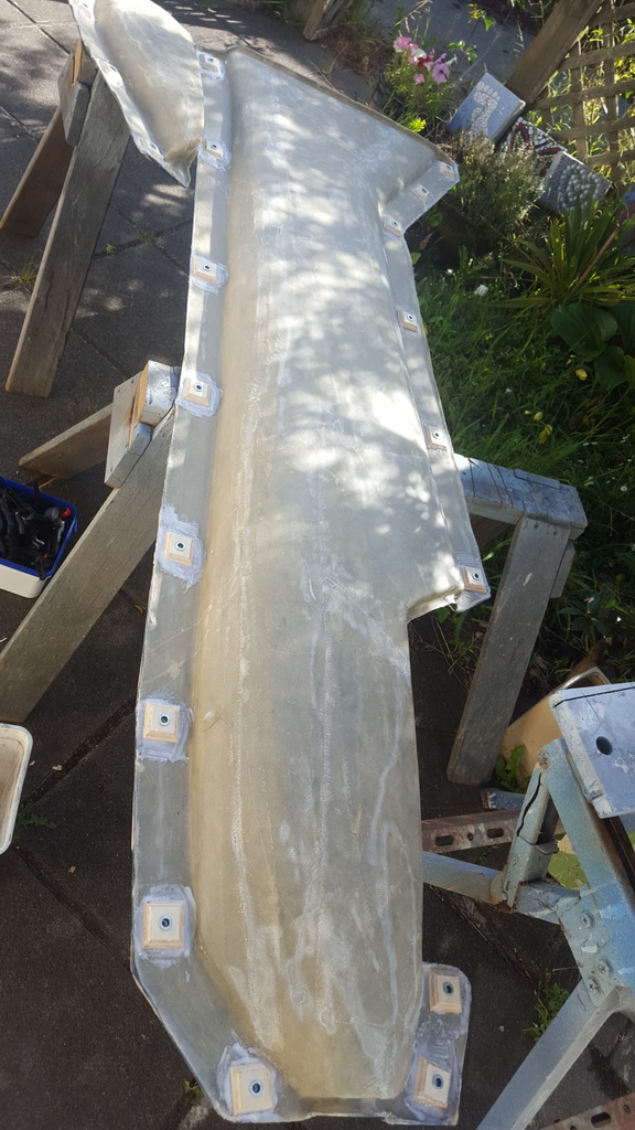

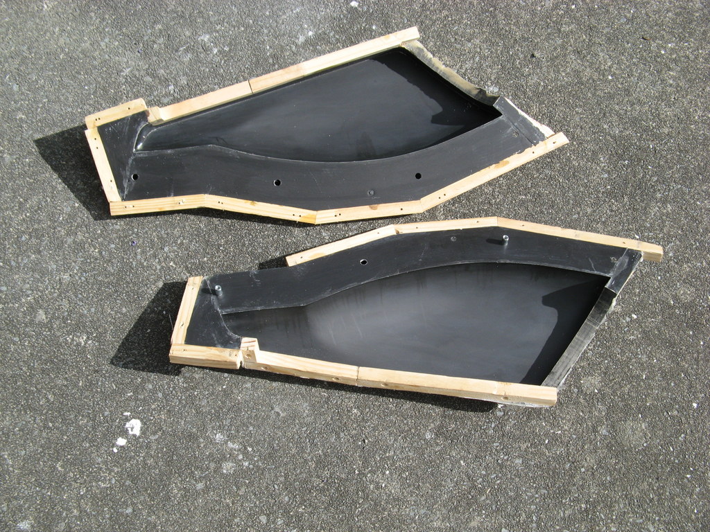

Old 10-26-2015 | 01:30 AM
  #111
RodneyFord's Avatar
Joined: Apr 2015
Posts: 424

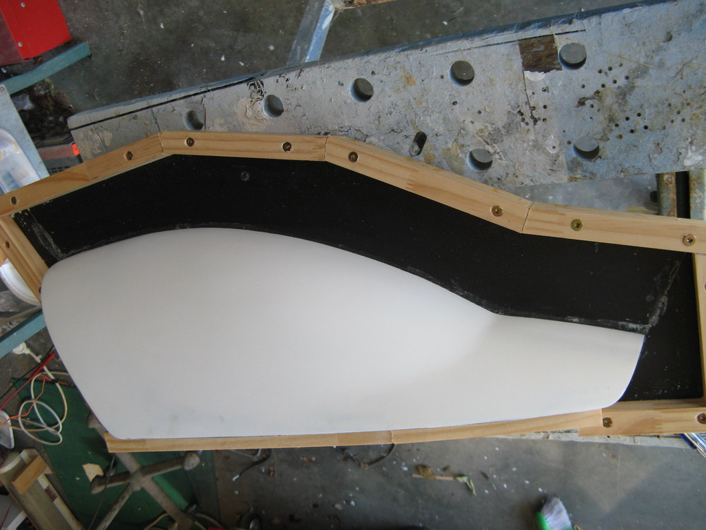

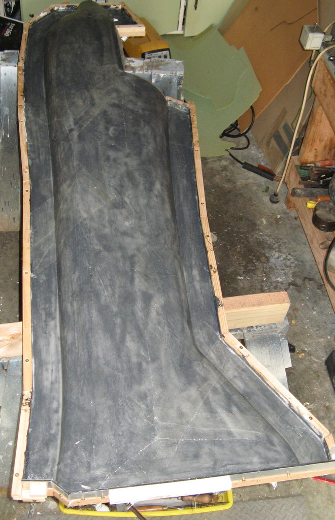

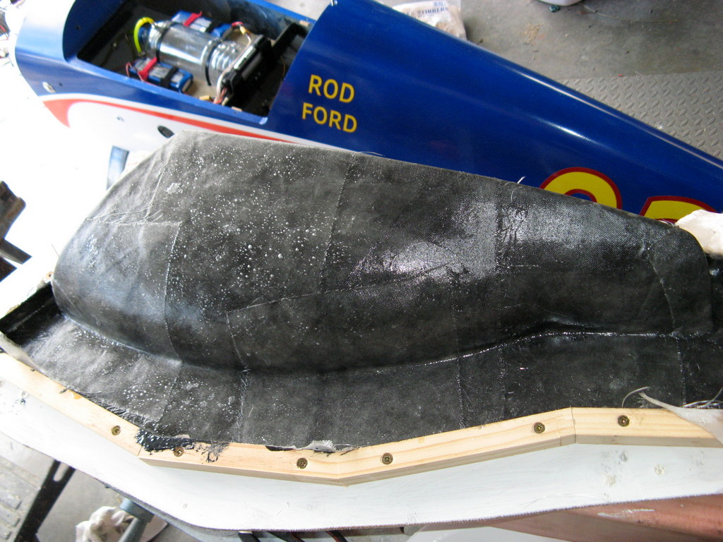

Released the molds from the patterns today. Drilled 9mm holes around the flange to accommodate the 6mm rivnut alignment pins.
The canopy was difficult to release due to the tight corners, the fuselage released very easily.
Mold surface looks great, no bubbles.
ID:	2127731   Click image for larger version

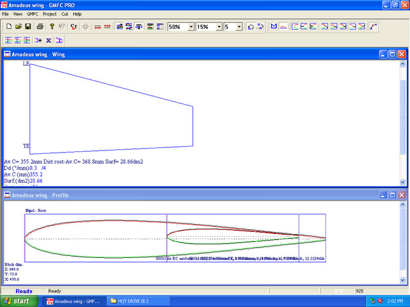

Sorted out the wing plan form. Wing area is 1067 sq. in. Foils are S8035 modified 12.5% root 11.5% tip. The trailing edges are slightly thickened about 4.5mm. S8035 has the high point further forwards than the commonly used NACA 63 series foils. Joe Wurts and prof. Selig think S8035 should be a good aerobatics aifoil. Tail is SD8020 as usual.

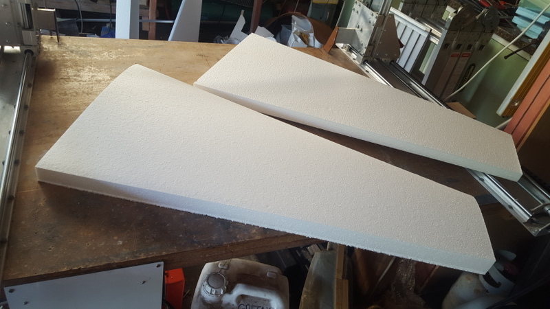

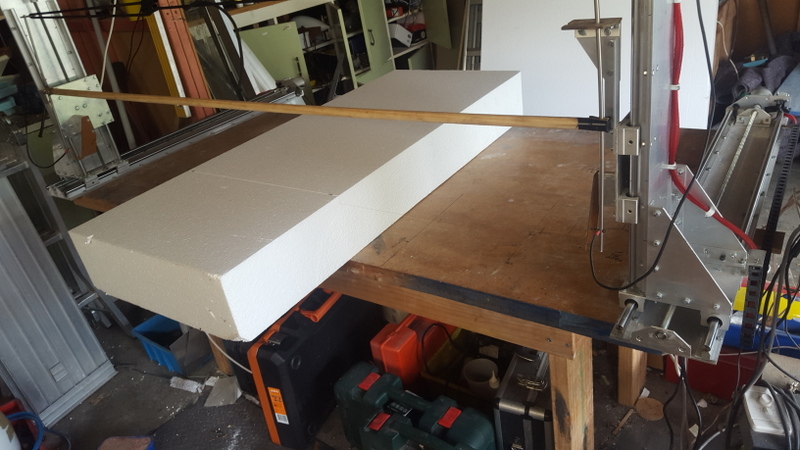

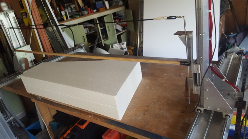

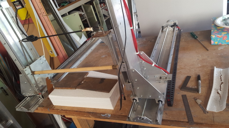

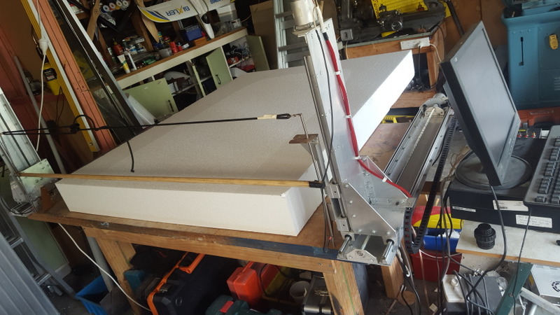

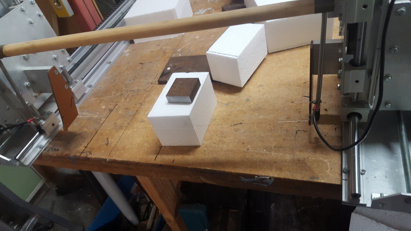

I have had a CNC foam cutter for 10 years or so. This is the 3rd version. I use the lightest foam I can get 12kg/M3 or 12lb/ft3. I am not going to honeycomb them.
Blocking out.
ID:	2140095   Click image for larger version
ID:	2140096   Click image for larger version

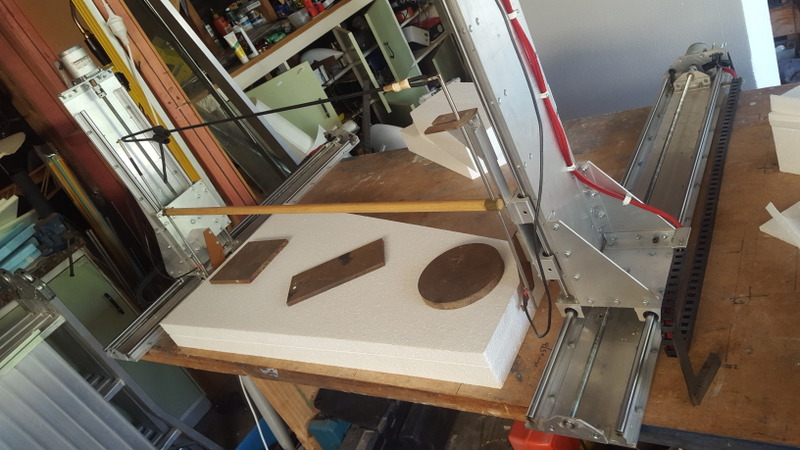

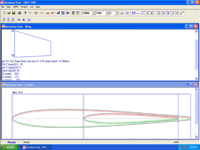

Cutting the cores. Came out perfectly in spite of 2.25/1 taper ratio. Screen shot of GMFC the cutting program.
ID:	2140104   Click image for larger version
ID:	2140105   Click image for larger version

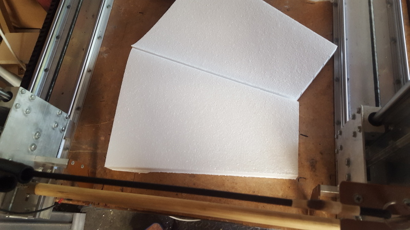

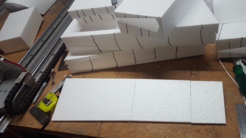

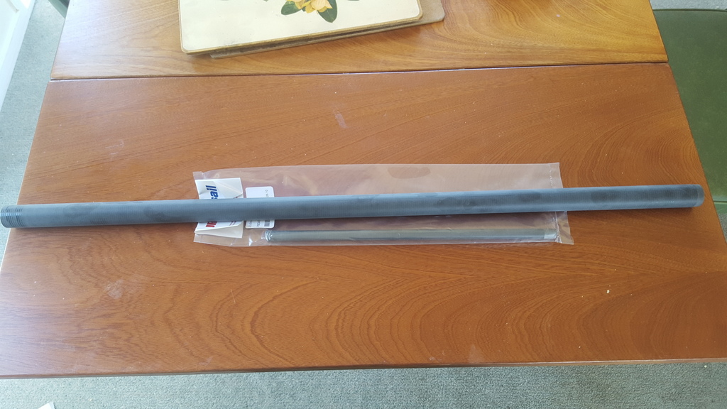

Tail planes need the machine to be reconfigured for a smaller bow. I have 4 bows 450mm to 1500mm. The wire is .2mm Inconel.
More perfect cores. I will do the rudder shortly. Need to get some carbon tubes. Fortunately PBG tubes are manufactured here in New Zealand.
ID:	2140107   Click image for larger version
ID:	2140108   Click image for larger version

PBG wing and tail tubes arrived.

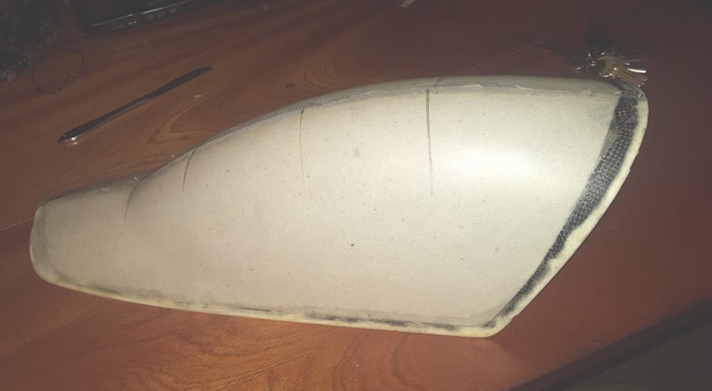

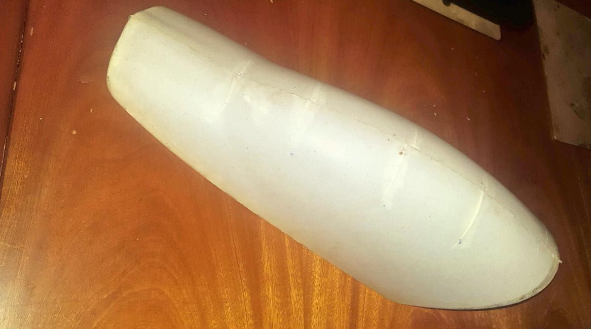

Finished work for the time being. Back on Amadeus.
Molded a canopy to get back in the groove.
A layer of 50 gm glass outside 1mm rohacell core 25 gm glass inside no gel coat. 200gm carbon joiner and around the flange, 85gm and nice and stiff.
It's OK but could be neater and could also loose 10-15 gm with out most of the carbon.
Name:	Amadeus canopy.jpg

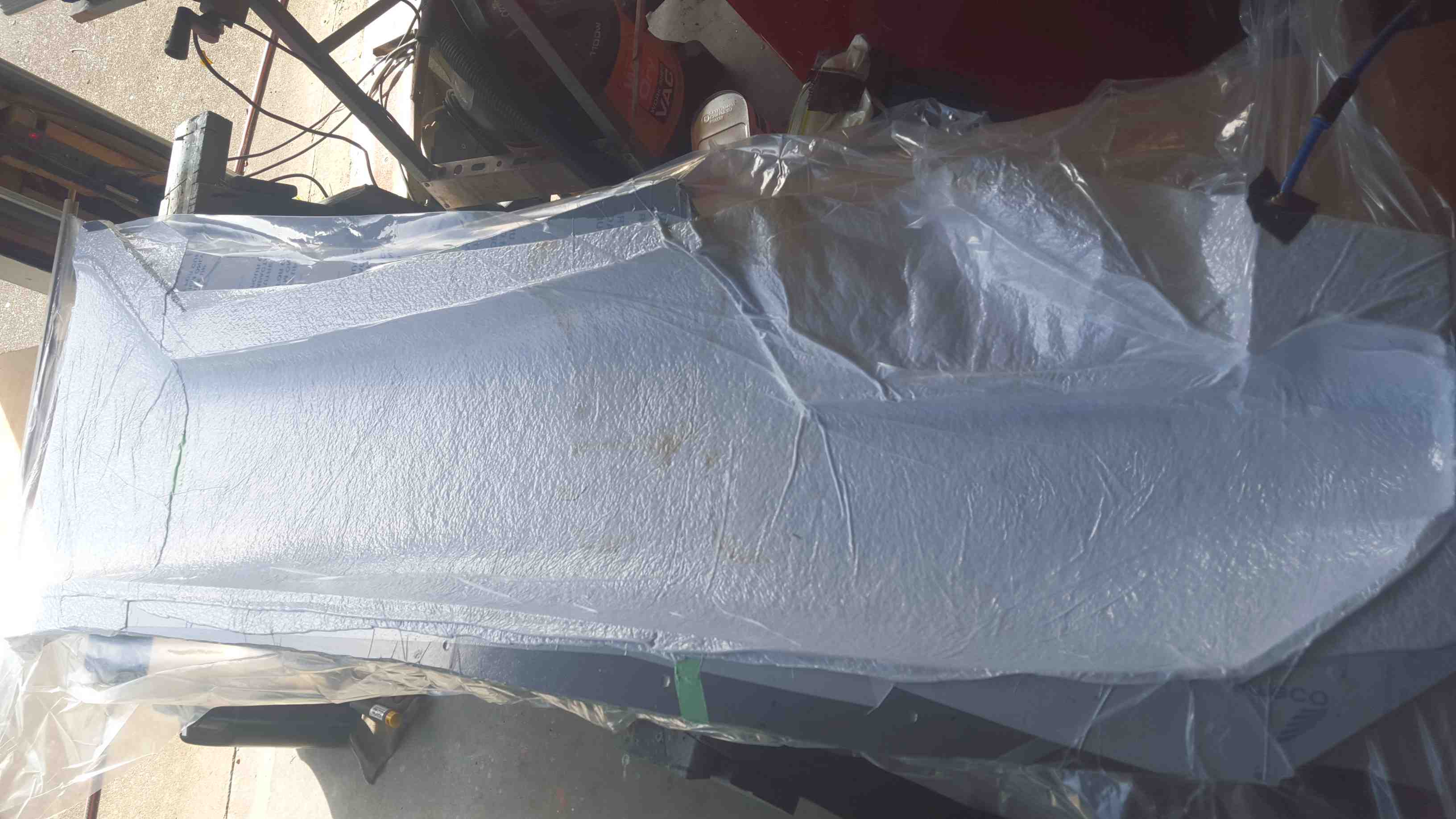

Old 06-23-2016 | 06:32 PM
  #122
RodneyFord's Avatar
Joined: Apr 2015
Posts: 424

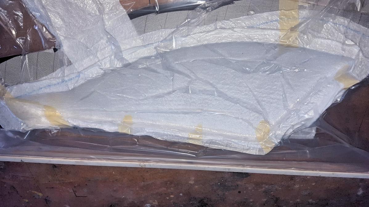

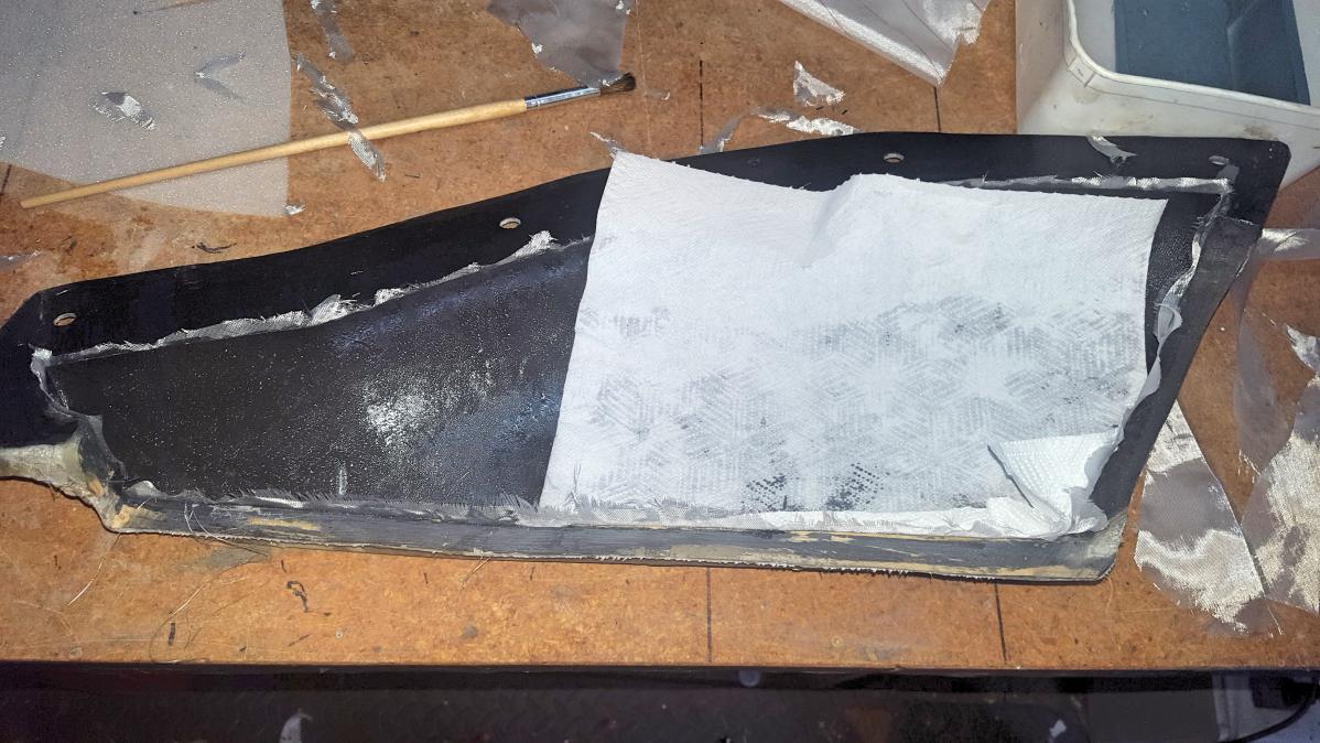

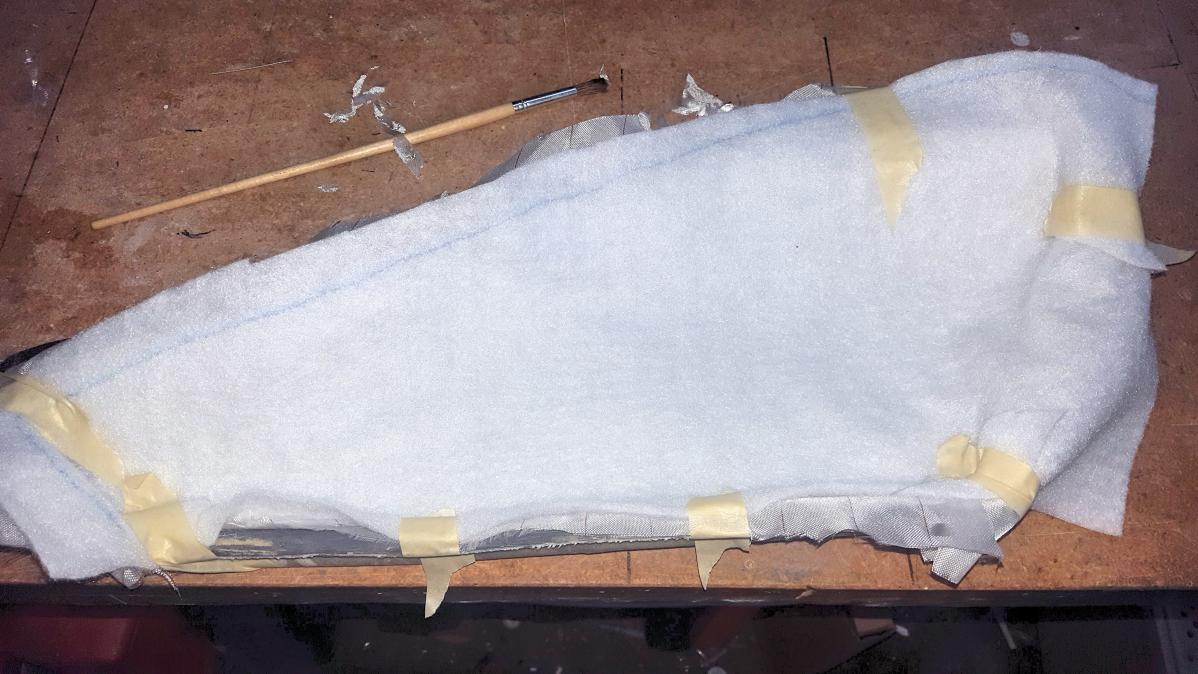

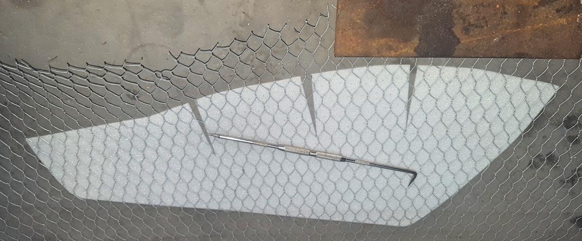

I am making another canopy to get a better result.
perforating core to allow resin migration
25gm glass on the flanges and 50 gm all over then blotted
Peel ply then breather. I found I don't need release film.
In the bag with plenty of folds to allow the bag to conform to the mold properly.
I'm trying an electric blanket to heat the mold. This should promote better resin migration into the peel ply and breather.
Name:	electric blanket.jpg
ID:	2169345   Click image for larger version
Name:	in the bag.jpg
ID:	2169346   Click image for larger version
Name:	peelply breather.jpg
ID:	2169347   Click image for larger version
ID:	2169348   Click image for larger version

Out of the mold at 60 gm so a 35 gm saving over the first one. The flanges are not as stiff but the rest is.

Beautiful work. Very nice weight savings. How much of the 25g savings do you think was due to the heat blanket?
-Mark
Old 07-01-2016 | 03:36 PM
  #125
RodneyFord's Avatar
Joined: Apr 2015
Posts: 424
Originally Posted by flyintexan
Rodney,
-Mark
Thanks Mark. The big difference is the lack of 200gm carbon cloth on the flange and joining. It still needs a little more stiffness in the flange now so I might make one more. A heads up for the fuselage which I will finish off next week.
