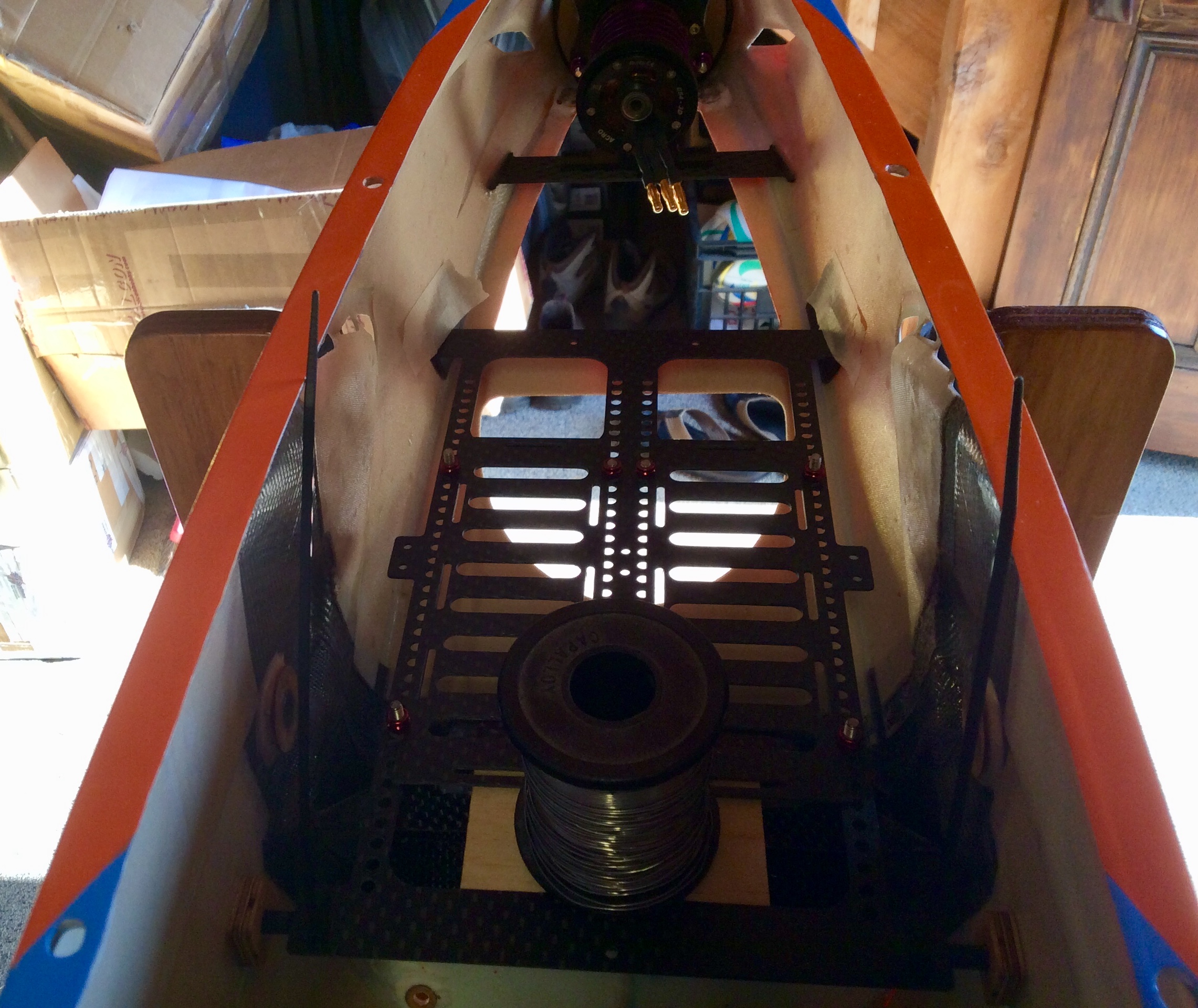

I should also mention the final weight came in at 4722 grams ready to fly. This pleasantly surprised me for a full composite model the size of the Alchemy. The packs used were Hacker TopFuel 4600 which are quite light and drive system is the Ralph Schweizer CRS with Mejzlik props. ESC used is Mezon 95 OPTO Lite.

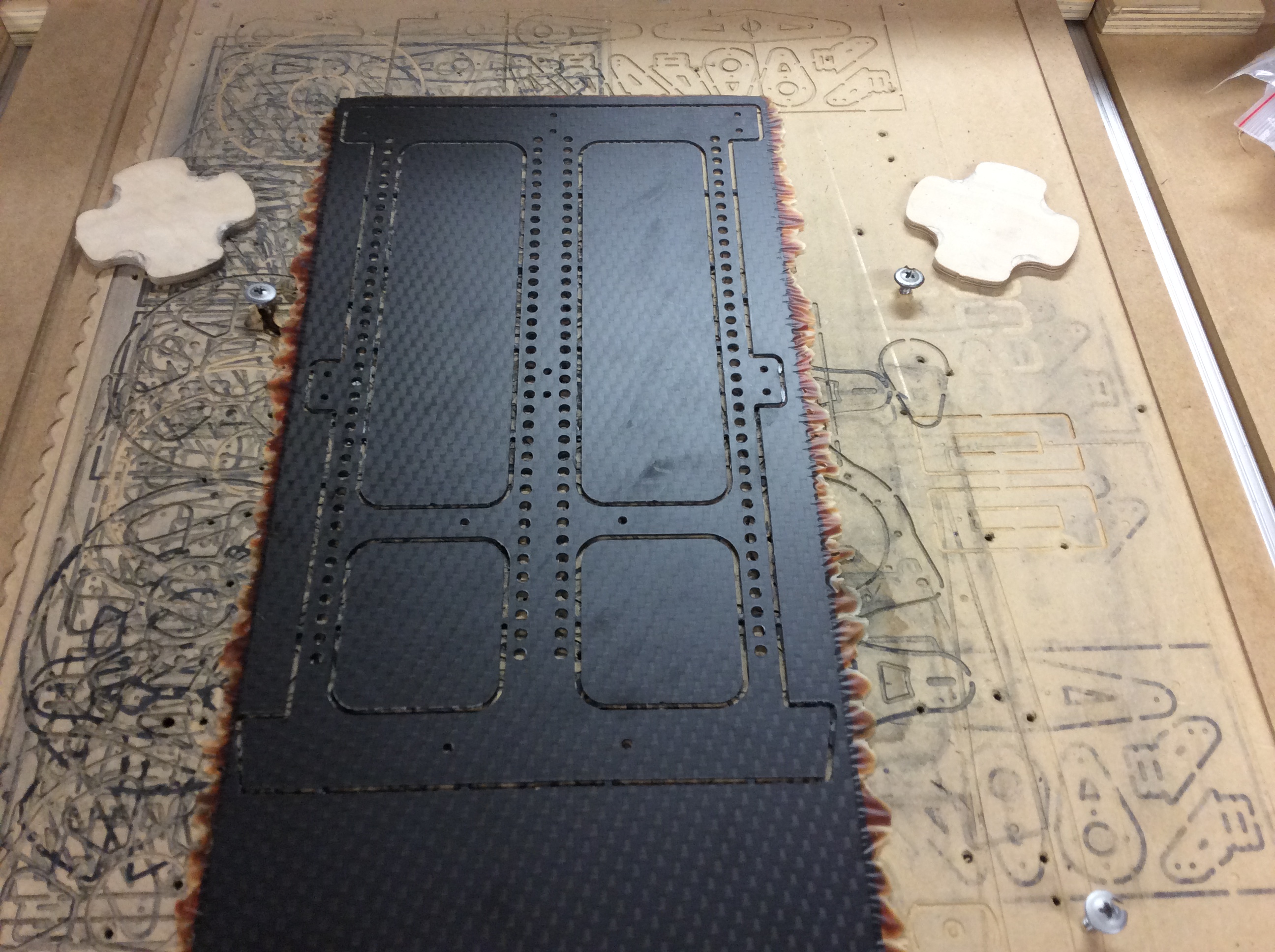

Hi Guys,
I’m not sure how many people are considering an Adverrun XS Contra for their Alchemy’s but I’ve just designed and manufactured a firewall to suit. Pictures below.
The material is 4mm Aircraft grade Finish Ply. The edges will need to be chamfered to suit the taper of the Alchemy nose.
Cheers,
Jason.

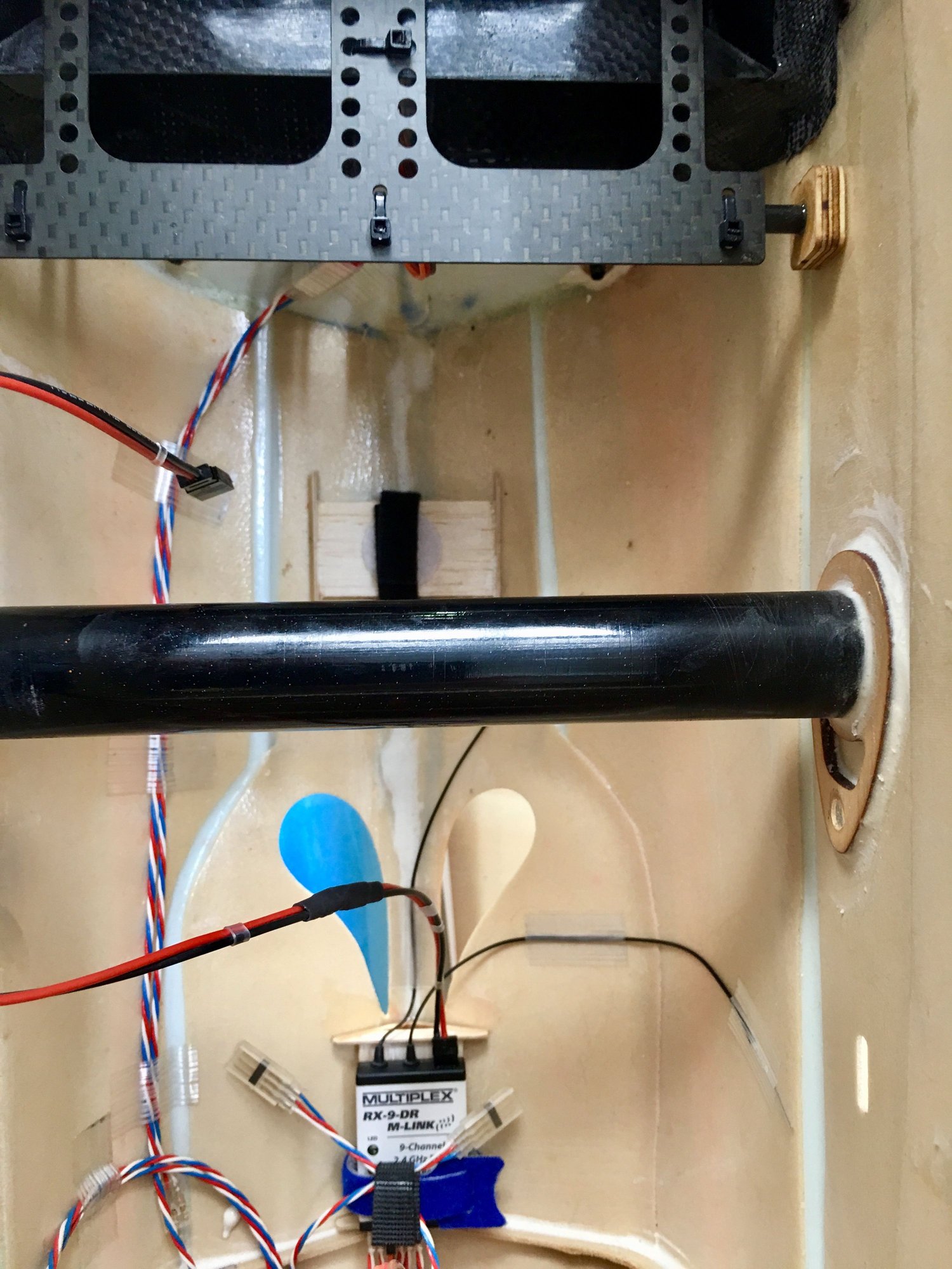

Here are a couple of pictures of my battery tray and RX position.
I'm using 4600mAh Hacker TopFuel packs and they are just in front of the UC gear module.
Regards,
Jason.
