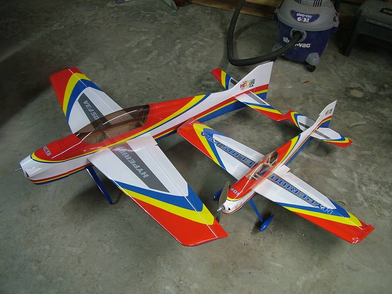

Just wanted to let you guys know...I just completed building and maidening the brand new Hyperion Helios 63e and 10e planes. Both are fantastic flyers. Both of them are superb flyers, and really excellent planes.

The 63e is FANTASTIC!
The 10e is really nice, but the 63e is even better.

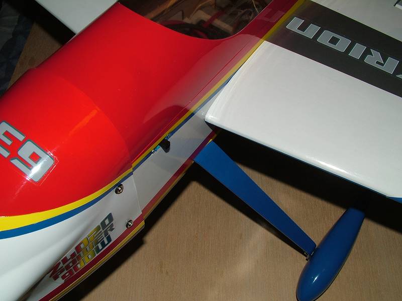

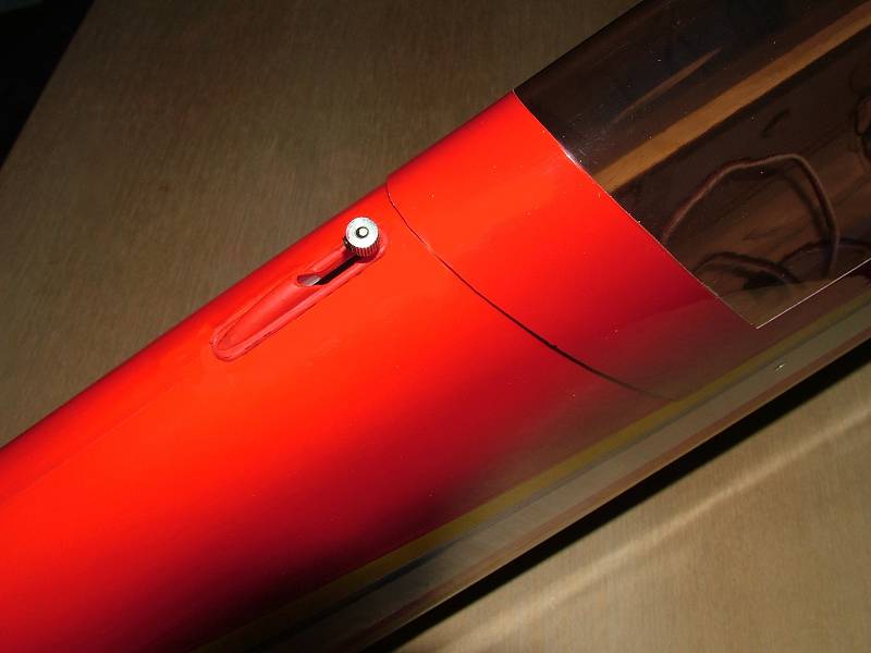

Here are a bunch of pics of the 63e. I modified the canopy latch as shown in the picture. I used a plastic exit guide and a wheel collet to make the latch easier to use.

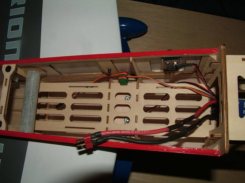

The plane flys very smoothly and crisply on rolls, and makes nice round radiused corners mainly due to the airfoiled stabs. Tracks like its on rails. The landing gear in the Helios 63e is strong. 1/2" carbon wing tube spar, nylon thumb screws for mounting the wings. Pre-glued incidence pins in the wings.
Ball link hardware. BIG battery tray, located dead center on the thrust line to make sure the plane stays neutral in the air. Firewall was pre-drilled for the hyperion motor. The Canopy is tinted, and has both magnets, and a strong spring-loaded latch. Fiberglass Cowl is pre-cut for ventilation, and its more than enough ventilation, as nothing in the plane even remotely gets warm. Tends to land same temps as it took off.

I think the latch is sweet the way you did it. I have to agree with you on how I recieved the smaller one, it was a fantastic build. I fly it in parks and just love it. A very sturdy plane considering its weight. Thanks for the pics. Phil
