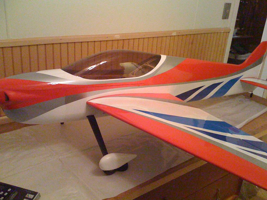

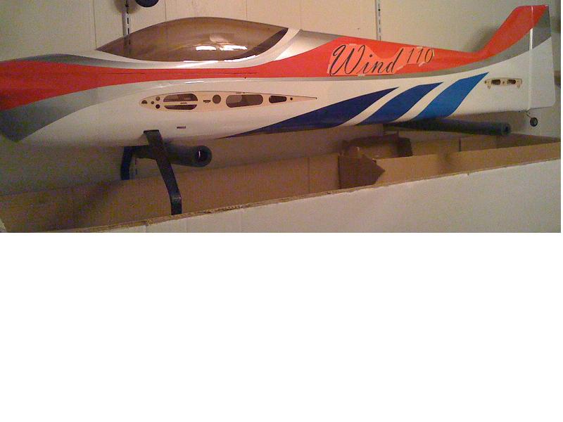

Location: Honolulu, HI
Posts: 7,056
Default RE: Sebart Wind 110
These pics really don't do it justice...looks frickin' awesome!

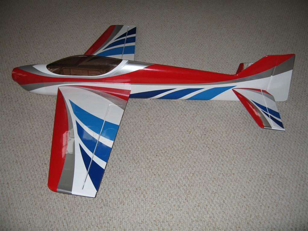

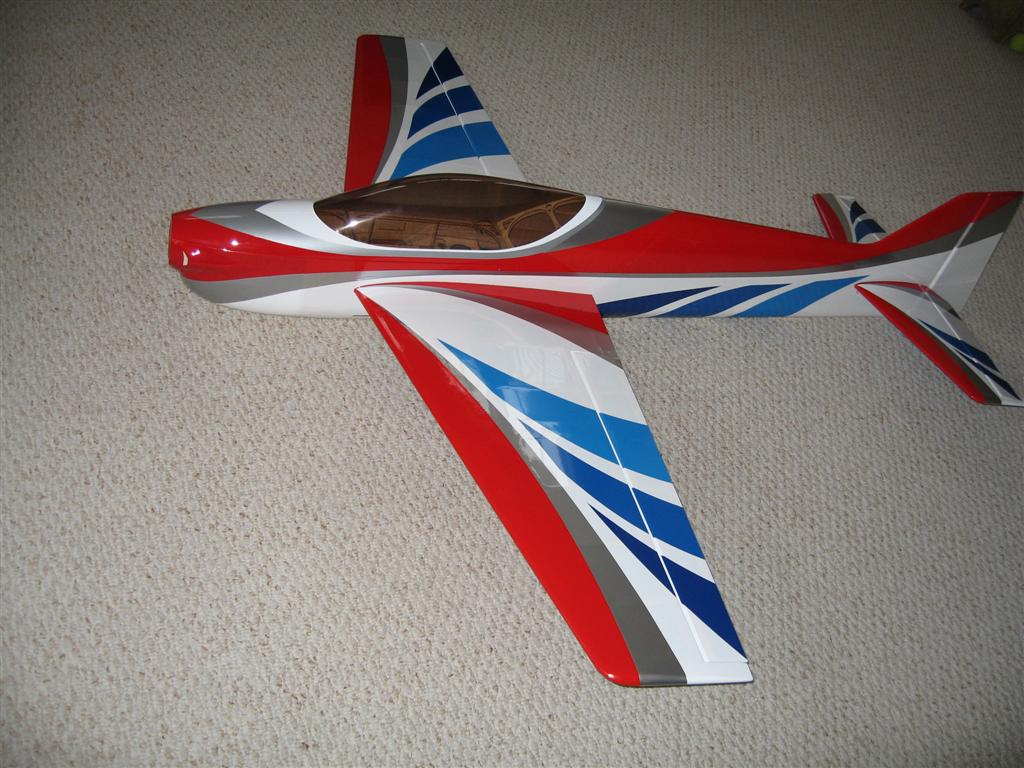

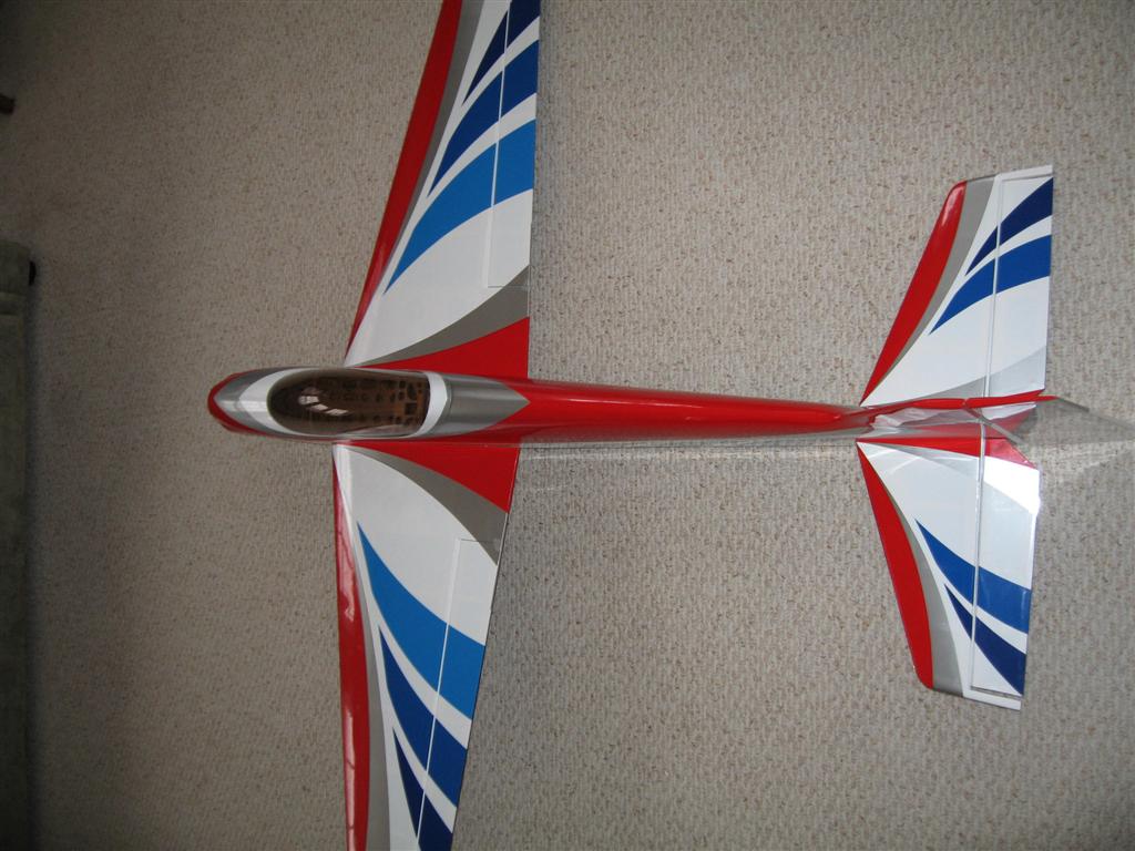

First shipment has arrived. These are really sharp looking planes! This is the red scheme. The canopy mounting looks very secure with hooks in the front and magnets and tabs on the sides and 2 screws into the back side tabs.

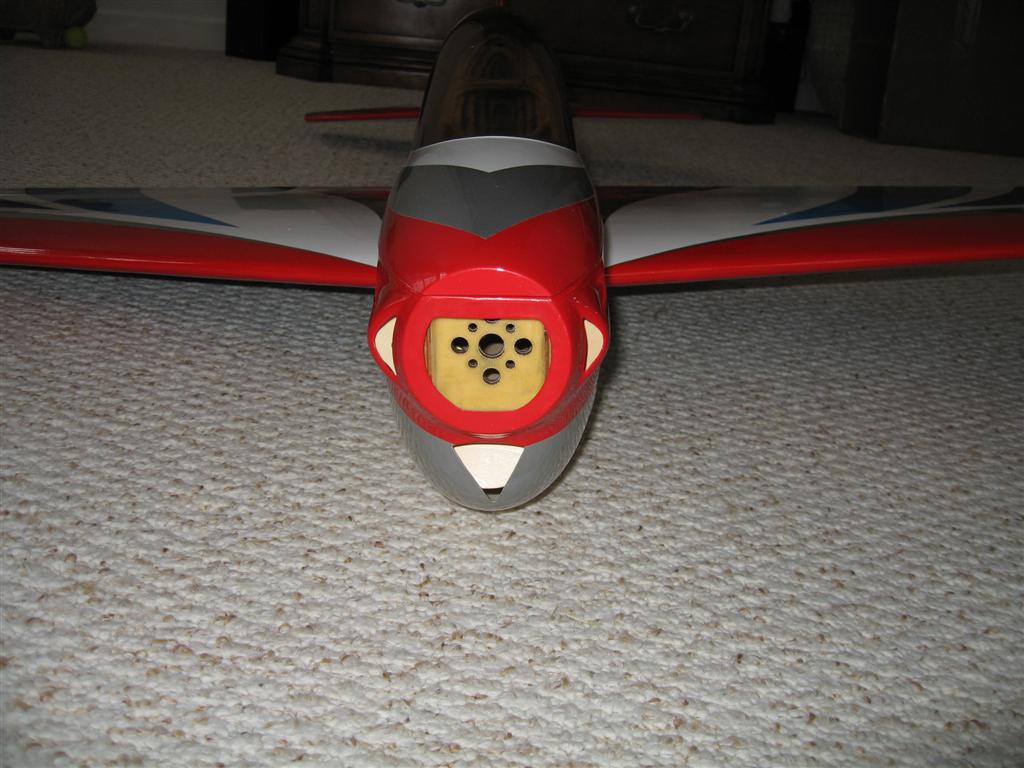

Question about mounting this motor:
There is a gold color shaft collar built into the motor 'can' at what will be the rear end, and a silver removable collar attached to what will be the prop side/front of the motor. This collar does not fit through the hole in the firewall. Probably a dumb question, but can I remove this collar or do I have to adapt the hole in the plane to fit? I was really hoping not to have to start cutting away at this beautiful plane.

Thank you Zebel. I also heard from a trusted friend in our club to leave the collar on, so that's enough for me.
I took the aluminum mount that came with the motor and cut the ears off, and mounted it on the front of the nose ring of the plane. I will use this as a guide for cutting the nose ring, and it looks like it should work out very well.
Also I made a mistake earlier on saying that the motor shaft was too large for the bearing - it is not. I thought the recommended Hacker came with a 6mm shaft, but it must in fact be an 8mm shaft also.
Going to try some patience and not cut the plane tonight, rather do it in the morning when I'm well rested, there is more light, and noise won't be an issue.

Dude ... you remove the collar. Its function is to ensure the shaft is secured when the prop is on the can. Do not drill the mounting. Then you will need the same collar at the back of the motor to hold the bearing in place. Look at my photo some where in this thread. The back has a plate that secures the rear shaft. It has a bearing. There will be a space of about 6mm between the bearing and the gold protrusion, that needs to be filled so the bearing stays in place. I used the same collar but its not tightened, used it as a spacer.

This is from Lucien. Sounds like the collar should stay, although I don't think this idea would work with respect to the prop adapter and spinner backplate. If I don't dream up something creative it looks like I'll be cutting in the AM.
Joe,
The silver collar is what holds the motor together. If you mount the motor
with the mounting face forward, the pull from the prop will hold the motor
together without the collar, but any time you go to idle, and the prop
starts to drag, it will push the motor back in a little bit. It will only
go a small amount before the attractive force of the magnets prevents it
from going any further, but it will go back and forth a bit. This can
hammer on the bearings a bit, and is not recommended.
What you can do is cut a spacer out of tubing that has an 8mm ID and a 9mm
OD that is just a hair longer than the thickness of your front mounting
plate, and slide that onto the shaft and then put the collar back on. Going
this way, you only need a hole that is about 9.5mm in diameter instead of a
16 or 17mm hole to fit the collar through.
How does that sound to you?
Lucien Miller
Innov8tive Designs, Inc.
1495 Poinsettia Avenue, Suite 144
Vista, CA 92081
Phone: 760-468-8838
Fax: 760-305-7749
