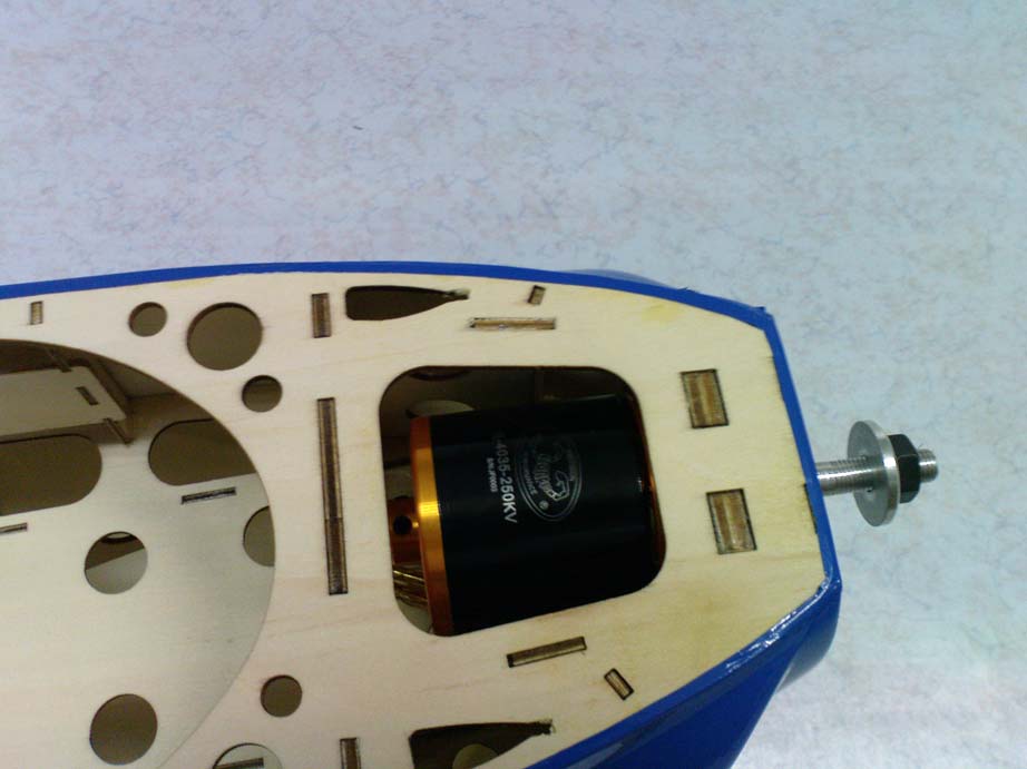

Default RE: Sebart Wind 110
Finaly THE Scropion 4035-250kv is here and i just put it in my 110 ..... fit in nicely no modification needed , as you can see in the pic below
I will go 10s setup .......

Huison ... nice nice! I can't wait to collect my motor ...
