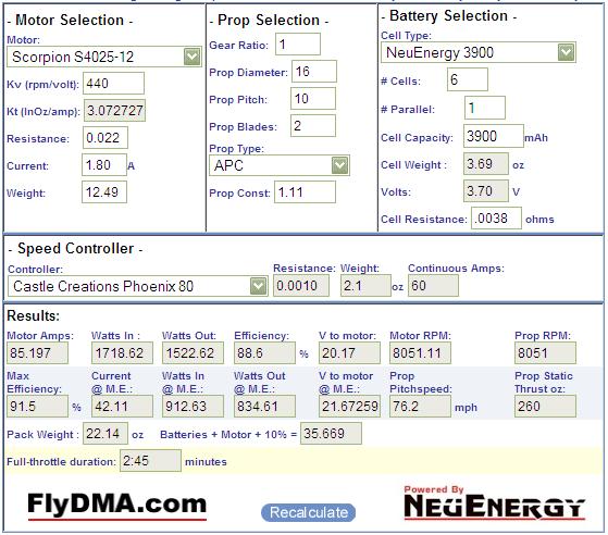

Well that was quick!
I got a PM from someone local to me offering me a Scorpion 4025-12 motor and a 90amp ESC with bec which he had bought for a Fliton 90 for 6S setup and had not used. I got the motor / ESC for a very fair price and have ordered my Wind 110. I can test it with my existing 6S pack and if the combo is not strong enough I can default to an 8S setup and only have to buy a new motor / 4S packs.
regards
