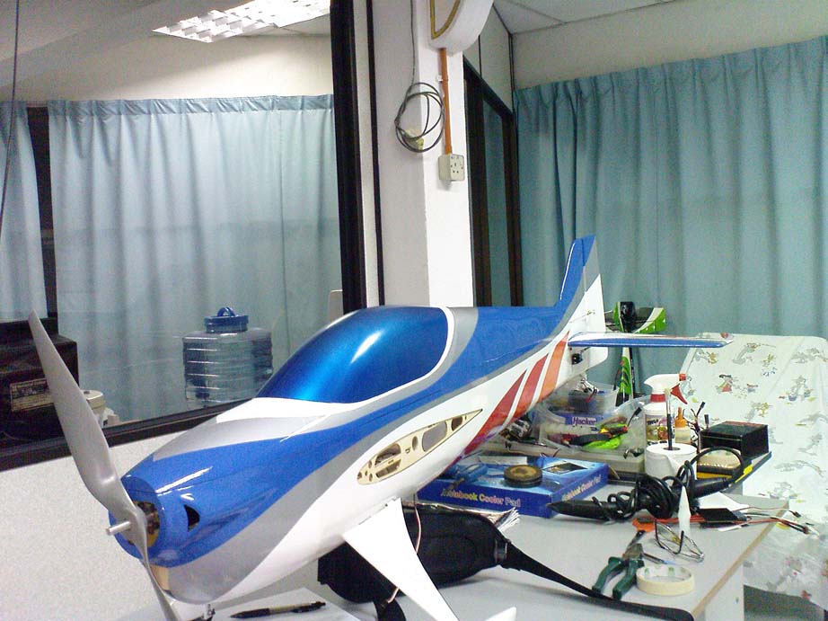

i just spray paint the canopy ..... will install the esc and do all setting , hopefully can fly it on Sunday !!

Canopy looks much nicer ... I may spray mine from inside and keep it all black
