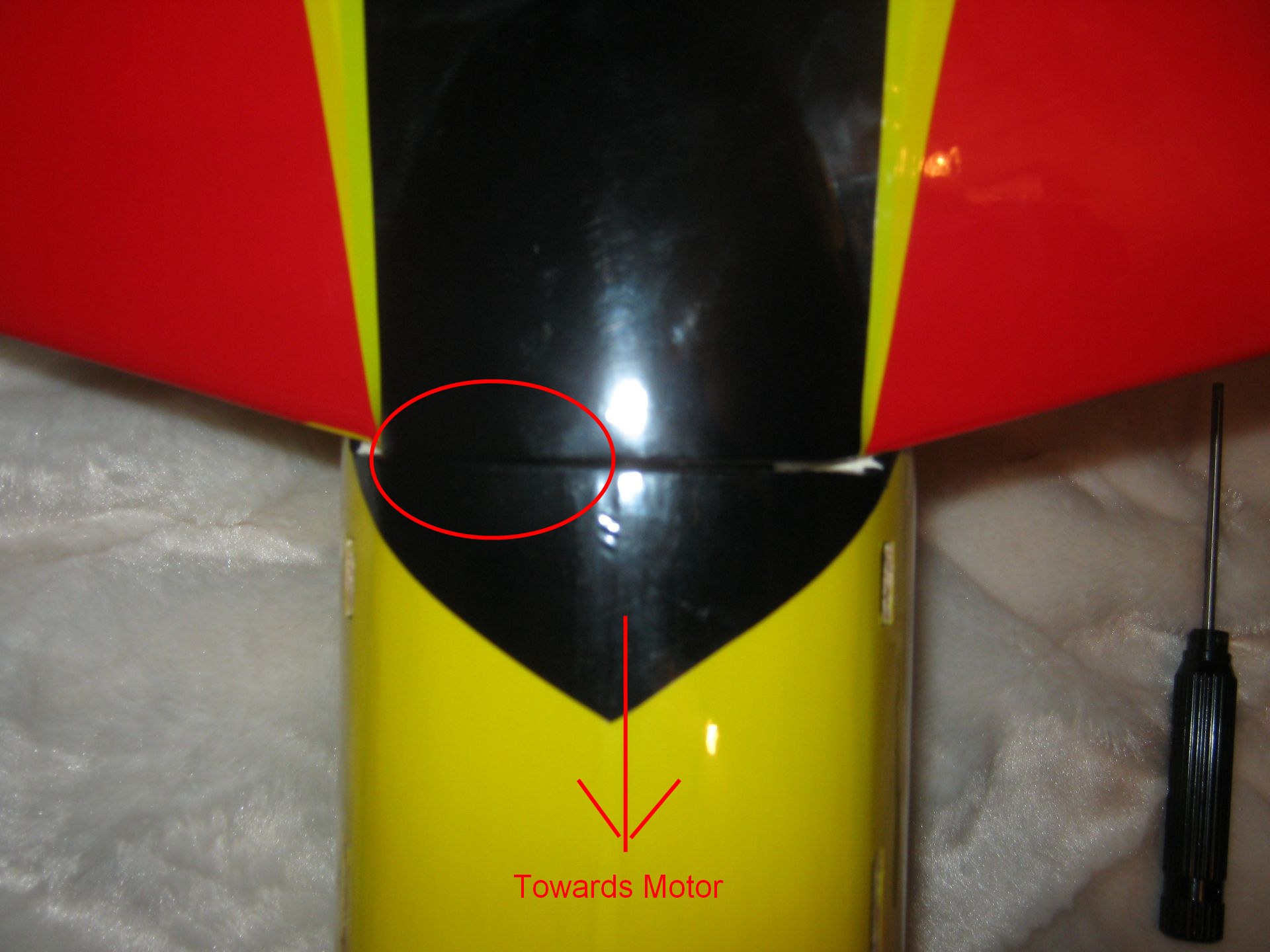

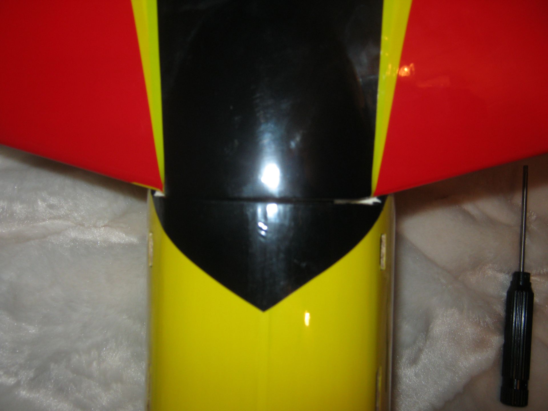

Here's the attachment that when missing from my previous post.. As mentioned it is not the best picture but you can clearly see the gap between the wing and the front former. I hope I'll be able to lift the covering and iron it back on once I've sanded down enough material. Time will tell..
- Thomas

Hi Thomas
I would be tempted to take a small peice from behind the wing and when its sits in properly into the sadle is should sit tight upto the former. If you alter the front you may find that the wing bolt will not line up and you then have to change that ,then the top and bottom wing supports wont fit and then they need changing and so it goes on and on. Mine is very tight to get it place..

The problem is that the wing bolt does not line up as it is now since the bolt hole in the wing is about 1.5mm too far behind due to the skew former. I could always enlarge the bolt hole in the wing 1.5mm forwards to make it align with the fuselage nut, but that would also mean that the wing would be sitting 1.5mm behind where it is supposed to be. I'm worried that this difference will make the alignment of the struts and upper wing wrong. It might also impact the lower wing incidence. By removing some balsa material on the front left hand side of the wing marked by the red ring in the picture i should be able to make it fit nicely and snug where it is supposed to with the fuselage.

Issue resolved. I peeled back the covering a few millimeters at the front of the wing and sanded around the middle and on the side which was touching the front former. The wing now fits in the saddle with a just a bit of pressure. Moving on to gluing the horizontal stab...

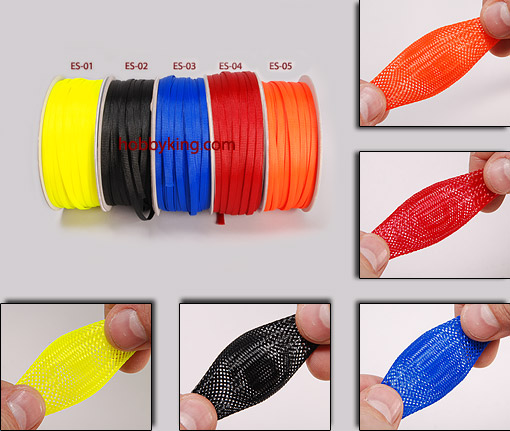

How have other builders secured the servo wires for the rudder/elevator to prevent chafing from moving around on the formers at the back of the fuselage. Its not very easy to get to the back of the fuselage to make any form of anchor for the wires, so I was hoping someone had come up with a clever solution that also makes it easy to perform maintenance on the servos if needed.

Servos are mounted in the rear of the fuselage, as originally designed. I just want a way to protect the long wires from rubbing in the fuselage formers. At the moment I've though about using some lengths of protective "mesh" similar to the picture below. But the wires will still be loose in the rear of the fuselage so it would be handy to find a way to easily secure them, at least near the cocpit where it is easy to get to.

Yes you could use that but its adding weight and the wires will still be flying around . what i have done is to reach in as far as i could and stuck double sided tape to each side of the turtle deck and them stuck the cables to this . this is the method i have used for years and its rear that they come loose. infact if its good tape you have a jobe removing them when you do a stripdown to change a servo.
Martin

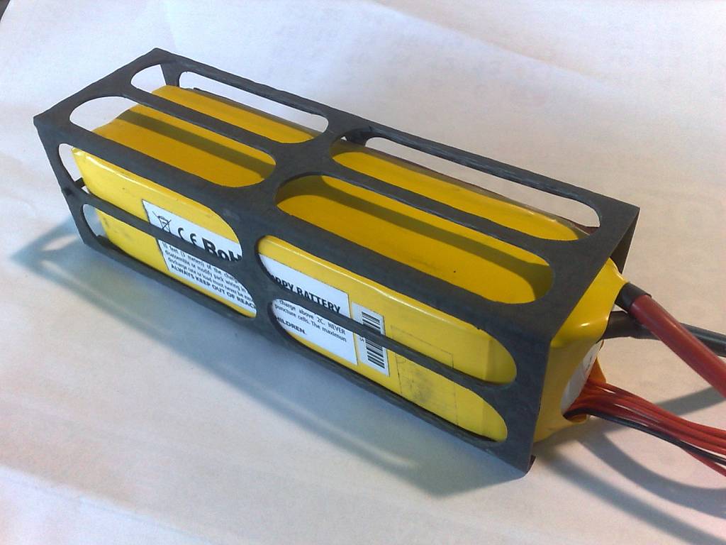

Do you know where your CG is located? Is it much further behind 120mm? I would prefer to solve the CG issue without having to add weight if possible.One option I have is to move a 700mha LiFe RX battery (about 40gram) further back above the lower wing. This is currently mount just behind the motor. Makes it a bit more difficult to get to if it needs to be charged, but if it solves the CG issue I guess I can live with it.
I also had a reply from Roberto P and he can provide the same cage as he makes them. If relocating the RX doesn't resolve the issue I think I'll go with the lipo cage.

You can use some very lightweight servo wire tubes
http://www.f3aunlimited.com/gator-fe...-5-pack-gt1001
