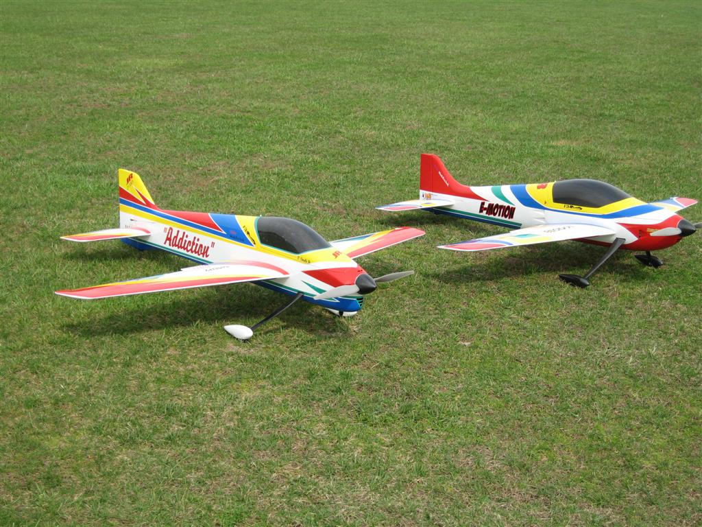

Larry test flew his #2 E-Motion today together with JR making his first flight with his Delro Addiction.. Flew exactly like his first one.
Really nice job, Larry. Congrats to both you and JR.

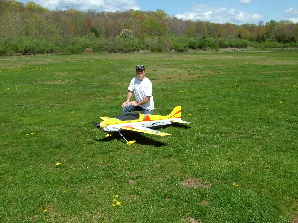

Finally got to pick up my E-Motion and bring it home, but not before a day of flyin' with the "Delro Boys". I can't get over how great it is to have a plane "professionally" built and trimmed. Thanks again to Chris, Larry, and JR for making an awesome E-Motion! Now I just hope I can practice enough to make it look like I know how to fly it the way it should be flown.
Thanks again guy,
Joe
