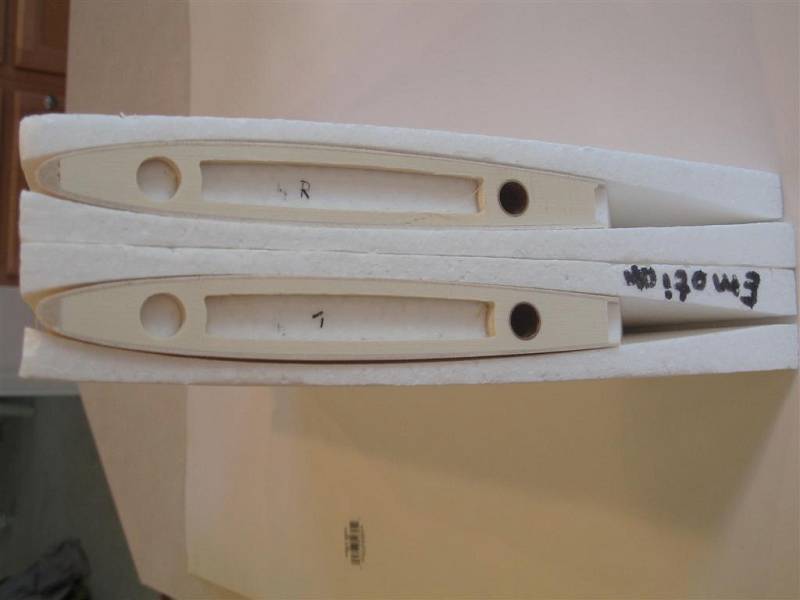

Misc parts: 30mm wing tube and fuse socket, stab tube and hardware, honeycomb former sheet, wood package, fiberglass wheel pants, carbon fiber landing gear.

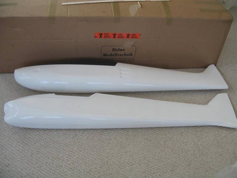

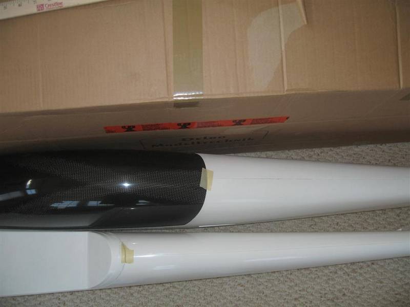

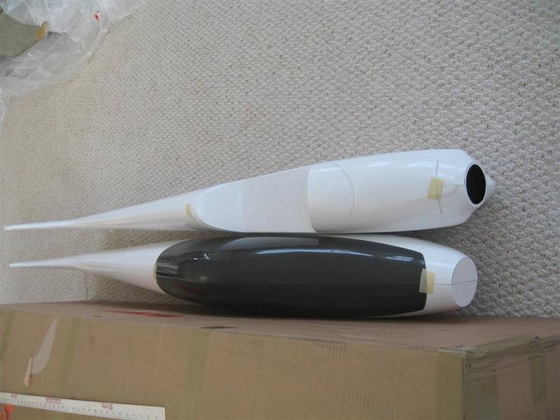

The E-Motion fuse is larger and wider than the Addiction. Here are some side by side pics. The Addiction is missing the plastic canopy in these pics:

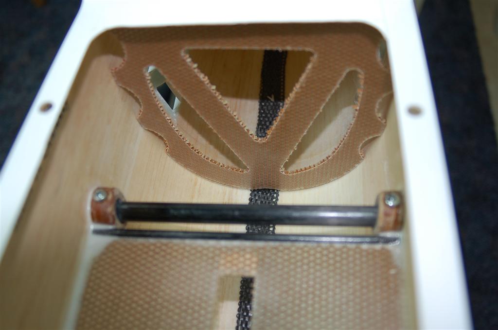

6. Installation of the wing tube and wing adjuster is the next step. The location of the wing tube must be finalized before the rudder servo mount and the carbon rod cross brace can be correctly set. I added the carbon/ply supports joining the fuselage sides and the wing tube. They are not included in the kit. I guess just a creature of habit. I have checked the tube location molded into the fuselage and so far all looks fine. I am using the provided scribe marks on the fuselage for wing and stab incidence. I’ll take a final check between wing and stab incidence and make certain wing and stab tips are of equal distance before final install. I can’t get over how fast this kit builds. Total work time to this point 6 hrs. Looks like a rainy weekend. This airplane could be ready for initial radio set up by Monday.
7. The wing tube is tacked glued at this point. Wing tube and wing is level with the fuselage. Stabs are next. The stab tubes are already set in the stab and the location on the fuselage is also marked. I have been very careful while cutting out the area in the fuselage for the location of the stab tube. I am adding plywood donuts around the stab tubes for extra support and piece of mind. They are not included in the kit and probably not needed as the fuselage itself should provide enough support. Again something I have grown accustom to.
ID:	1195580   Click image for larger version

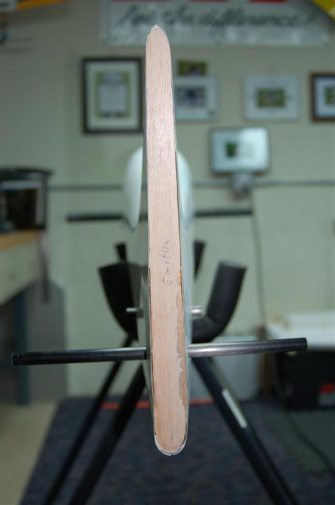

Rudder post installation

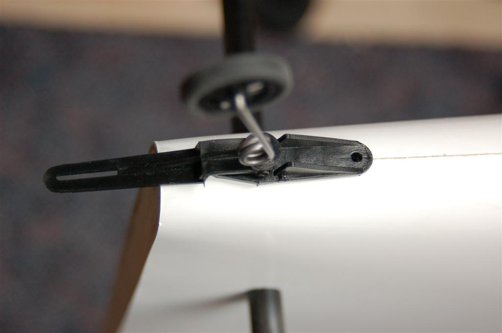

Delro tail wheel assembly (not included in kits but available)

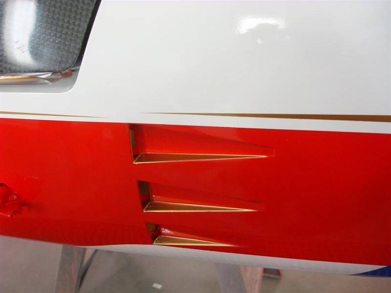

Additional air inlets added by the builder beneath the nose area (not required by kit instructions)

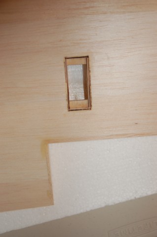

Pics attached:
Wing and aileron detail ready to cover
Aileron servo box detail
Canopy mount detail (2 pics)
Fuselage getting ready to paint

Old 05-24-2009 | 10:41 AM
Chris Moon's Avatar
My Feedback: (8)
Joined: Dec 2002
Posts: 1,366
From: Leesburg, VA
Default RE: Delro E-Motion kit
Fuselage is now complete except for rudder cable exit which will be put in after exit location is determined. The fuselage seam will require a very small amount of attention before painting so little to no additional weight gain is expected there. I’ve decided on DuPont Base Coat Clear Coat using 50% reducer with the Clear Coat. Tests have shown a much lighter final coat with an excellent gloss finish. Because this is electric I won’t have to worry about fuel problems. Once the fuselage is painted I’ll report its final weight.
The wings come ready to cover. No additional sanding or filling is needed. You will need to install the aileron servo mounts that are included with the kit. I found that the boxes when completed are much too deep and will need to be shortened. The locations for the aileron boxes in the wing are also cut. You will need to remove more foam to allow for the depth of the servo. I’m using JR 9411A servos on the wings. The servo mount proved to work well with the 9411’s. Use a hot wire to clean out the foam in the mount area, glue in the aileron servo mount and fill around the mount for a good finish. This was an evening’s work.
The stabs do not come precut for the servo mount and no servo mount is provided. You will need to determine the location in the stab, construct a servo mount in the stab and cut out the foam and balsa skin. I set the servo location perpendicular to the trailing edge of the stab. Your servo mount will be on an angle once finished. Be careful not to locate it over your stab tube. Not a good idea! I’ll not go into the weeds on this. Experienced builders will have their own ideas on how they wish to finish this area. I did find JR 3421’s fit with no issue.
All wood for the capping and beveled portion of the elevators and ailerons is included with the kit. The wood furnished in the kit I am building was not to soft but easy to work with. The elevators and ailerons are routed in the areas you will be adding the capping and beveled portions too. I found this to be a great idea. I knew exactly the length and location of cuts needed. The area routed out proved to perfect. Once the elevators and ailerons were completed they matched the back edge of the wings and stabs perfectly. This again was an evening’s work. I again will report final weight when completed.

Secret spy photos of the 1st E-Motion in the U.S. sitting in the Virginia paint shop. More pics to come shortly and flight report very soon!!
