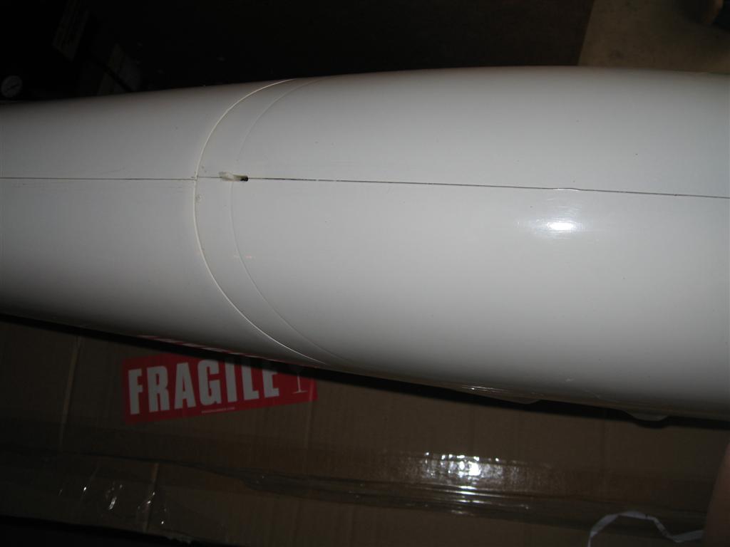

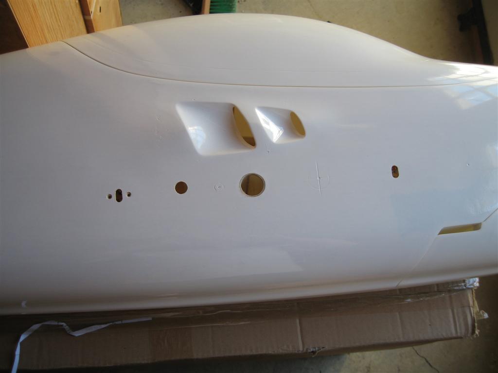

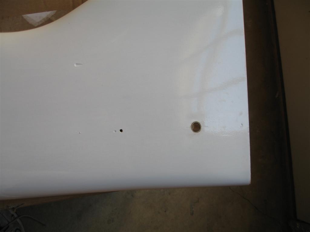

more.

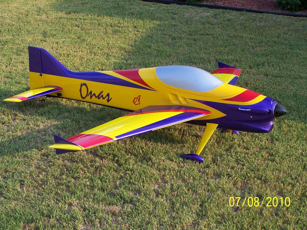

I will be finishing mine tommorow I just need to finish install servos this one is glow Ys 170 looks like the final weight is about 10 pounds

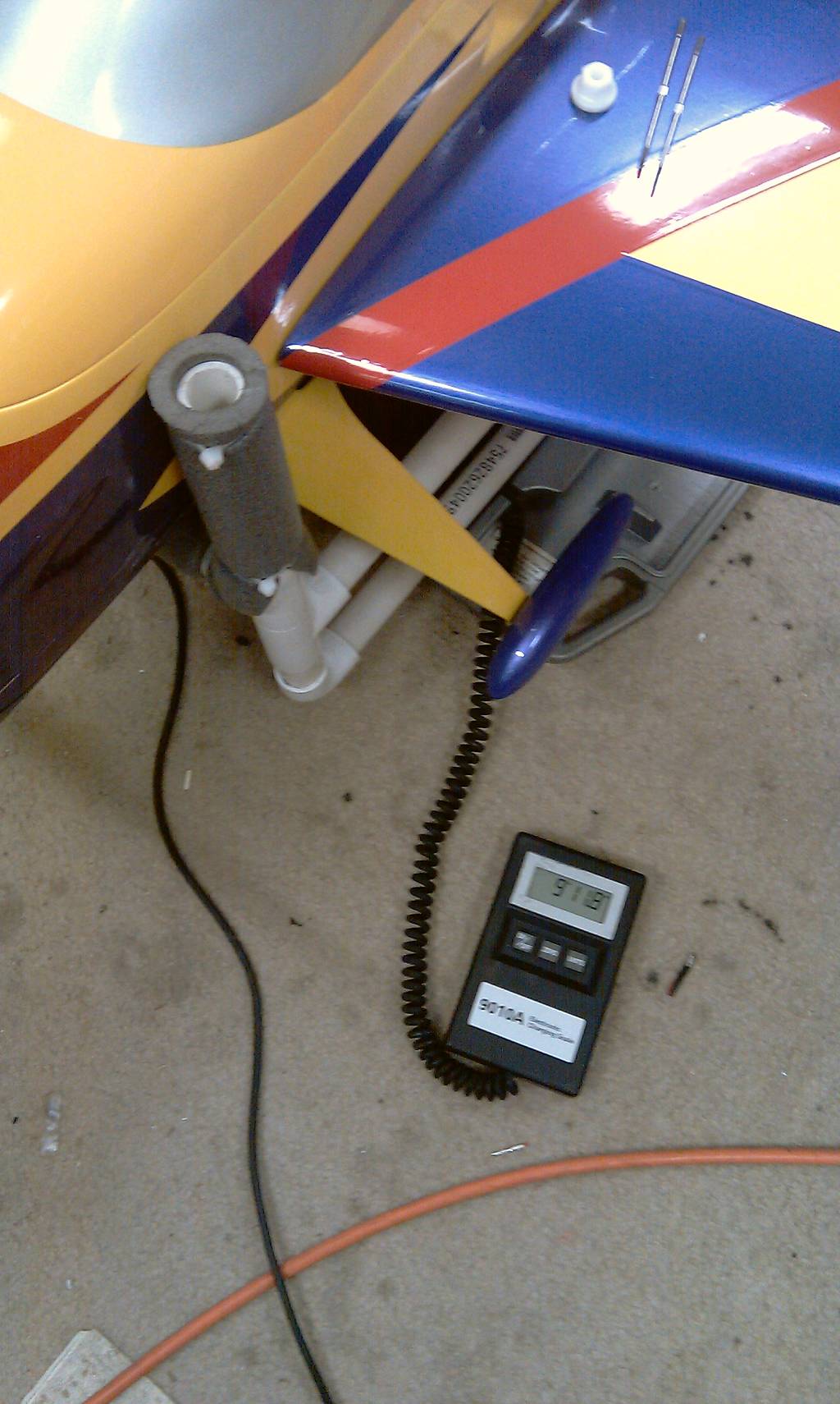

The final weight of my Onas

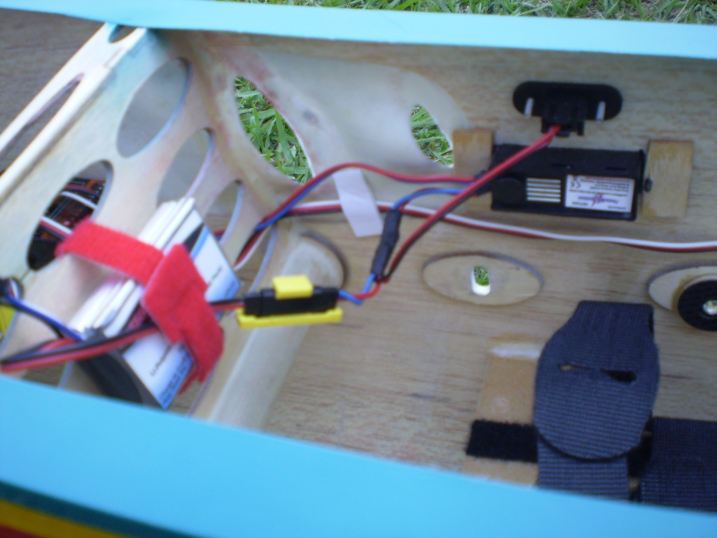

Hello Alejo.</p>
I just fly my Onas last week to, if you place the power battery in the try that is comming placed in the plane sure you will be nose heavy, i was moving back the battery until I lost it during a fly, almost lost the plane in the four fly.
I extend the battery try, the cg is just in the wing tube, the plane fly very well, the rolls are axial, the stalls are clear and the snaps are amazing.
Move from glow to electric power is not easy,to fly electric is different, you have to control the power a lot, because you have to much power.
