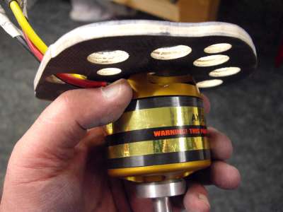

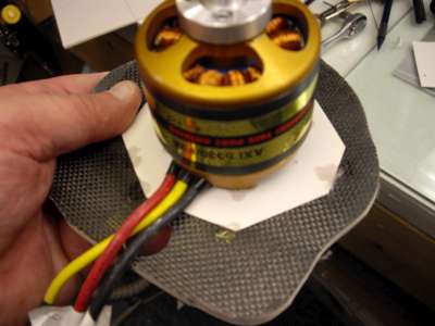

Last night I started the firewall and I thought I'd post some pics of the progress. All this took me about 4 hours. I'm not the fastest nor the slowest but I have learned to be patient and only work on critical things when your in the right frame of mind. Working on planes when it's strictly a chore tends to lead to sloppy work that hurts you in the end and causes rework.
The material for the firewall is 1/4" liteply. I laminated it with carbon fiber cloth. I've selected the AXI F3A outrunner. for installation and will be starting off with a Himas 6330 F3A new on the market.
The Himax is supposed to compare well with a Plettenburg Evo 30. I have 2 Himax mototrs now so I'm putting my faith into the reports that they are very stout and are showing excellent numbers. The motor is 2 ounces lighter than the AXI and sells for about $250. I will have this paired up with the new Castle HV80 Ice to start. The reason I'm using the AXI for mounting puposes is that it is a bit longer than the Himax and by doing this I will only need a washer to allow the Himax mounting and can then go back to an AXI if I deem necessary.
The Himax has a hole configuration that allows both the AXI and a Pletty so I will drill all 7 4mm holes so I can even put a Pletty in if I want to. The Pletty Evo's are the standard bearer outrunners for F3A and I had one last year in my Fatboy/Sickle. I choose not to continue with one because of cost. I get a kick out of doing E. pattern with a budget in mind. It gives me the ability to show others that this deal is not that expensive and it can be done inexpensivly. Heck the setup I had in my Integral at the 2008 Nats had an AXI F3A that I bought from a friend for $140 and an CC HV85 Esc that I got used for $120. So all up I had a $260 powerplant that was way more power than the plane needed and was always reliable.
The firewall is fixed into the fuse and the motors has to come out thru the nose. I secure then in with Gorilla glue that I put into a disposable glue syringe. I then spray a touch of H²o on it and let here dry. I transfer the hole pattern to the firewall using a piece of card stock it get tack glued to the motor back and the holes located then I tack that to the firewall once in place and remove the motor side. From there you drill the 4MM holes into the firewall and Bam!!!! It fits perfect.

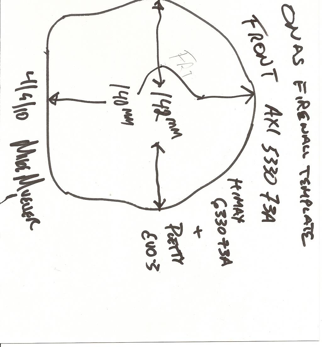

I have a template for the firewall I'll scan and post.
The firewall installed weighs 38 grams.

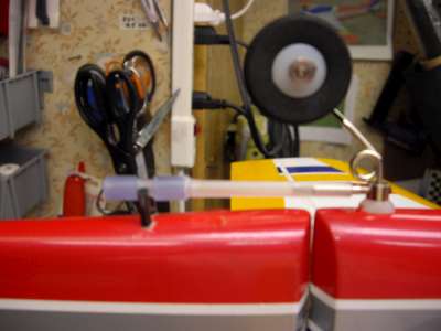

Hooked up the elevators, Mounted the servos into the fuse. I'm using the Airtronics 94761Z's for this.
I really like the CA/Chip control horns with the ball bearing clevis.
I use .125" Carbon Fiber tubing for the pushrods. I start of by drilling the CA clevis inside to 1/8". The CF tubing is then a snug fit and I used thin CA per Tony to glue the rods in. This is a nice secure tight fit that I'm confident will work. I made sure I did what Todd mentioned and put the screw side on the outer most ball bearing side and attached it the the horn.
On the servo side I first cut some 1/8 inside dia aluminun tubing to about 1 1/4"'s. I measure the proper length on the CF and cut it. Then slip the aluminum over the CF and CA it in with thin. Next I put a 2/56 sullivan rod/stud half way into a hand drill. I then apply some thin CA to the threads and drill it into the hole on the tubing. The Aluminum outside stops the CF from splitting open. This make an extremly light pushrod and I've been using this for elevators and ailerons for a very long time with out any failures.

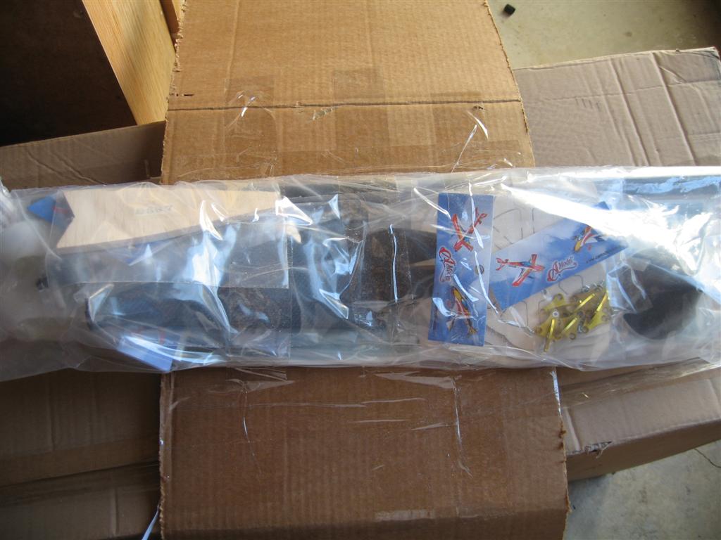

I received my new Onas yesterday, and wanted to mention how well packaged it was, different form all my other Camodel airplanes, very well distributed and protected.
I was also impressed by the installation of the battery tray, rudder servo plate and formers already installed, choice of firewalls for glow or electric, wow, it does looks so nice and clean.
Very nice improvement in all aspects!! Well done Camodel.

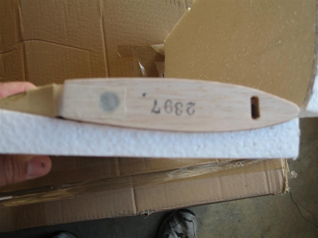

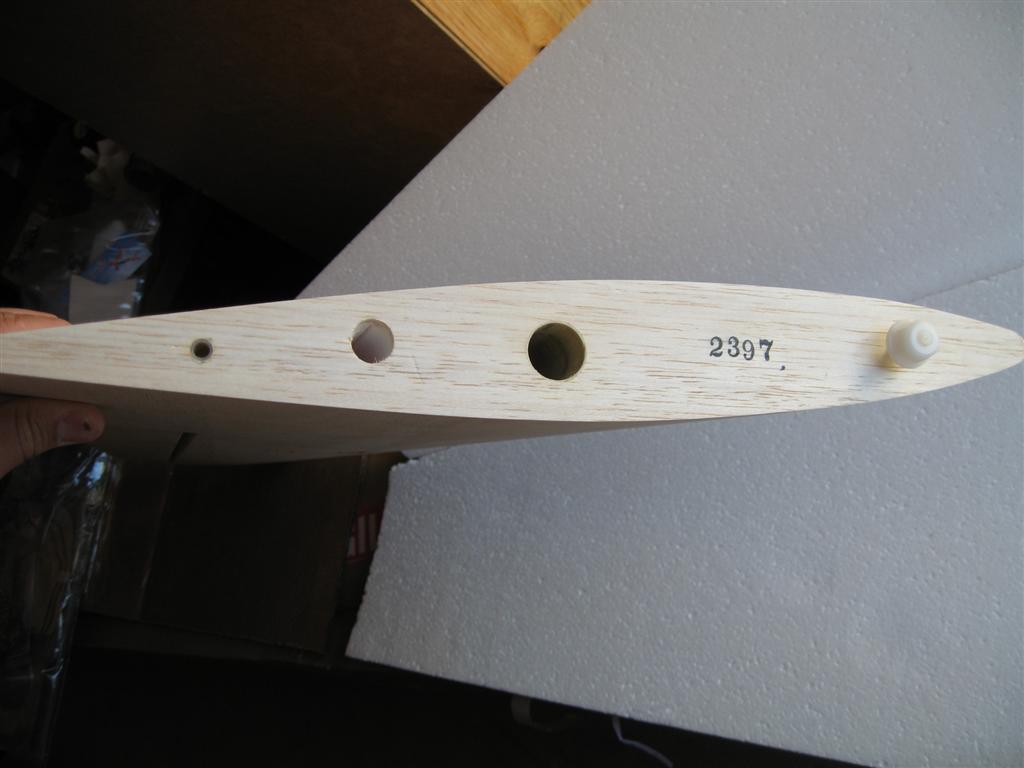

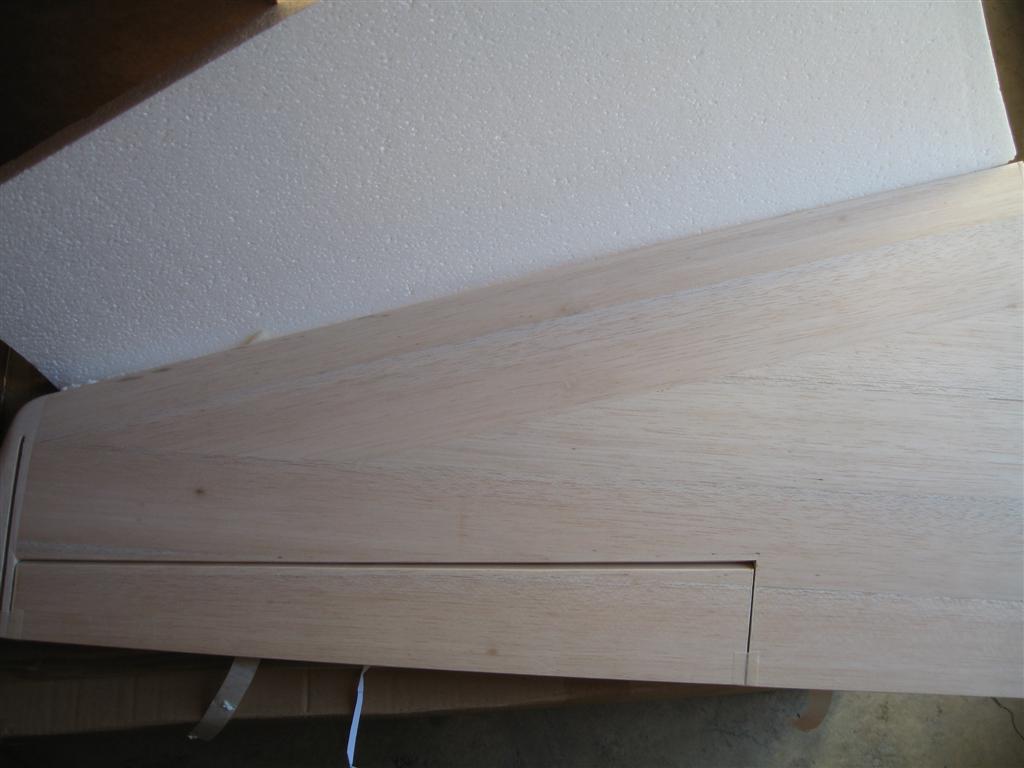

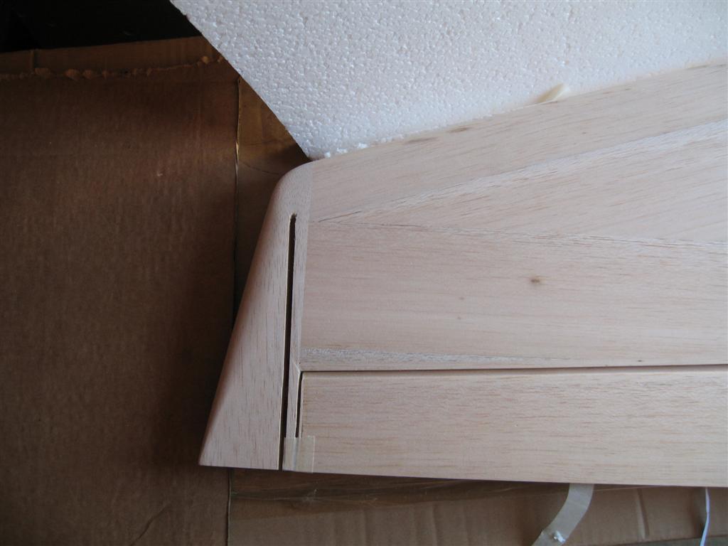

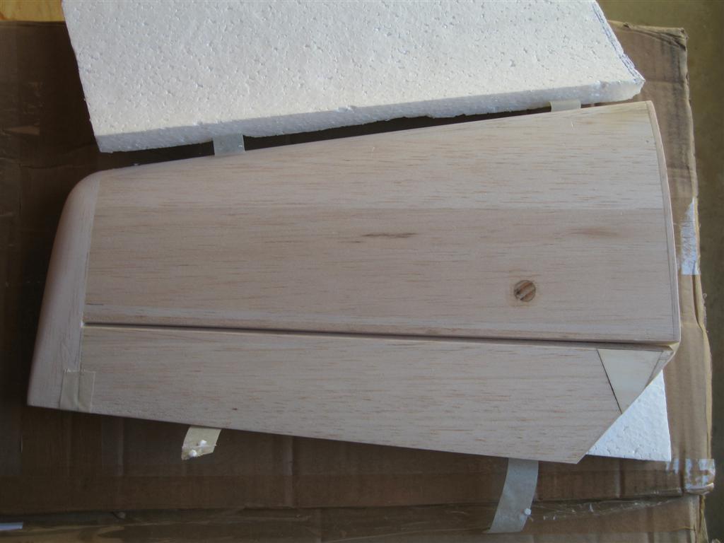

Details of the CA Model Onas ARC - now in stock in the USA.
wing panels are 9.8oz as pictured; ready to cover
Accessory package includes spinner, wheels, gear, pants, alum control horns etc.
