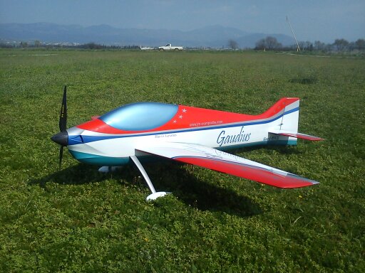

After almost one month of waiting for my batteries i maiden my Gaudius yesterday.
My setup is HACKER C50-14xl, SPIN99, SAVOX servos, POWERBOX digi switch, and RHINO 4900 battery, final weigth with carbon sninner and 21x14 PT MODEL carbon prop is 4770gram. Weigth of each battery pack is 1215gram.
The power is great and the handling was o.k and needed about 3% rudder to aileron and 2% rudder to elevator for left knife edge and 1% rudder to aileron for right knife edge, also 2% throttle to elevator for downlines. The plane flies slow and it tracks very well but i have to use it.

Some photos....

Harris-G - I'm surprised you need even those small mixes. I'm only using a downline mix and everything else neutral. Are you sure your CG is correct?

The Gaudius likes a very fwd c/g to get the best tracking and neutral flight. Steve, I think Larry had it figured out with yours.

Steve : At first flight the C.G was at 15mm in front of wing tube and he plane tracks very well it needed no mix rudder to elevator but when i made knife edge from one side of the box till the other the plane rolls, so i found it too much nose heavy for my taste and i had to put the mix rudder to aileron. When i move the C.G about at the first half of the wing tube i had to put that little mix rudder to elevator only for left knife edge, the rolling couple didn't change, but i found it more confortable for my to fly.
I want to thanks Ola Fremming for all the details and setup he send me for my plane...

A slight roll or pitch to one side or the other that takes the entire field length is not something I ever worried about. The length of time we spend in knife edge is so short it doesn't matter. I've found that with these mixes, even as slight as they are, have far more affects for rudder corrections when NOT in KE than I find acceptable. Therefore I removed all the mixes I had in my airplanes except the slight down elev and low throttle.
Nothing worse than making a rudder correction and having the airplane pitch or roll on you.

Wonderful Canopy! I like it!

Tim: Its all about personal preferences... I like to have all my mixes on,that's help do more clean my point rolls...
HotFlyAlex: Thank you. The color of my canopy when i took it from Mr Mach was dark blue and i decide to paint it. And this is the result...
Steve: If you move the C.G rear you will see that the plane also tracks well and it is very stable, i had the same discussion with Ola and he told me that i will not have any problem with stability if i move the C.G so back.
The day that i maiden my plane was rather windy, and now i wait for a calm day to go and fly it again to check my mixes...
