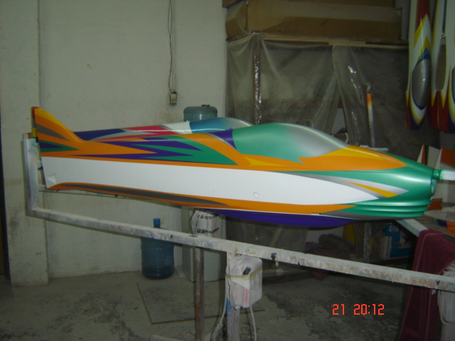

Jons Visa ready for clear minus the logos.
ID:	1422281   Click image for larger version
ID:	1422282   Click image for larger version
ID:	1422283   Click image for larger version
Old 04-21-2010 | 06:52 PM
  #328
cdodom's Avatar
Joined: Jan 2008
Posts: 396
From: Lakeland, FL
Default RE: CA Models VISA
Amazing Chip!!! I'm loving that green.
