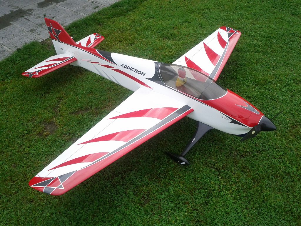

Plettenberg 30 – 10 Evo, Schulze 32.80KA and Hyperion G3 5Ah 25C
I have scratch built a new rudder which saved me 40 grams and have a std size servo up front with pull pull wires to a MK bell crank.

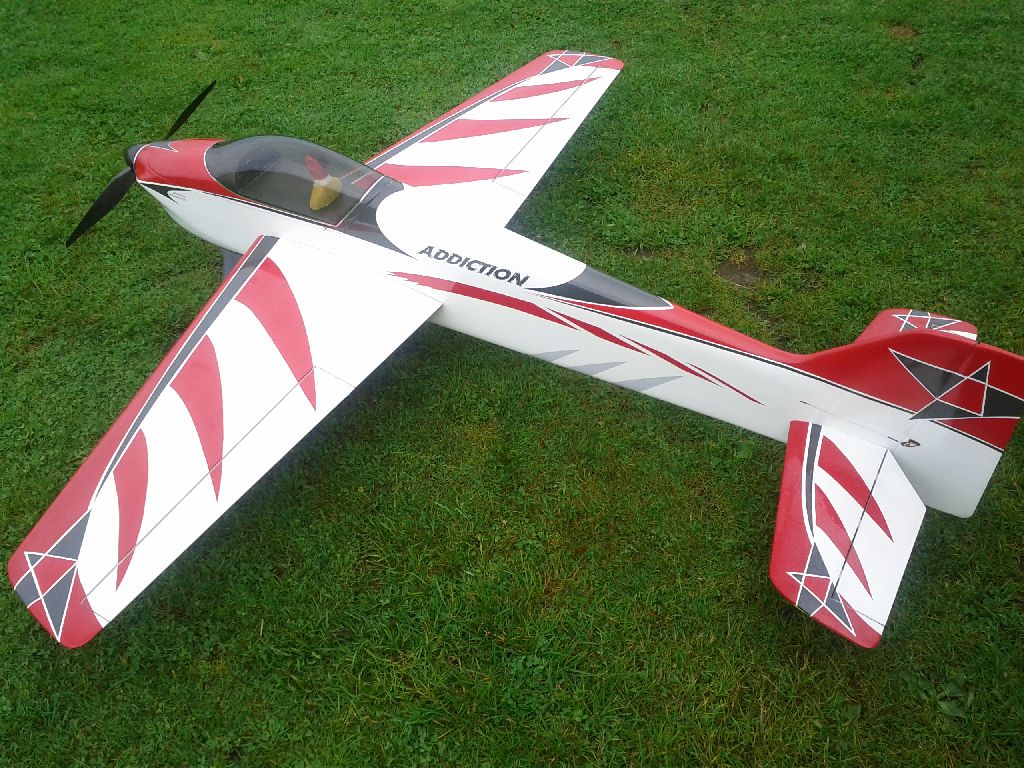

I managed to get in 16 flights last week (for me this is a lot ...!) with my new Addiction. After som minor adjustments I think the basic setup is now completed.
The model performs very well, and has a very locked in and neutral behaviour. In fact I have no mix at all, except for a few % low throttle to down elevator.
My final settings are like this : Wings aligned with molded lines on fuse, stabiliser -0,7 degrees relative to wings, motor downthrust -1 degree relative to the front of the fuse.
That means that I adjusted the motor -1 degree down compared to what the instructions says..... With this setting the plane goes the perfectly straight in the verticals at all power settings.
The CG at 168 mm from the LE seems to be a good choice, at least mine follows 45 degree lines very well and needs only a little push when inverted.

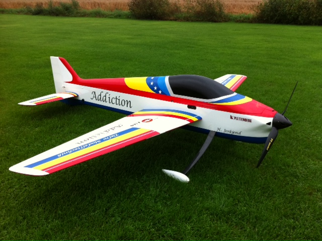

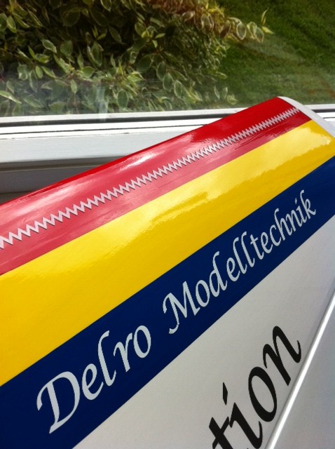

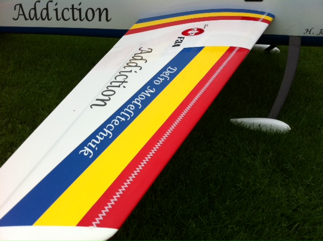

The Addiction by Delro is now my A – model again after the front of my Aries 07 went up in flames at the WC in Muncie this summer. To be honest I have from the first flight of the Addiction felt it was a bit nervous and unpredictable in turbulent air. I have thought about building new wings with a thicker airfoil but that is a lot of work so I thought I would try one thing first and that is to add turbulators to the wing. The turbulator do the same thing as the bumps on the surface of a golf ball. It makes the boundary layer turbulent which makes the air pass over the airfoil and follow the curve without separating. If you have ever flown in rain or realy humid air you probably have felt the wings feels heavier and more stable? The turbulators let you have the same feeling. The turbulators I use are made by Graupner and was bought from Lindinger in Austria. If you have the right tools you can probably make you own. The thickness of mine is 0,4 mm and are applied just like a sticker.
http://shop.lindinger.at/advanced_se...+5LFM+GRAUPNER
Now the Addiction just flies fantastic. Adding turbulators are the cheapest and most effective upgrade I have ever done to a F3A model.
You can see the turbulators as the white corrugated strip at the front of the wing. I have them on both sides of the wing.

The zig-zag tape is applied to improve the flight characteristics of a model aircraft. This turbulent flow is generated. A stall occurs against a laminar flow or not much later. Width ca.9 mm, thickness about 0.4 mm, center distance of about 6 mm, 60 ° angle teeth.

Well, the velcro strip tubulators didn't work for me... I tried them yesterday and noticed that it needs 2 clicks of up trim and the model was less stable in roll axis.
Didn't see any improvements in other areas, so i will definitely remove the turbulators. The velcro i used seems a little too "dense" so maybe it works with a different type of velcro.
