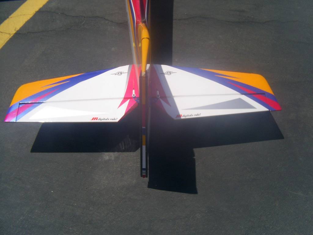

Here are the latest additions I made to the Onas with the Contra Drive installed. They are an added dorsal and some triangular pieces on the TE of the rudder. The net affect is increased yaw stability that the pair of props up front reduce. And a much softer rudder response. The Contra Drive removes the spiral slipstream affect and greatly increases the fuselage lift. Probably somewhat similar to the canalizer. I had reduced my normal mode rudder throw and increased the expo, but I was getting into expo values of 85 to 90% and I just didn't like that feel. The triangles allowed me to increase the throw and reduce the expo. They did change how the model stall turns and it took some changes in settings to get happy with them again. The positive affect was that it just about eliminated any yaw wobble after the stall turn.
BTW, the dorsal is 3/32" balsa cobered in Carbon Ultracote and the triangles are 1/2" x 1/8" balsa covered with the same Ultracote. They are then both taped on.
It sure would be fun to design a new model from the ground up for the Contra Drive!

Tony, I'm having some difficulty trying to understand the need for additional modifications to your Onas as a result of your change to the Contra Drive unit. I was led to believe the Contra Drive would all but eliminate the inherent problems associated with spiral slip stream we all have to contend with on all standard inrunner and outrunner motor installations. Is part of the problem based on the current design (built-in right hand thrust) of most, if not all, 2m pattern planes that are available today? If this is the case than I have second thoughts about making the change. I hesitate because it seems somewhat counter productive if many more changes to my planes are needed as a result of changing out the gearbox on my Neu F3A motors. Perhaps it would be best to have a 2m plane designed to accomodate the Contra Drive unit. I would appreciate your response and encourage Brenner to give his thoughts as it relates to my concerns. Thanks in advance and wish you continued success this year__Everette

Tony,
I would be curious if you added a horizontal fin to the rudder similiar to Heberts Valiant design how it would affect your rudder authorty and change rudder authority.
Chuck

When I talked to Tony a couple months ago he mentioned he felt the Onas needed a bit more vertical fin area, so I'm guessing this might be more of a 'while I'm making changes' sort of thing rather than purely as a result of the contra-drive. By increasing the vertical fin area, he's increased the static yaw stability, requiring more rudder surface deflection for a given response.
Removing spiral slipstream and the resulting required right thrust could theoretically also 'unload' the fuselage making it feel a bit more 'loose' in yaw around neutral. I'm probably not explaining very well what I'm trying to say. The spiral slipstream applies a force moving the tail right. The right thrust counters this force, and the two forces working against each other creates almost an aerodynamic inertial effect making the airplane more resistant to yaw changes around neutral.
Sorry if I'm rambling...

What Doug is saying definitely rings true. A consistent effect of using a Contra drive is increased rudder sensitivity. This is something that I believe I mentioned way back at the start of this thread. What I found was that I was increasing my rudder exponential up to 85% plus in order to soften the rudder around neutral. Also, when I released the rudder, I had to release it slowly or the tail of the plane would swing past center before settling back in line.
What we have found is that increasing the width of the rudder trailing edge dampens these effects, and pulls the tail of the plane back into line. It's kinda like putting a tail on a kite. What I did with my Integral is put two 1/2" triangular strips on the trailing edge of the rudder. This resulted in a softening of rudder sensitivity, and a "dampening" of any yaw oscillation when I released the rudder. This made the rudder much more precise around neutral. Now I can input very subtle rudder inputs, which are very difficult to see from the ground because there's no oscillation. When I fly I'm constantly working the rudder, but the plane still looks like it's tracking straight as an arrow.
The end result is a plane that is an absolute dream to fly because its trim doesn't change with airspeed. It carves like a knife, and tracks like an arrow across the top of Humpty Bumps, and at the end of long verticals. One very beneficial effect is the way it tracks on a vertical line. It can put vertical point rolls on a string, and then continue on a perfectly straight track after the rolls. Also, these same effects make it much easier to do perfect stall turns, because the wings don't twist out of plane as the plane pivots.

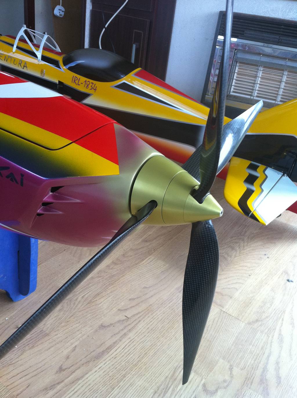

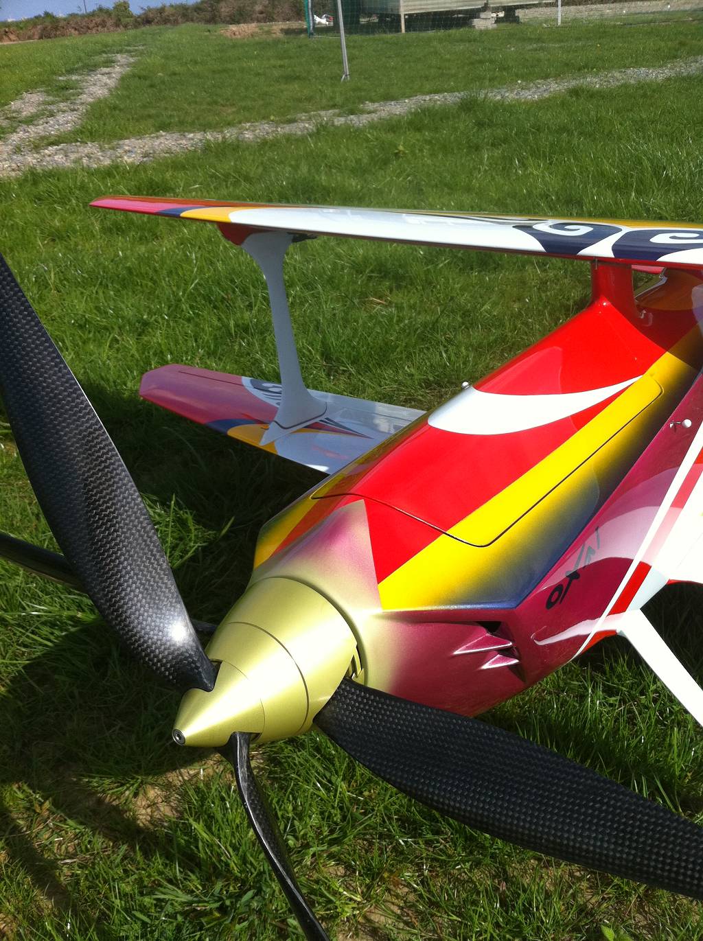

Hello,
Finally got the Contra fitted to new Amethyst for WC in Muncie.
I have attached some pics, showing the setup used ( Amethyst Mod-YGE 90-Neu f3a-Thunderpower 25C 5000s and 4400s- 22x20back 22x18front )
Had 6 trimming flights Friday. and the power is fantastic, much more vertical performance then similiar setup on Amethyst with Hacker 13xl last year.
I had 4 flights on this model last month with Hacker 13xl before I fitted contra, waste of effort! Completely needed to start from scratch with trimming, throws were dramatically reduced.
Far less rudder needed, less right aileron needed, NO mixes needed ( may need a touch in downline but wasnt calm enough to be sure )
As previous posts show it definetely makes surfaces more sensitive, nothing that cannot be tamed with expo and reduced rates, will just take some stick time to adapt.
Sounds fantastic in my oppinion,more pleasing to my ear then previous contras I have heard, well within sound check barrier.
Had 3 x p09 flights and uses similiar or less current draw then 13xl mono prop.
Weight penalty is negligible, I reckon about 85g net increase from my mono setup, easily absorbed in modern airframes.
Overall a fantastic combination and for sure is a step forward from anything I have previously flown.
Rgds
John Martin.
PS The first pics show the mounting system Brian Carolan has come up with , the 3 bolts on triangle mount can be openned and the complete unit ( inc. motor ) can come out through front, in about 30 seconds, very wel thought out.

Hey John,
That has to be one of the cleanest installations that I have ever seen. The finished plane with Contra installation is absolutely beautiful. I am really looking forward to seeing it fly at the Worlds in Muncie.
