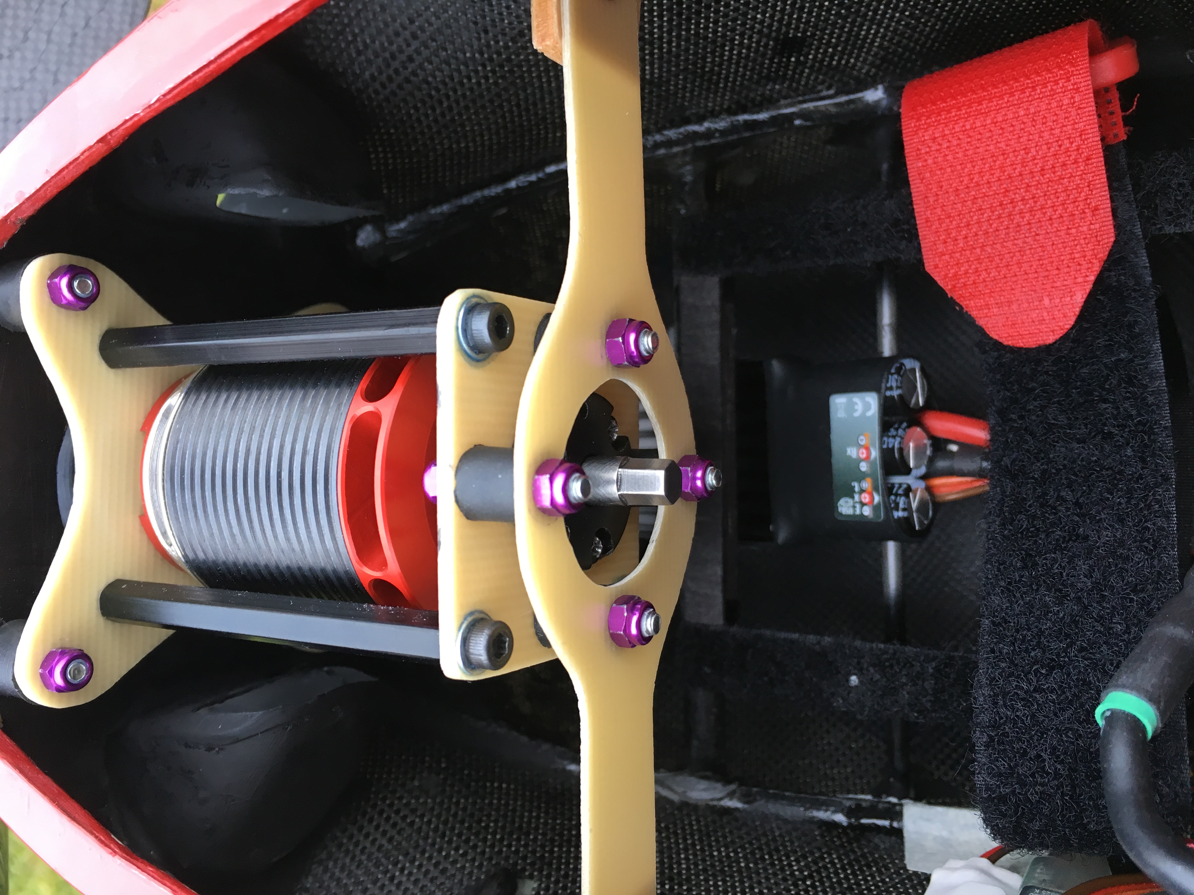

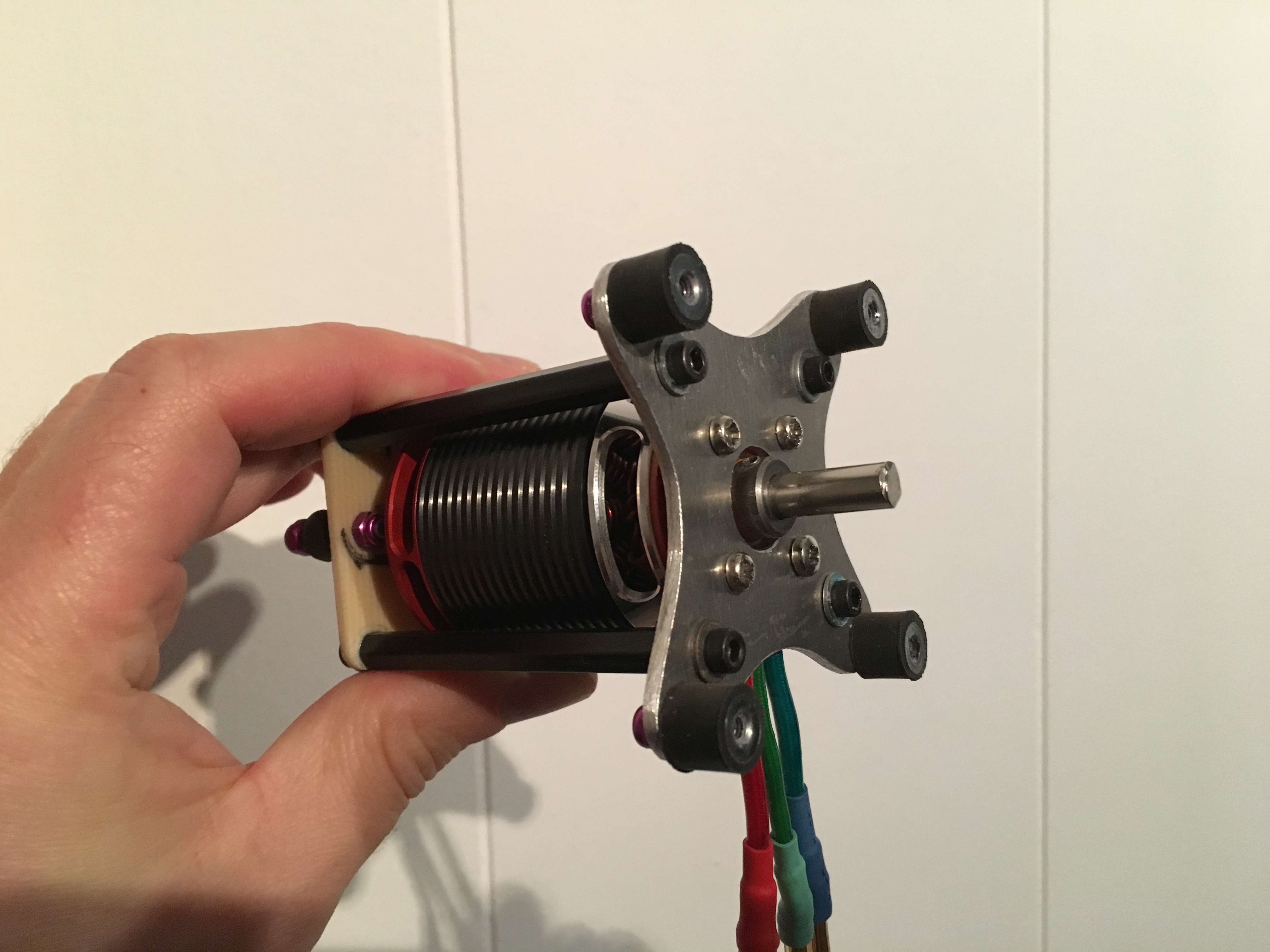

I flew my Naruke Ascent for the first time this weekend with the Brenner V4 drive. This is the the third motor set-up in this model. First Pletty Advance and then the OS belt drive. Both works well but the Contra took the model to another level flying the F17 schedule. The constant speed and the breaking just makes the manoeuvres look less stressed. I got more time to prepare for the next manoeuvre. The torque and power of the Pyro 600 with Mejzlik 22x20F and 22x22R are very good.
After gaining some knowledge with rubber damping the OS belt drive I decided to design my own motor mount for the Contra drive. One of the main motivation for designing my own was due to the issues that has been reported with the rear support bearing and twisting in knife edge manoeuvres in the F17 schedule. My mount eliminates that problem. The pictures explains it better than me.
The firewall is of wood and is a laminate of 0,8mm plywood on both sides with 2mm balsa in the middel. It is lamented with epoxy and heated to 60+ degrees C during curing for extra strength. The front dampers are D10 by H8 mm 60 shore and the rear are D8 by H8 mm 55 shore. I am using fiberglass instead of carbon as it dampens vibrations better. The 4 spacers which makes the whole difference to this month are of aluminium with M3 threads inside and are from a camera drone supplier.
The sound level from this set up is really low in the air and it is the noise from the propellers that can be heard and not the gears.
It is one concern that i have and that is the play in the rear support roller bearing. Is it by design that it is so loose? Will I run into any issues if i replace the bearing with one that fits the motor axel?

You should have no problem replacing the rear needle bearing with a more traditional bearing. The motor rotor shaft is through hardened to 62RC, so there will be no fretting issues between the shaft and the inner race of a bearing. We are testing a bearing like this right now.

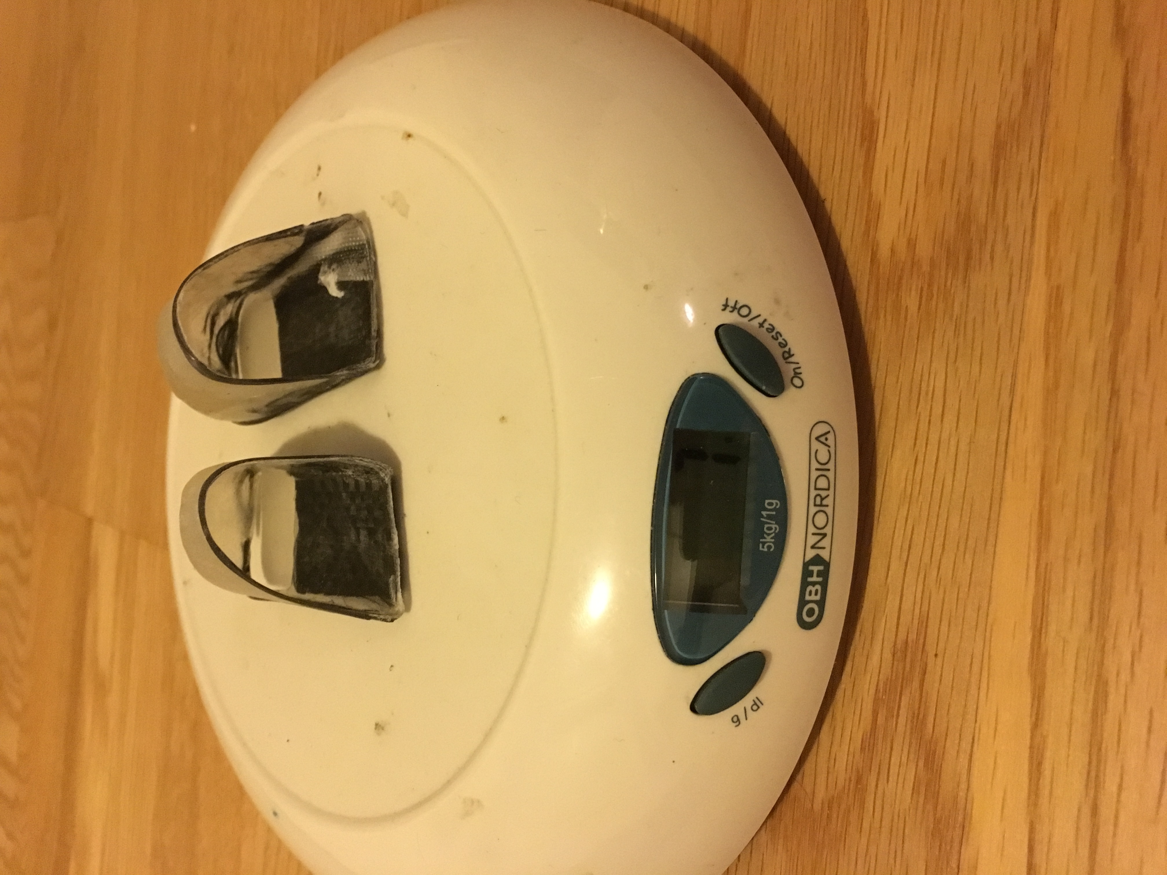

I doble posted. the #1700 includes the pictures. It adds 70 grams to the motor + the firewall.
Including 8 rubber dampers, 3 fiber glass plates, the supporting rear bearing with plastic mount the 4 alu standoffs, bolts and alu nuts.

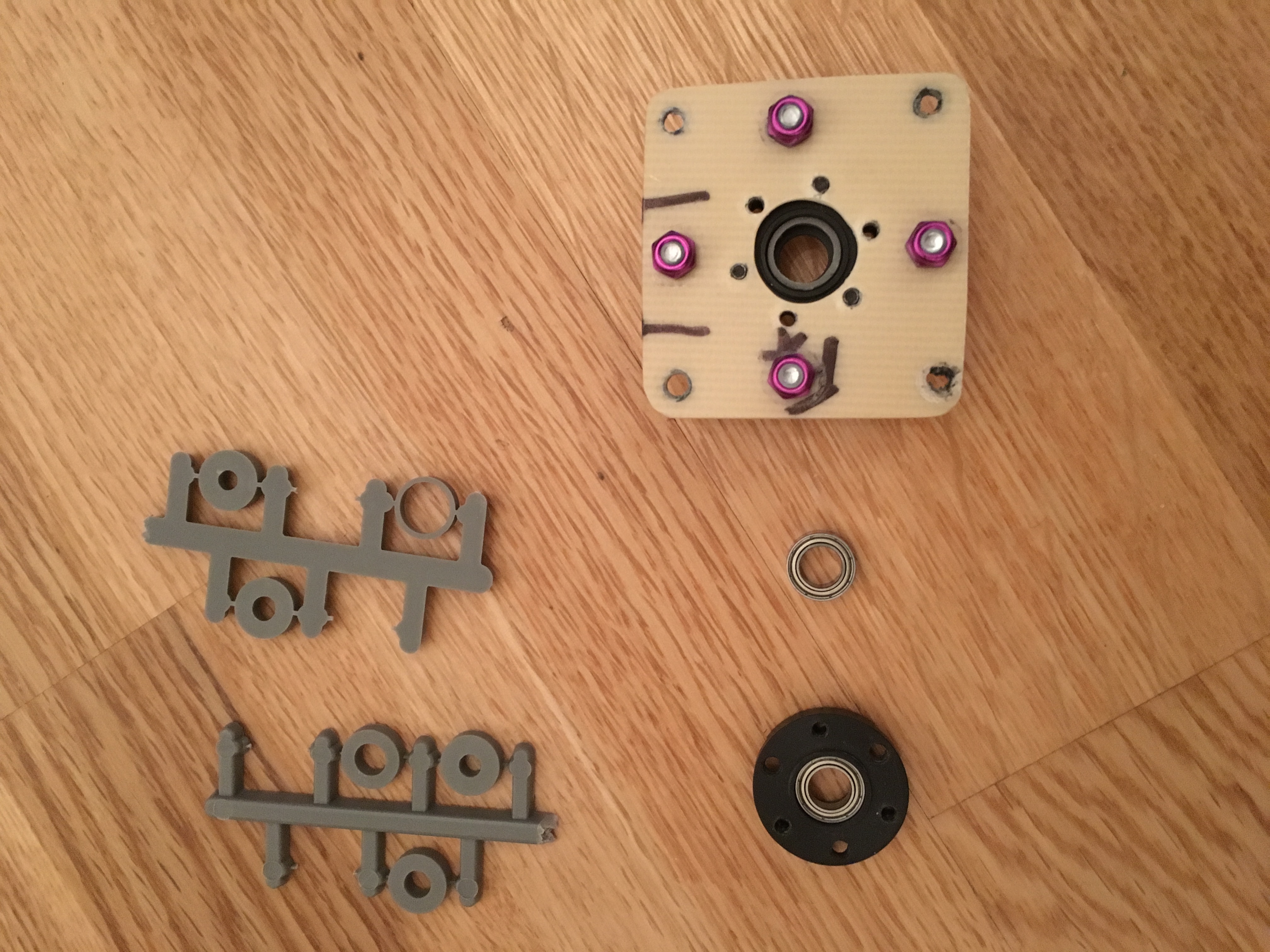

I changed the needle back support bearing to two high quality 6x10x3 mm ball bearings + a spacer to fill the gap in the plastic case. The spacer I used is a centre ring from an APC propeller. The spacer is 9.5D x2.5 mm and with one round of plastic tape it fits perfectly. The fibre glass plate I am using is 2 mm so this adds up to a perfect fit. After installation i have zero play in the back support.
Test flight hopefully tomorrow.

I flew 1 round P17 and 6 F17 today. The change from the supplied sloppy needle bearing to two tight ball bearings had two positive effects. The plane rolls more axial and the noise level is reduced.

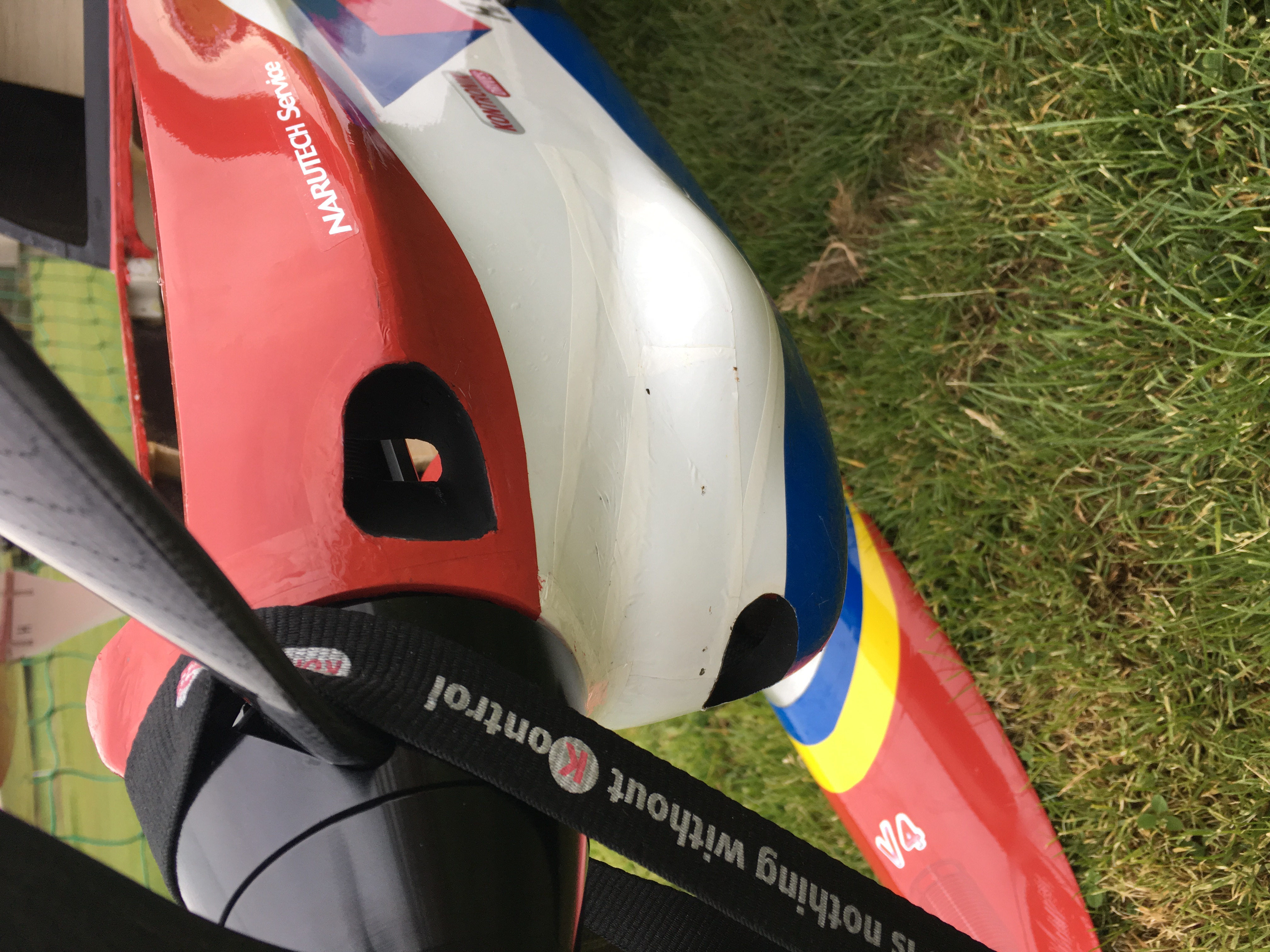

The next to try is mould some air inlets that directs the air to the front of the motor where it is at its hottest. I will also cut a new front mounting plate in aluminium to replace the current one I cut in fibre glass. The aluminium plate will act as a heat sink for the motor.

I created two plugs of foam and covered them with Oracover. The plugs where then coated with wax before adding fibre glass and carbon fibre. The foam and the Oracover where pealed out after curing. Without any trimming and sanding the air ducts came out at 3-4 grams each.

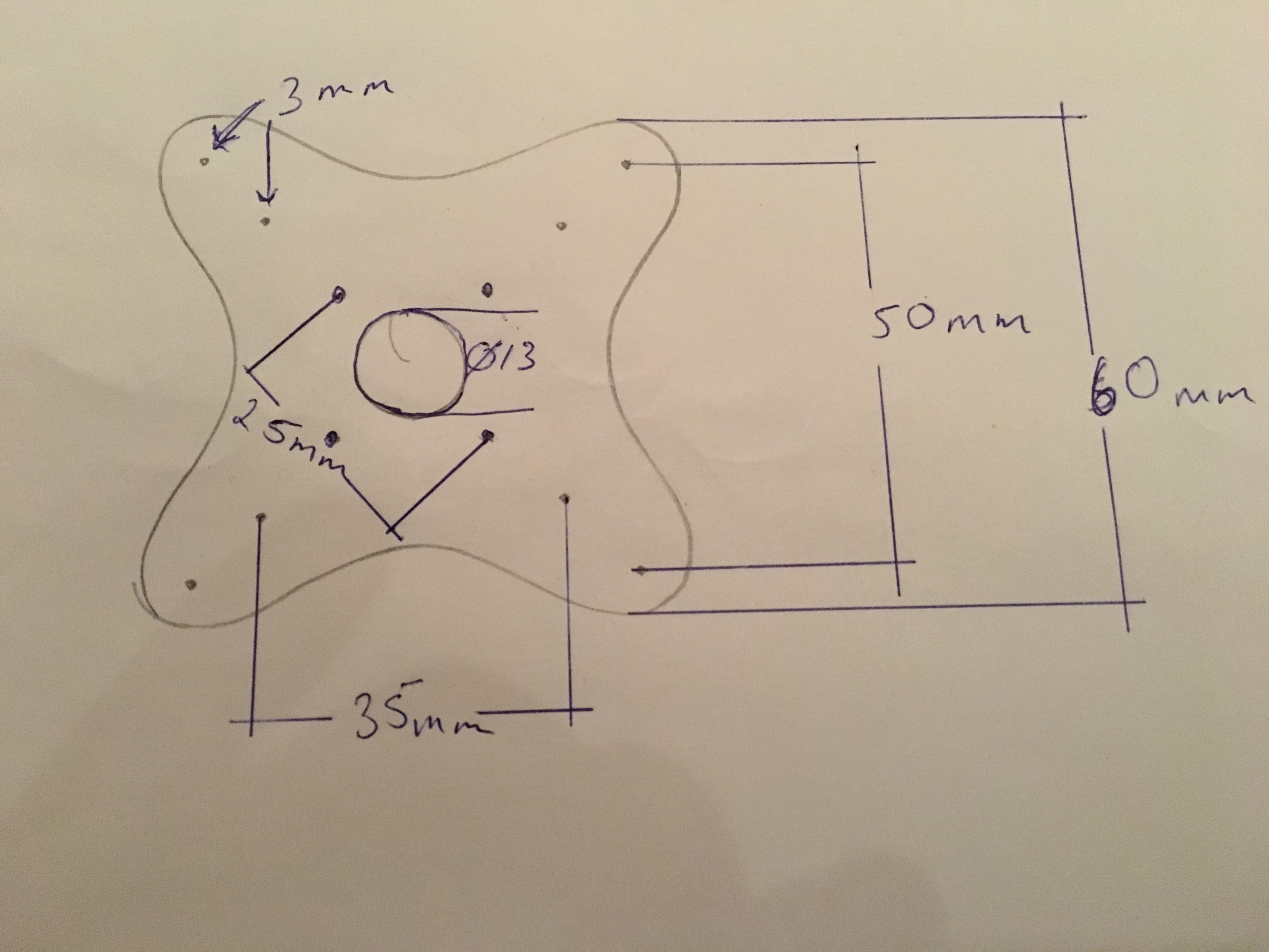

My last update to the motor mount has been to cut a front mounting plate out of aluminium to replace the old one made of fiber glass. The plate added 4 grams over the old one but with the increased cooling it should be worth it. The plate is cut from 2mm thick 5xxx alu alloy. 1.5 mm is probably strong enough but 2 mm was what I had laying around. I will add some Thermal paste used for computers between the motor and the alu plate to optimise heat transfer.
I donīt holt an Auto Cad licence any more so my hand drawing will have to do if some one would like to copy it.

Hey Henning,
Your plate and mount looks good.
We are going to build this mount and test it as well. According to my calculations it will probably add about 30g to the system if we use aluminum rods, but even with this added weight the complete system will still be extremely light.
We are are going to try three rods instead of four so that can reuse the motor mount bolts to hold the rods. We will combine this with a ball bearing rear support, and reuse the EAR Specialties grommets, except that we will replace the plastic spacers in the grommets with aluminum spacers.
This should result in a system that keeps the rear support bearing in perfect alignment with the motor, and provides a firm, but fully isolated mount.
Brenner ...
Brenner ...
