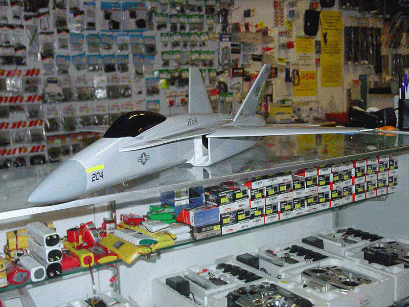

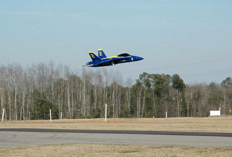

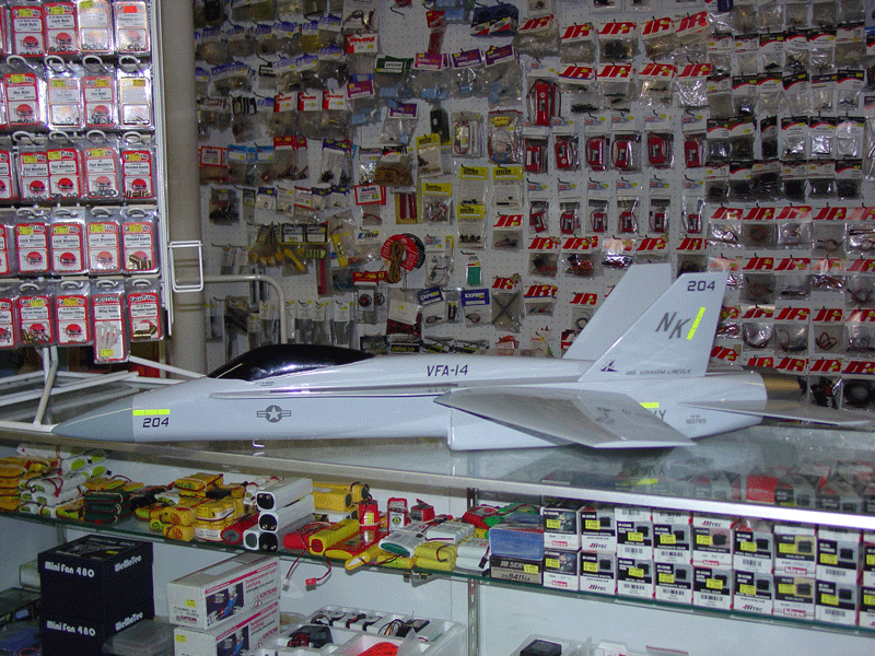

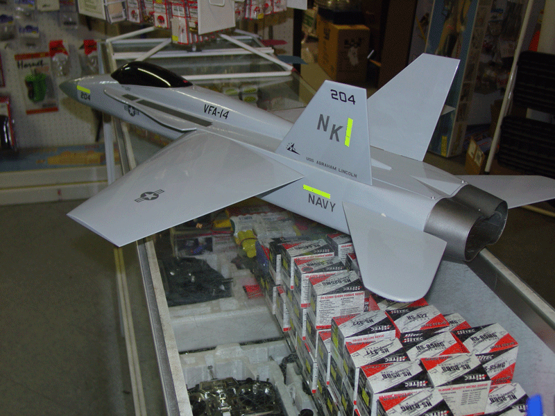

Thought you guys might like to see my newly completed HET F-18.
Power is a Kontronik 480-42, Castle 60 AMP , and a Kokam 3200 3S.
This plane is a pleasure to build and makes for a nice looking Hornet. The price is certainly right!
I just finished it and haven't flown it yet. I will post a report soon.
Now if HET would just make an F-5 ARF, I would be happy

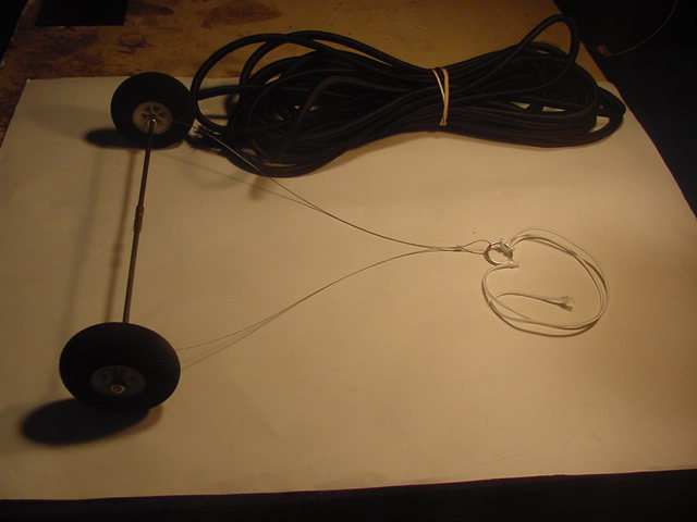

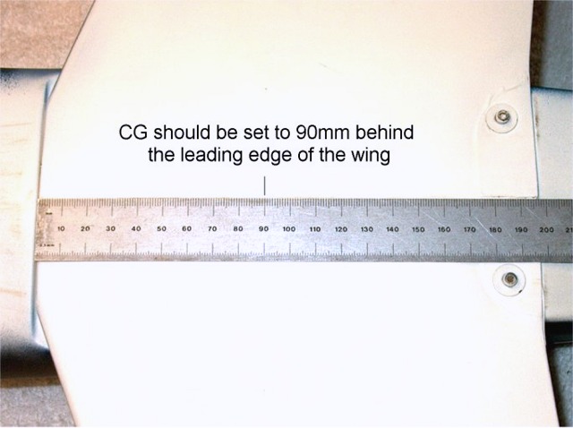

Not sure where you got yours from we supply a CD manual that Carl T. did for us that shows the throws. But they are the following:
Elev:
High Rates: UP 8mm / DOWN 6mm
Low Rates: UP 5.5mm / DOWN 4mm
Ail:
High Rates: LEFT/RIGHT 8mm / DOWN 6mm
Low Rates: LEFT/RIGHT 6mm / DOWN 4mm
CG:
point is 90mm from the base of the leading edge of the wing.
Only lipo packs we <personally> have run is the Kokam 1500 x 3
Bungee launch or a dolly setup like the picture shows. Like Carl says I too only know of a few people who tried HL. I would not even attempt it myself <I like my Sniper>
