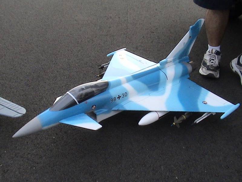

Tarro - looking sweet! IMO a bit of gunmetal on the exhaust tips would set it off a treat, but looks great as is. I'm thinking of trying to emulate this pantjob, might be a bit difficult to get a good result without an airbrush though. Still, can but try!

Thanks Rusty, it's my first time airbrushing and it was not as difficult as I thought it would be. Where did you get that picture, I thought I was being original. Do you have anymore and did he use Gloss paint on that Typhoon?

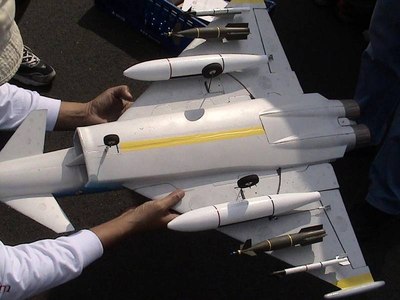

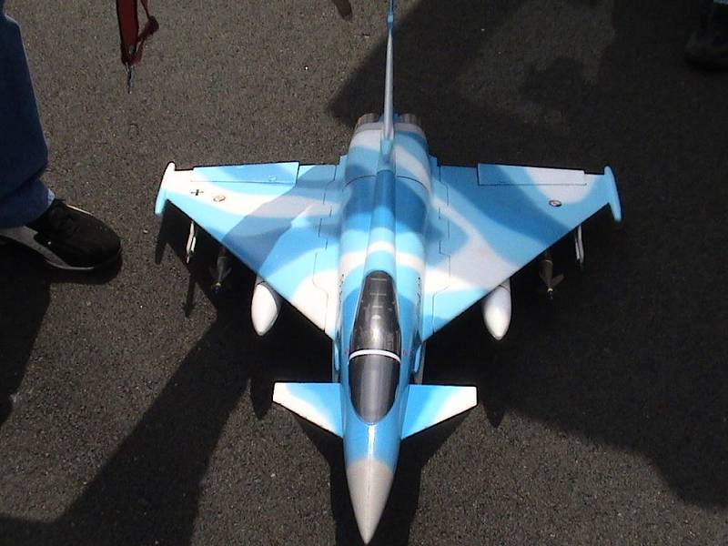

It was over on rcgroups, think it belonged to a friend of the poster... no details on what paint was used alas, but looks like some sort of gloss.
I might have to buy myself an airbrush... just a cheapo one.
here are the other pics, and a video:
[link=http://uk.youtube.com/watch?v=aTP8p60na_E&eurl=http://www.rcgroups.com/forums/showthread.php?t=786255&page=14&highlight=sapac+ty phoon]Youtube Video[/link] (very windy morning apparantly)
Lovely looking bird... once I've made sure It's not going to become a lawn dart straight away i'll be aiming to do a similar job!
