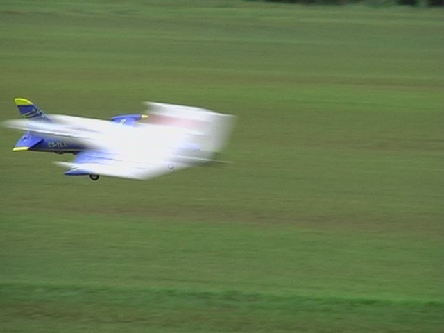

Back to my Funjet to get it ready for tomorrow now I've conquered my Yak project. Going to push the motor a little harder. Using a 4.7 x 4.7 APCe last but have got a 5 x 5.5 APCe (cut down from a 6 and balanced). Got these numbers. Think I may get a motor for 6S next... 16/25/2
17.34 Volts
43.2 Amps
0749 Watts
? RPM (Tomorrow - bad light at mo)
17.34 Volts
43.2 Amps
0749 Watts
#138
ORIGINAL: ditchit
17.34 Volts
43.2 Amps
0749 Watts
52,375 RPM (Tomorrow - bad light at mo)
17.34 Volts
43.2 Amps
0749 Watts

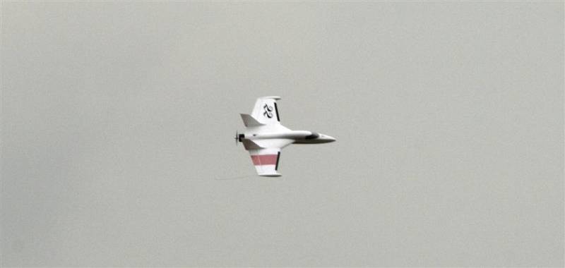

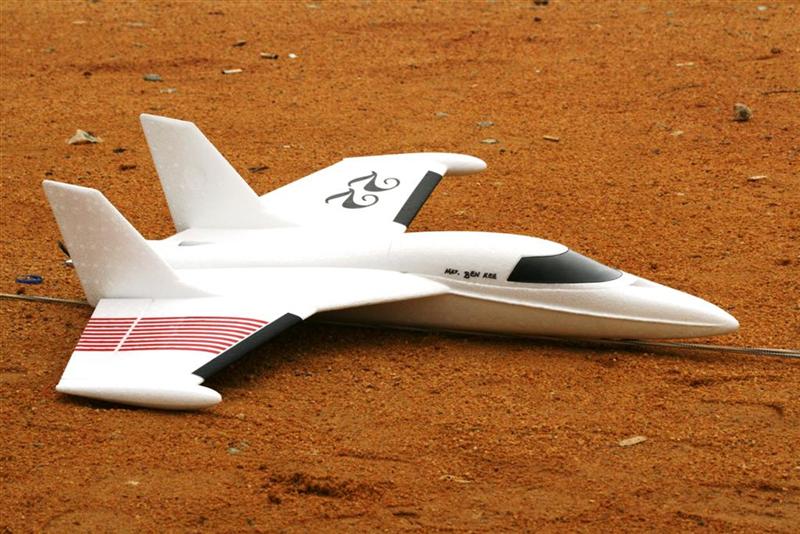

#140
Ditchit ... hey I was just joking about the numbers!!! I just thought of something absurd and put it in ... those are not real figures, heheheehehee
Hey enjoy the pics below ok ... tell me what you guys think ...
Both planes are about the same size, talk a close shave ...
#141
LOL...that just shows how much I know about power setups.
Nice pic...intentional or was someone being naughty and crossing the strip the wrong way. Let me guess who that was [)]

Finally took some video of my Funjet today. A handful of fast passes in this vid but the last is the fastest I think. I'll hunt around for some doppler software unless someone could help me out and analyse it.
http://www.youtube.com/watch?v=yrnkDnlzl8s

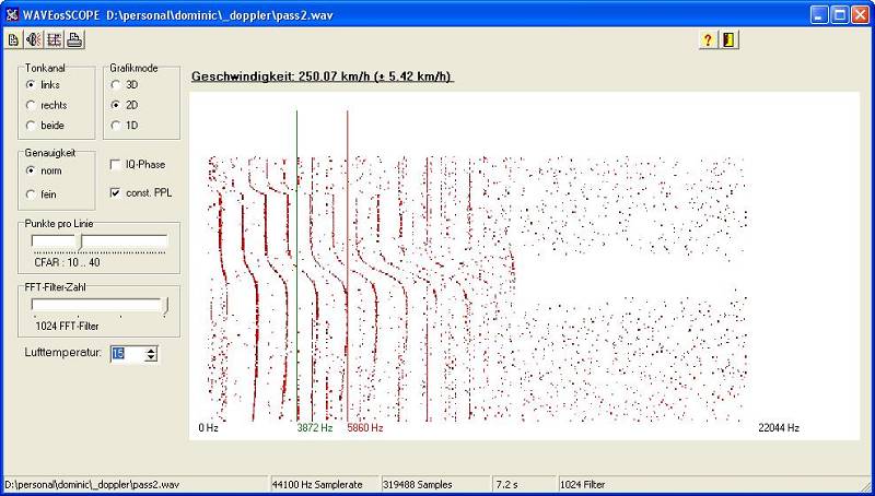

Thanks Tianci. Was a lot of fun yesterday. I got referred to some doppler software (WaveOsScope) and I may have done it wrong but I got 250.07km/h which is 155.4mph.
Link to WAV file below if anyone else would be kind enough to analyse and tell me how wildly off I am.
http://claregrace.brinkster.net/rc/pass2.wav
EDIT: Chap on RCG reckons it was more 105mph. [
] Never mind.
] Never mind.
