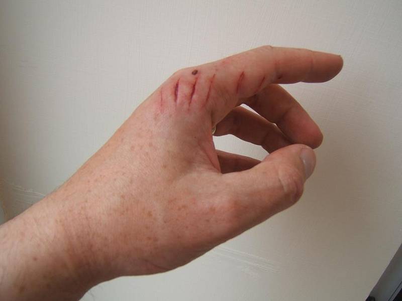

I got a little complacent today. First time that I have tried to launch my Funjet by myself and I made the mistake of running half throttle on left hand release from the bungee. I should have release from the bungee with no throttle and opened it up after release.
The APCe prop put 6 nice scalpel like cuts in the side of my hand and I was dripping red coolant in a matter of seconds. I was by myself at the time but fortunatley one of my fellow club members arrived literally 2 minutes later and patched me up with a first aid kit.
I'm normally very careful. Flying 12S powered models swinging a 20" prop I know one false move could hack off a limb so I always keep my finger firmly on the throttle stick. Easy to forget that even small models can cause a lot of damage. Another lesson learnt for me.
Important to enjoy flying but more important to fly safe my friends.

Oh man oh man oh man!!! Its good the cuts were not too deep. Look on the bright side now, with the scars you can tell them birds at the pub that you got it when you smashed your hand through a windscreen to protect yourself from 5 YOBs!!!

OUCH !!!
Prop rash !!! Be care-I know to late now.

Please be careful guys as it hurts to get a screaming prop across the hand.

I believe you will agree that paying attention is the most important thing and will help being safe a lot more than any assisted launch device.
I launch 37-45 o.z. 1100W-1800W Stryker while at full throttle by myself. The key is paying attention.
Just before each single launch I go through the steps in my mind. I do not rush.

How bad were your cuts?
Because of my mistake, I hurt my brother’s hand over 2 years ago and I still have not forgiven myself. It was not so serious but it could have turned out that way. I would have rather done it to my own hand than to his. So just before each lunch I really do go through the motions in my head and I do imagine that the prop is trying to hurt me. I then launch in a way that it can’t even if it tried.
I launch at maybe 30 degrees above the horizon as if I’m throwing a Javelin for maximum distance and the key is that I follow the motion through to get my hand out of the way (away and down).
Since I do that while at full throttle and with up elevator trim, heavy birds have no problem going right up, and that buys me enough time to get my hand back on the transmitter.

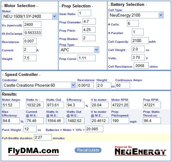

Gryphon ... my cuts were not that bad, maybe a teaspoon full of blood? Hehehehee ... first 2 launched on the Hawk were good as I launched it with my hand pulling away on a downward arch, the 3rd launch I was excited and I launched her in the 'normal' way ... The FJ is really easy to launch ... I get my pals to do it for me and usually I am on about half throttle. The Stryker at 2KW is nuts ... totally nuts, but its an inspiration for me to go with a 6S FJ set up ...
Neu motor ... Flight Power EVO30 3S 2,000 x2 ... we should be seeing about 43K RPM right on a 4.75 x 4.75? Hehehehee ... let her scream! On the other hand I still have my Zagi TAZZ ...
Dig the ECalc ... me likes ... me liking very much ...

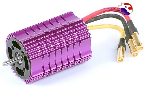

I'm fairly sure that you didn't notice that is a 7.5 o.z. motor. [)] .............................and $205
You can have 30%-60% more power than your chart from 3.9 o.z. MEGA 16/25/X $95 or NEU 1110 series $125 and they are 28mm unlike the 36mm diameter beast you found in ez-calc. (The 2Y wind version of your motor above is what was in that Stryker with CC 125A ESC)
Trust me, at very high speed you are better off with 5" to 5.5" prop (forget 5" for ULTRA speed). You can control prop size with your KV selection to get same watts from larger diameter prop.
You can swing a 7" prop if you want, but with 8" pitch, so RPM is not everything. Pitch speed is attainable in other ways with regard to thrust needed.

Comparison of $95 MEGA 16/25/3 and 16/25/2.
16/25/3 can take about 50% more voltage (more cells) while the 16/25/2 can take about 50% more amps (larger cells).
16/25/3 60A is O.K.
16/25/2 90A is O.K.
Power increases as you go down the list:
16/25/3 3S 8X8
16/25/3 4S 7X7, 7X8
16/25/2 3S 7X7 90A 138 MPH prop pitch speed. (147 pitch speed with 7X8 not recommended)
16/25/3 5S
16/25/3 6S & {16/25/2 4S APC 4.7X4.25 35,000RPM 46/47A on 4S-3850 25C}
16/25/3 7S
16/25/2 5S APC 5X5 37980 RPM, 180MPH prop pitch speed, 81.5A (not maxed out yet), TP 5S-3300 25C(barely under sized).
So it can clearly be seen that without going to High voltage ESC and 8S the 16/25/2 is a superior motor for Funjet as compared to 16/25/3.
16/25/3 9S & 16/25/2 6S Will be running props that are too small in diameter for good performance.
So max performance is somewhere between 16/25/2 on 5S and 16/25/3 8S. It is better to error on side of caution by running a bigger prop to make sure that a drag wall is not reached as far as thrust from prop compared to drag of airframe at ultra high speed.
Maybe 16/25/2 2650KV on 5S and APC E 5.25X4.75 for all around fun, acceleration, climbing and speed (when very high speeds are intended). CC80A ESC with 120A burst will work.
